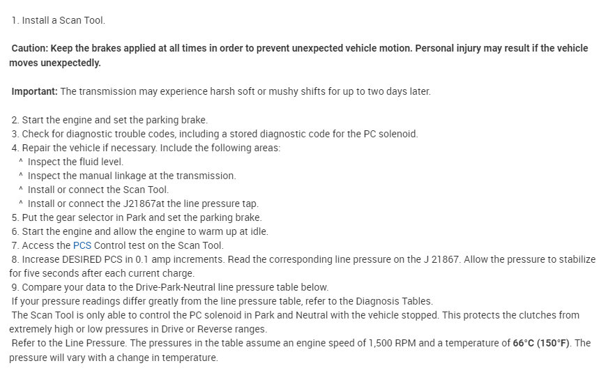

Transmission doesn't want shift to third gear/OD most of the time but works sometimes. Other times it doesn't want to take off properly from 1st to 2nd, will just tach up and not pick up speed like it should.

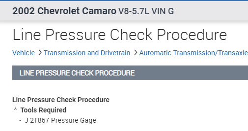

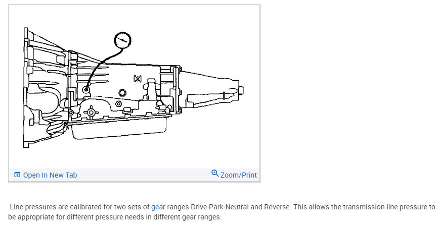

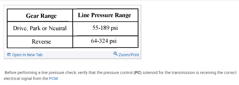

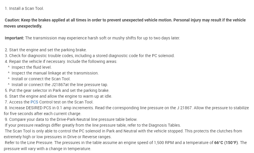

The best thing to do at this point would be to check transmission line pressure. If something is restricting it, that can cause it to slip. Keep in mind, the transmission clutches may be worn as well.
If you look below, I attached the directions for testing line pressure. This would be where I would start. If you perform this, make sure you have a gauge that can reach the possible pressures that will be supplied.
