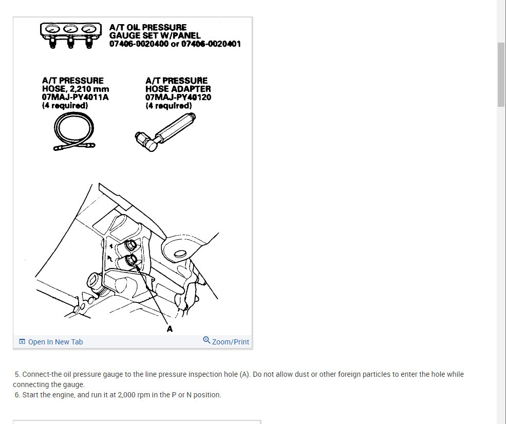

Replaced transmission shifting solenoid and the second and third gear release sensor and vehicle still will not move?
2005 HONDA CRV
104,386 MILES • 5 CYL • 2WD • AUTOMATIC
KENNEDY HAYES

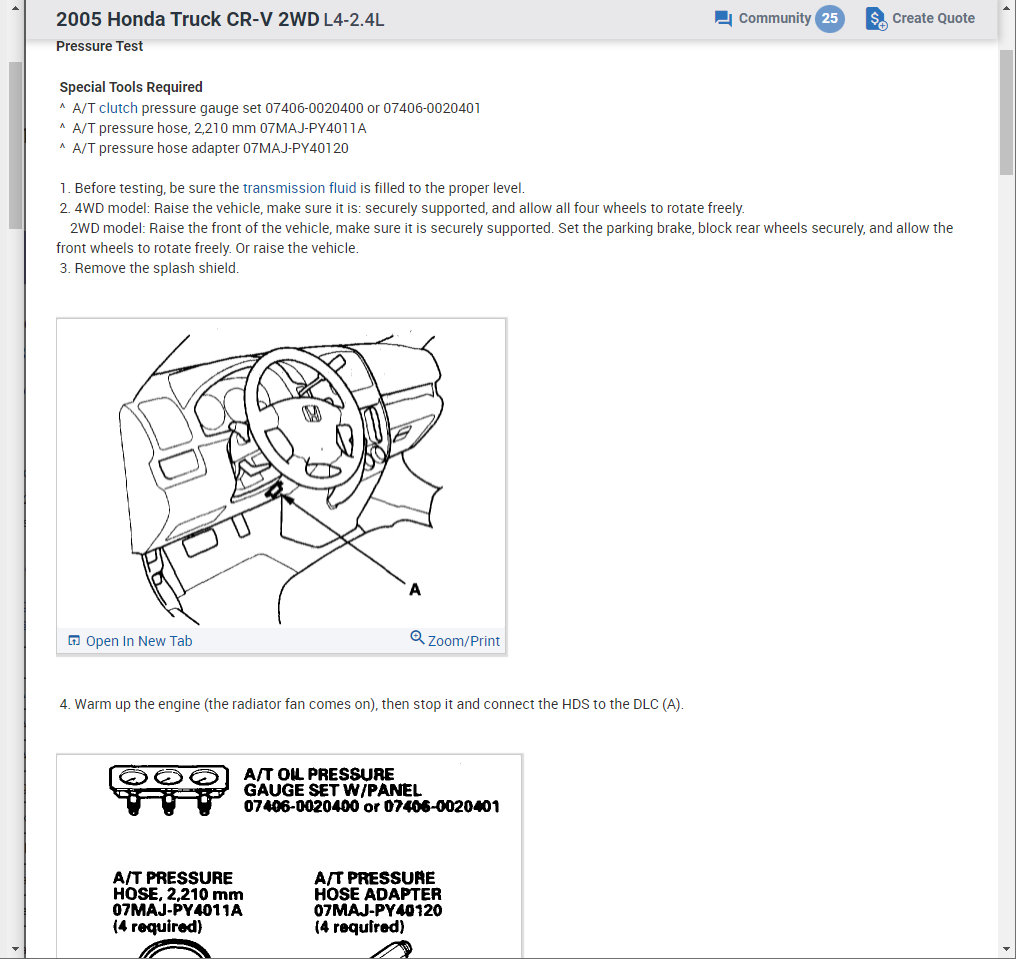

The vehicle was not moving. I changed the shifting solenoid and the 2nd and 3rd gear release sensor. it worked for one day and stopped again. it's not moving forward or backward. Please help.
Sep 19, 2021 at 8:33 AM

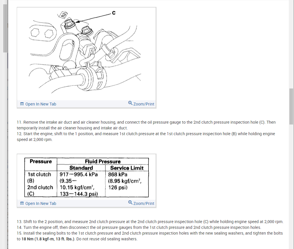

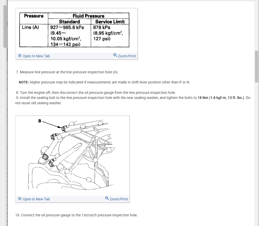

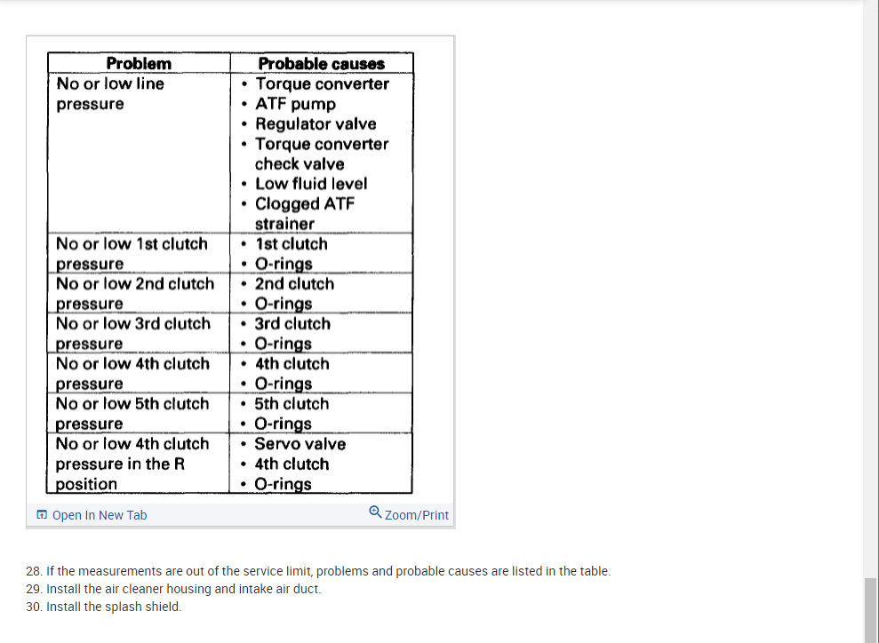

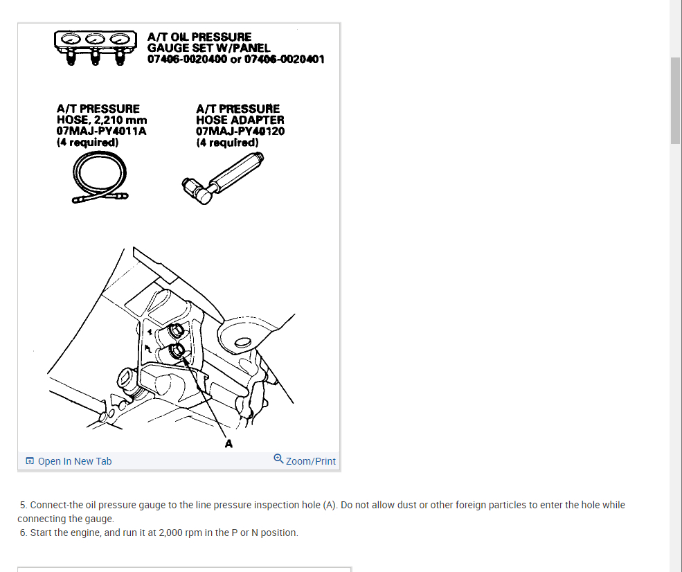

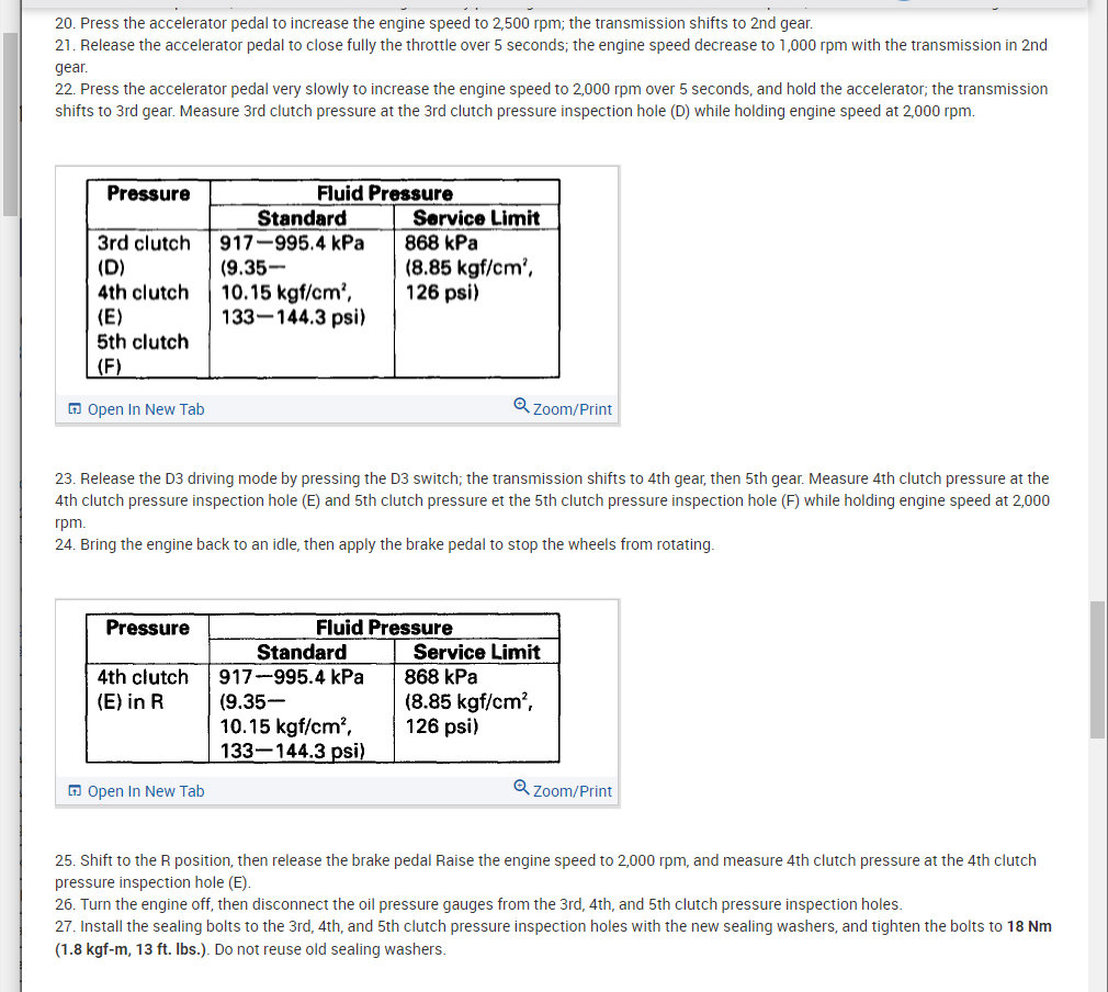

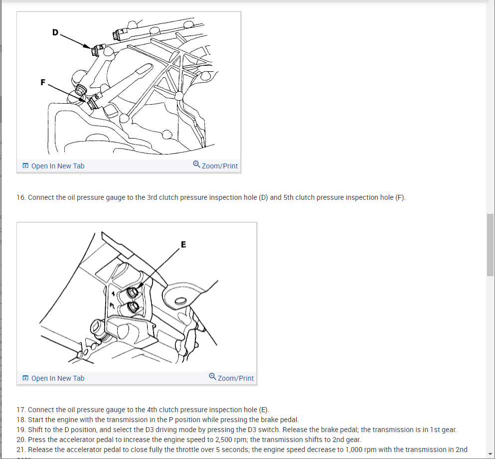

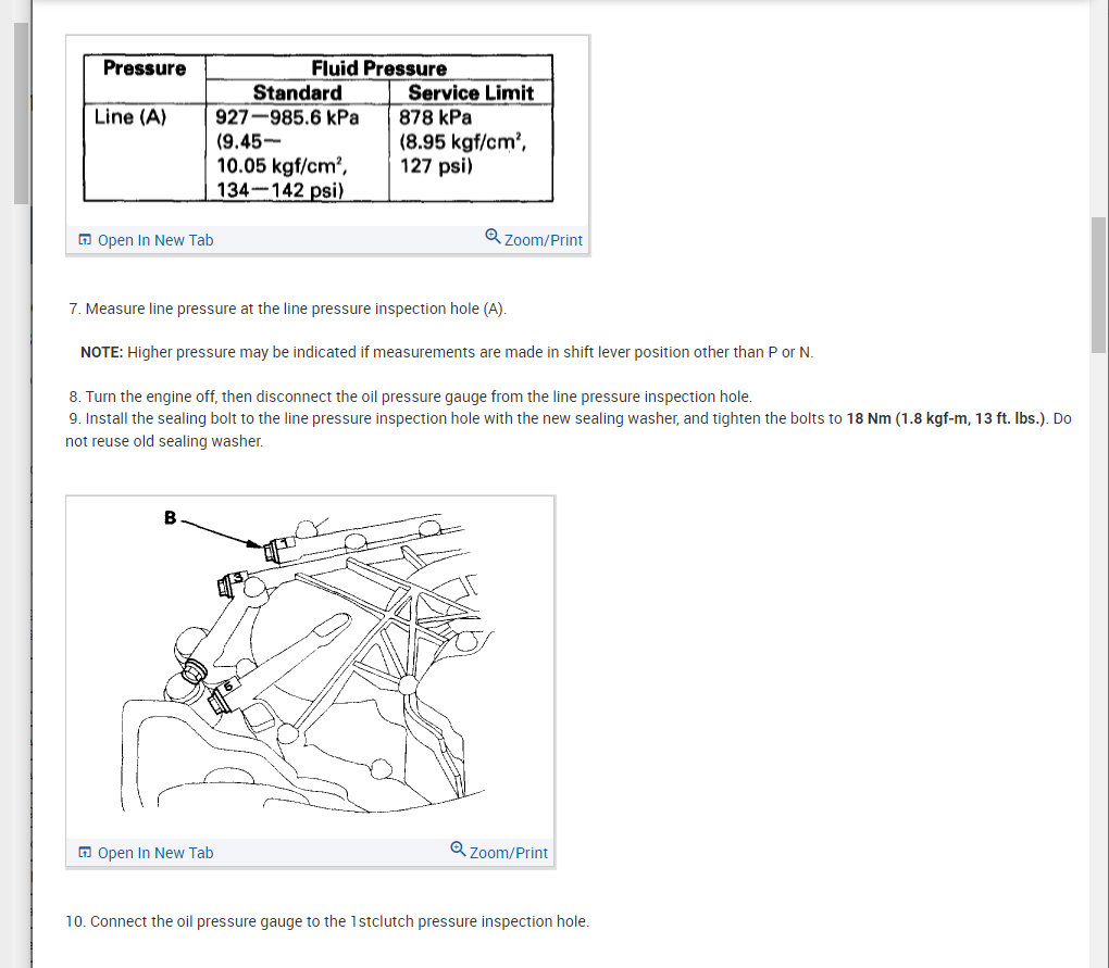

More than likely we have a pressure issue. So we need to start with checking the fluid and servicing it if it is low or not in good condition.
However, I suspect you already did this if you changed the solenoid so if the fluid is correct and it still does not move then we need to check and find out what the pressure is from the pump.
Either we have a converter issue or pump issue but fluid issues can also cause this which is why we need to start there.
Please see the info below from the manual on how to check the pressure and let me know what questions you have. Please look at the last page as well for causes of this and I suspect we are going to have an issue with the No or Low pressure section. Thanks
