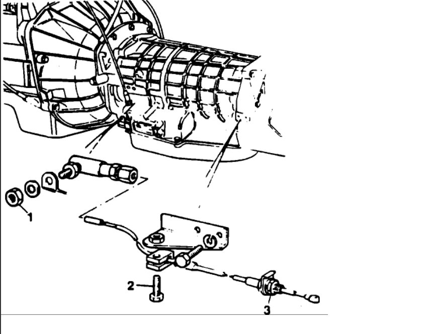

I was in neutral making a turn because the car have been cutting off sometime when stopping or when making a turn. that's why I had it in neutral so I could keep one foot on the gas so it would stay alive by pressing the gas to keep the motor revved up. So I made the turn and put the car back in drive and when I did something underneath the car jerked or bumped hard and that was it the car would not go forward. I had to drive in reverse back home then I got under the car to see what was the problem and I noticed that the rear mount on the transmission was broken. I replace the mount and still the car won't take any forward gears. so what should I do next? do you think the transmission is gone? what I really don't know and would appreciate it if you could give me some advice about it.

If you heard a noise, it does sound like something mechanical was damaged. By accident, did you shift to reverse? Next, when you place it in drive, and rev the engine, does anything happen? For example, do you hear the engine RPM change? Does the speedometer move? Does the gear indicator show the drive position? Can you place it in low 1 and have a response?
Next, is the check engine light staying on when the engine is running? If it is, you really should have the computer scanned to see if there are diagnostic trouble codes which could indicate where a problem starting. If at all possible, the can bus system shows be scanned to identify any module problems in the entire vehicle. CAN stands for computer area network. All of the modules are connected together. This is the best think to do because it shows all faults.

Any one know why my 89 xj6 has no reverse it dent matter where I put thevshifter on the J type shiftier its all forward yes its a automatic.please help my brothers.I noticed it has a trans relay undervglove box could it be that
Mar 10, 2021 at 11:05 AM (Merged)
  • 55,423 POSTS
It sounds like you have shift cable or mount on the transmission that has become loose. You must start by lifting the car Here is a guide so you can do that safely.

Well I got it to go into reverse but not drive slips I readjust linkage it was off bubbled check it so is the drive belts bad now or can they be righted on a jag tranny
  • 55,423 POSTS
I don't believe the bands can be tightened it sounds like you need a rebuild
