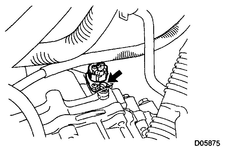

Also, make sure the transmission position switch (range sensor) is still properly connected and not damaged. I attached a pic of it.

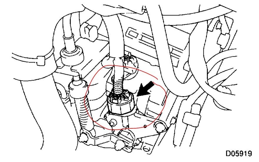

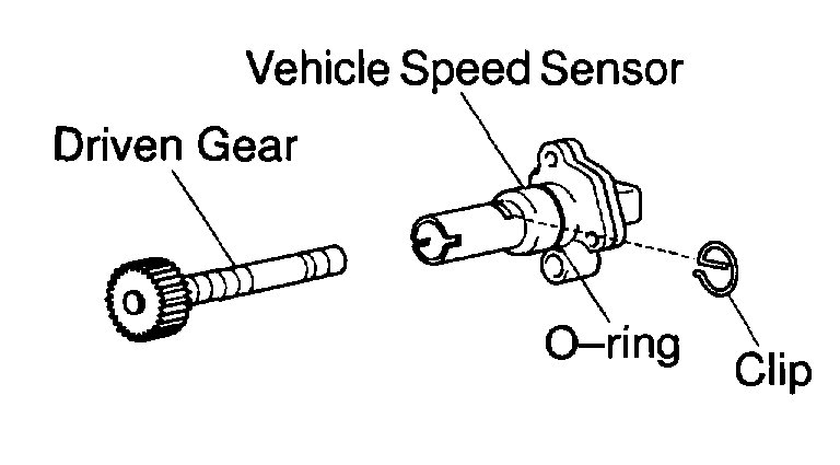

A speed sensor can cause shifting problems. The location of the sensor is on the bell housing near where it mounts to the engine. It is easy to damage a wire, pinch a wire or even partially disconnect the connector.
Do me a favor. Check to see if any of the aforementioned conditions exist. Here are the directions for replacing the sensor. At least these directions will get you to the right part so you can check. The attached pics correlate with the directions.
I have to be honest, I'm not sure how it could have caused the vehicle to go to reverse. However, since the code exists, something has happened, so lets start there.

pic 1
4. DISCONNECT VEHICLE SPEED SENSOR CONNECTOR
5. REMOVE VEHICLE SPEED SENSOR ASSEMBLY
a) Remove the bolt and vehicle speed sensor assembly.
B) Remove the clip and speedometer driven gear from the vehicle speed sensor.
C) Remove the O-ring from the vehicle speed sensor.
Pic 2
6. INSTALL VEHICLE SPEED SENSOR ASSEMBLY
a) Coat a new O-ring with ATF and install it to the vehicle speed sensor.
B) Install the speedometer driven gear to the vehicle speed sensor with clip.
C) Install the vehicle speed sensor assembly with the bolt.
Torque: 5.5 Nm (56 kgf-cm, 49 inch lbs.)

Speed sensor looks good. Gear shows no wear to speak of. Wiring looks good as well.

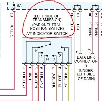

Confirm that the neutral / park switch (AKA transmission indicator switch isn't damaged, not properly connected, and there are no wiring issues. I attached a pic of the switch I'm referring to.
Let me know. It has to be something electrical if there wasn't an issue prior.

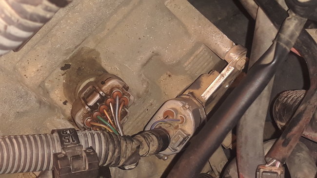

Here is pic of switch I checked out. Hope it is was the correct one. No wiring damage I can see. The connection was on tight. The switch
Does not have a damage and appears to work correctly.
Tuesday, September 24th, 2019 AT 4:21 AM
  • 109,885 POSTS
Does the gear indicator react properly? In other words, does it indicate the correct gear all the time?
