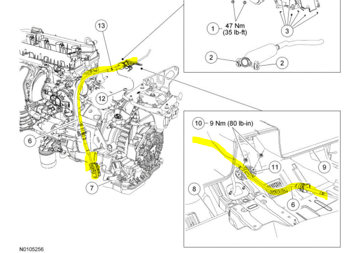

Last, if you are unable to shift into other gears, confirm the shift cable is not damaged or out of adjustment. I attached a pic below of how the shift cable runs from in the vehicle to the transmission. Have a helper shift through the gears and watch to see if it is moving at the transmission.
