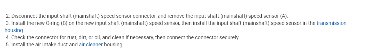

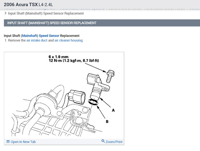

I replaced my shift solenoid b and c but I'm still having problems shifting and my transmission is automatic.
May 7, 2023 at 12:13 PM
Experienced Mechanic
55,711 POSTS
I would start by checking the codes this guide can help:
This guide can help as well:
Make sure the transmission is full of fluid and if so with no codes I would replace the input shaft speed sensor which can cause the problem of the transmission not shifting. Check out the images (below). Please let us know what happens.
