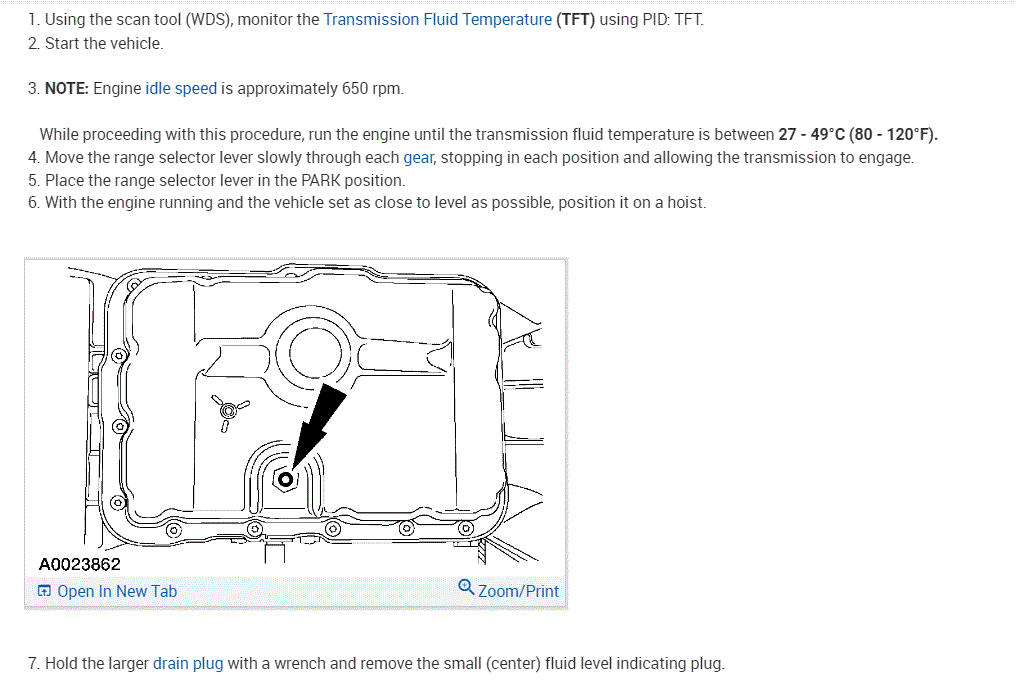

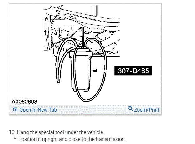

So, I bought my truck a few months ago and I’ve noticed that when I go from P TO R it’s instant but going from P TO D it takes maybe a half second sometimes and is sometimes a little more clunky but not too much. I wanted to know if this could be a symptom of low fluid or just wear and tear cause other than that it shifts relatively fine, it definitely feels like it’s got 200,000+ for sure but I’ve had no issues. I’m only hesitant to change the fluid because Ford ditched the dipstick on this transmission, and I have no idea how the past owners were with maintenance.
Jun 30, 2022 at 6:24 PM
  • 110,194 POSTS

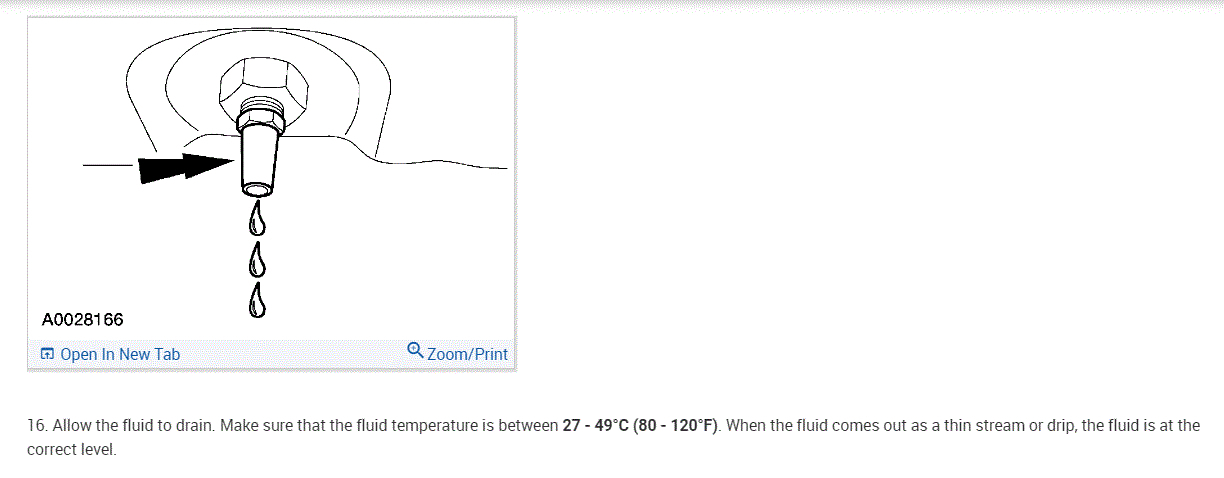

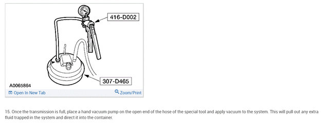

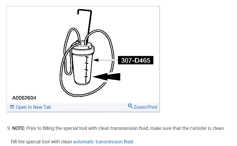

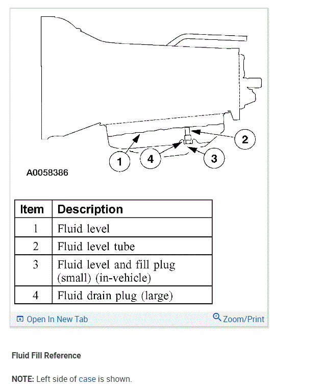

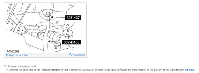

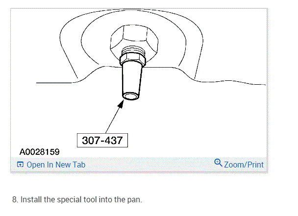

If it isn't too noticeable and shifts that quickly, chances are it is just due to wear. There are rubber O-rings in the valve body of the transmission that can wear and even harden allowing fluid to momentarily bypass them. That can cause a delay.

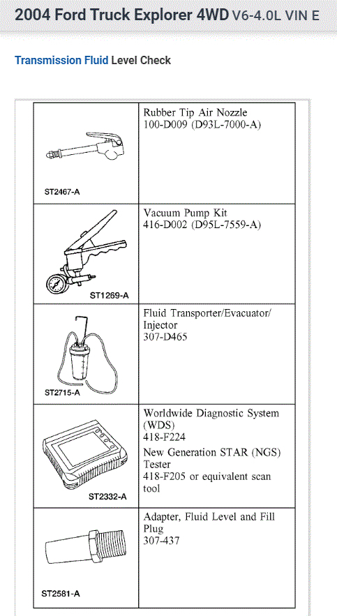

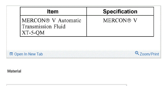

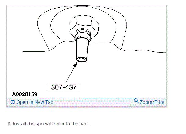

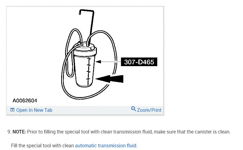

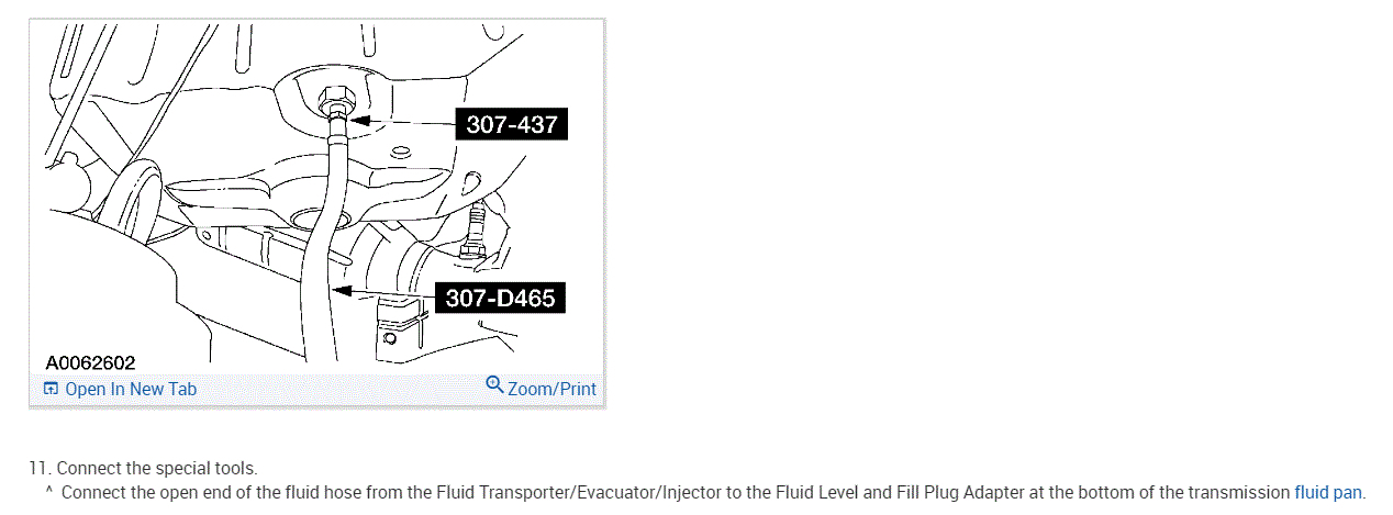

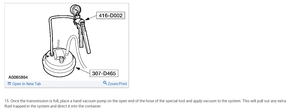

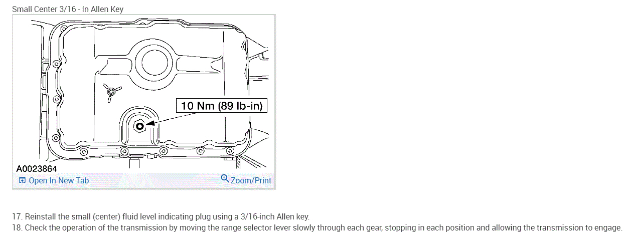

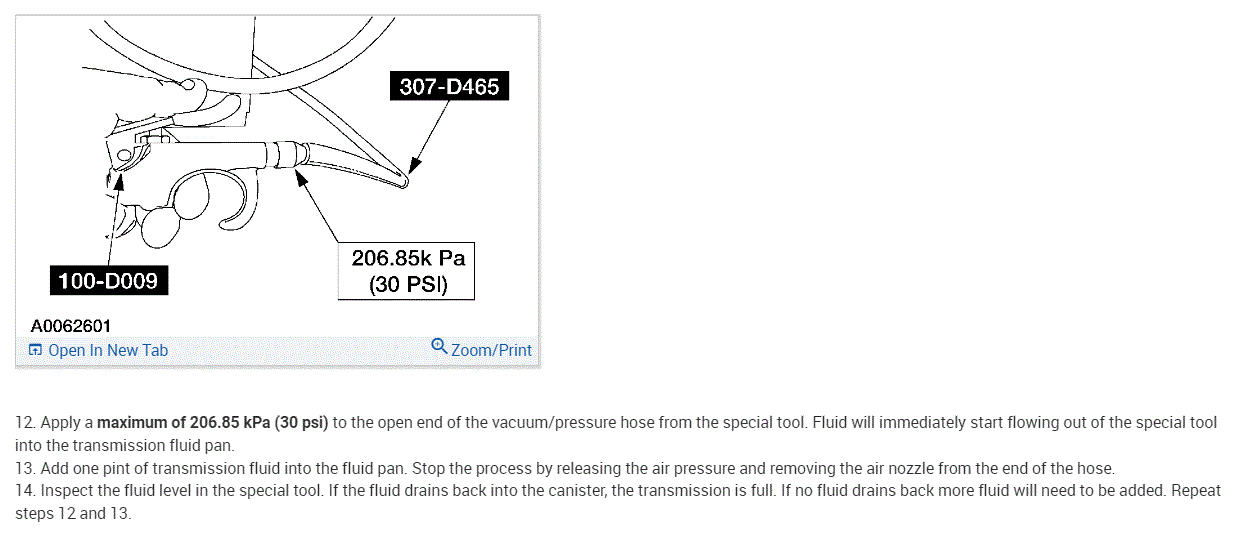

If you want to check the fluid, it requires a few special tools. I attached the directions below for you. And I agree, there is no reason it should be this difficult to check the transmission fluid.
