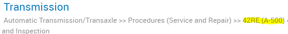

Is the 42RE transmission the same as A500 ?
Feb 12, 2024 at 3:43 PM
  • 110,194 POSTS
Yep. One in the same. See pic below.
