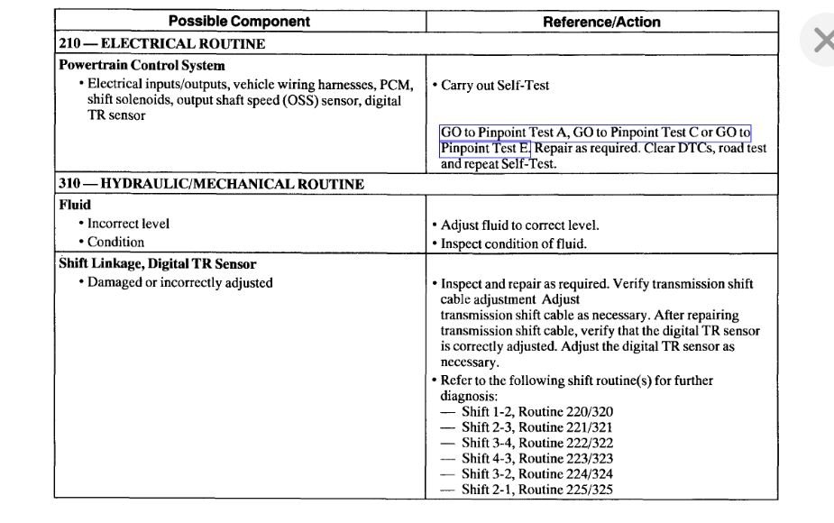

start going, and when it shifts it locks down in 1st.

Good morning,
What do you mean it locks down in first gear? Do you mean it will not up-shift?
How long since you had the fluid and filter changed?
Is the check engine light on? The throttle position sensor is a primary sensor for shifting times for the transmission.
Image (Click to enlarge)
