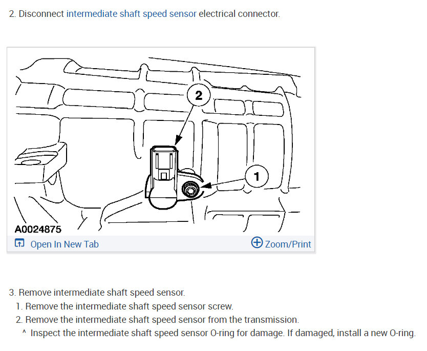

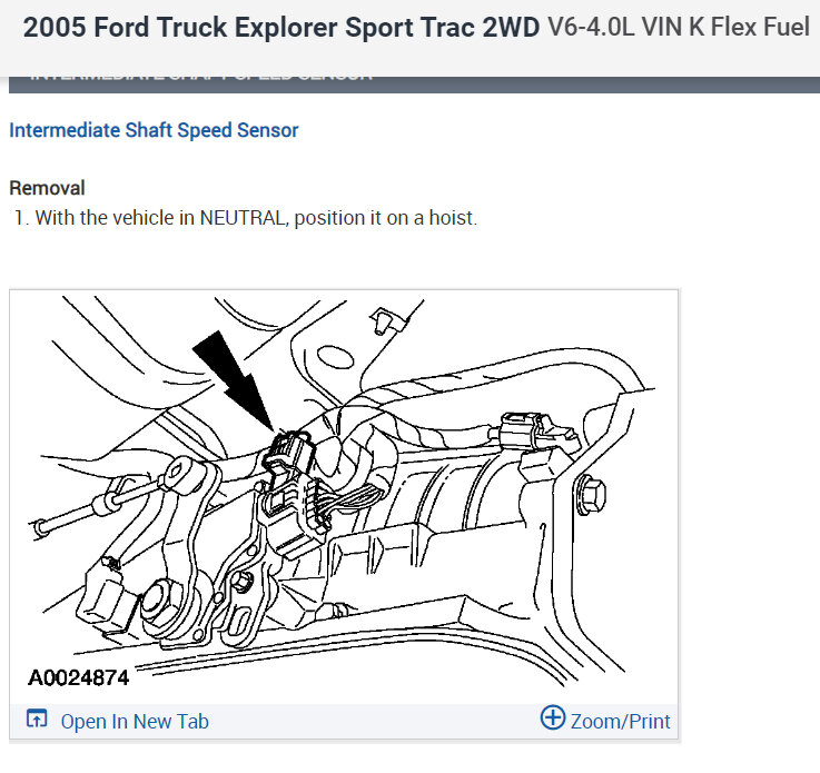

Can drive in low 1 or low 2 and can only drive in d if I go from 1 to 2 to d but while in d I don't think I'm going above 2nd gear still. Can't go over 35 MPH in it. No reverse at all, no overdrive. It always ran high RPMs. It did this several months ago except had drive and reverse just couldn't go over 35. Changed out fluid and filter in June and it fixed it. Well, the RPMs were still really high, but it drove at regular speeds. This happened a couple weeks ago, and I tried draining trans fluid and putting new in and it didn't help anything. Trans fluid was dark and smelled burned both times I changed it out. And when the filter was replaced in June there was a little bit of trash in the filter. We didn't take the filter all the way out this time to check it. Also, I have been having to add water directly into the main spot not the overflow on days I drive a lot of miles and its really hot outside. But the water in the overflow hasn't moved in months.

Are there any check engine lights on? If so, you may have an intermediate shaft speed sensor that needs to be replaced but the fact that the fluid is burnt both times you serviced it is not good and the transmission may need to be rebuilt. Here is a video that shows how the transmission will be removed and the location of the intermediate shaft speed sensor location in case you want to try swapping it out.
https://youtu.be/3vJAojsrfuU?si=IGRgVSMOFO-KH-VK
Check out the images (below). Please upload pictures or videos in your response of any problems so we can see what to help you with.
