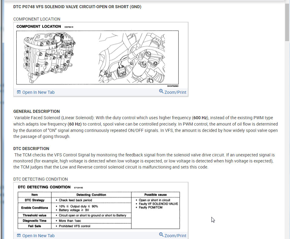

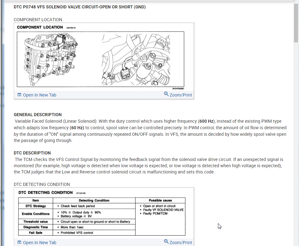

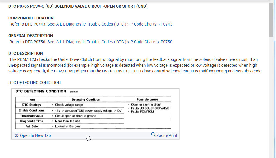

Codes p0765 and p0748, transmission will randomly default into third gear
139,000 MILES • 2.0L • 4 CYL • 2WD • AUTOMATIC
JAKEMAN223
transmission will randomly default into third gear and throw a p0765 and a p0748 code. I have already change the shift solenoid pack. and still acting up. could the TCM/PCM be faulty in this case?
May 27, 2021 at 8:01 AM

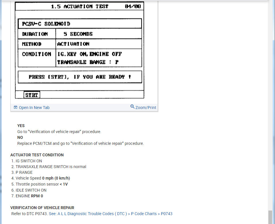

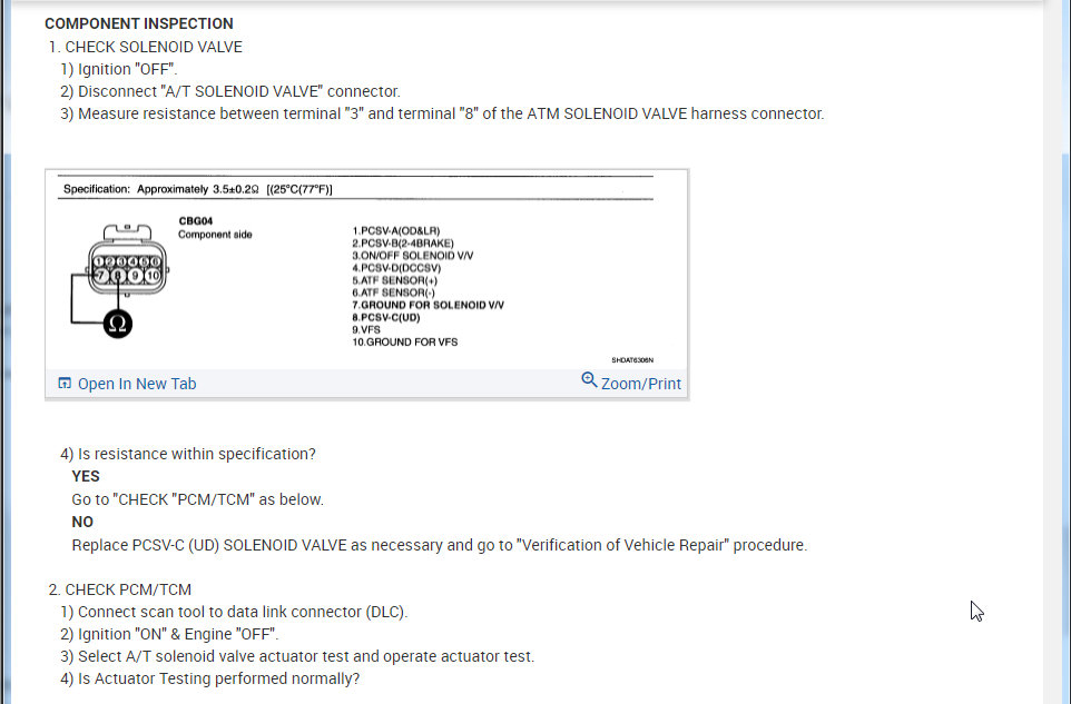

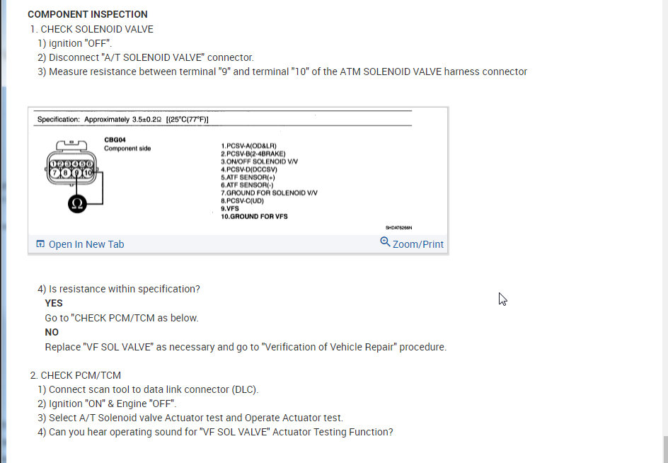

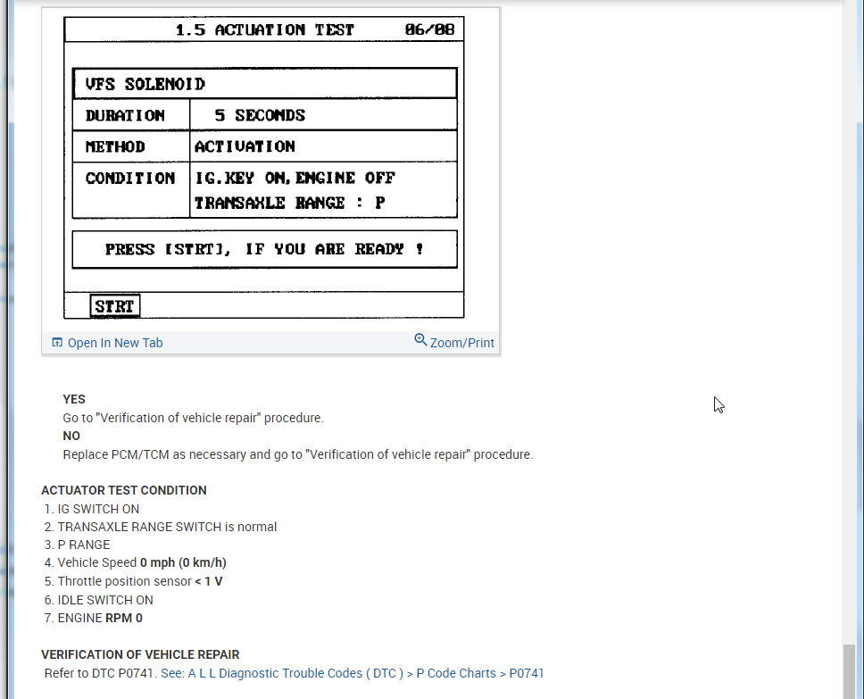

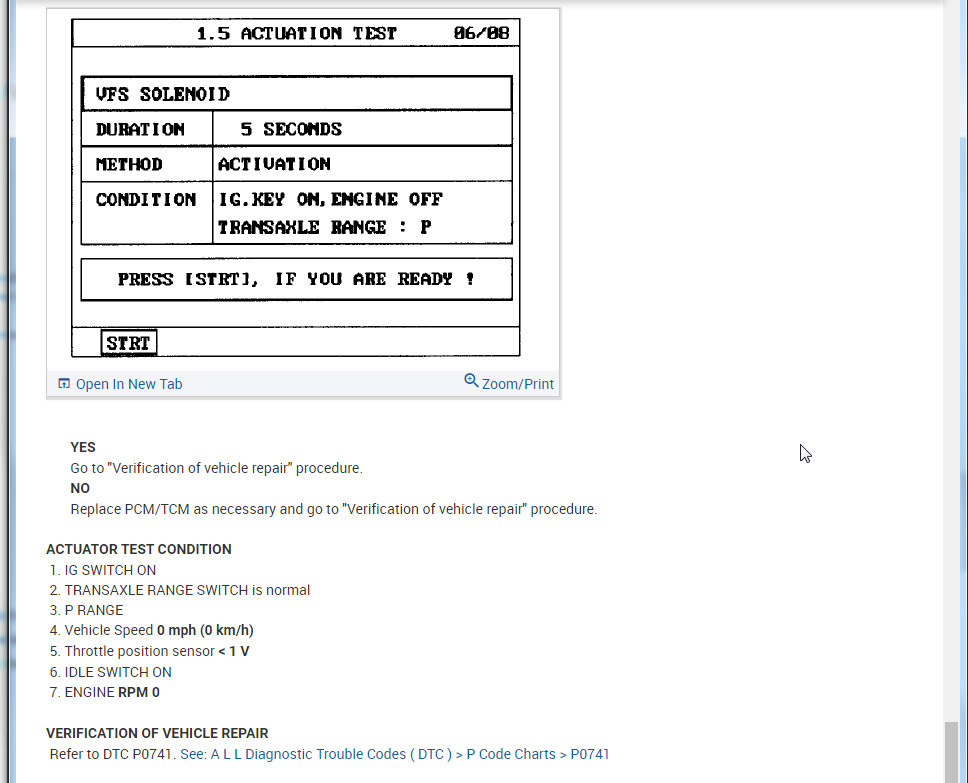

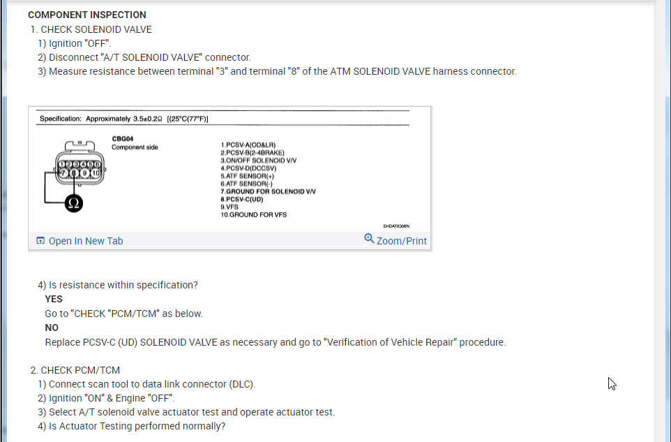

Yes, it is possible that the module has failed. However, it could also be a solenoid or a wiring issue to the solenoid.
We need to run through the testing below in order to determine this.
I attached the info below for your review. Please let us know if you have questions on this but it appears they require a scan tool to inspect it but it may be worthwhile as getting a PCM/TCM when that is not the issue could be costly.
