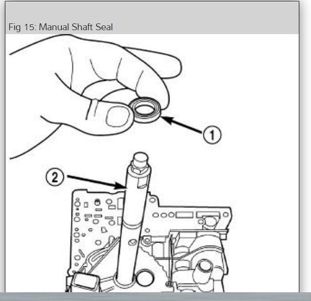

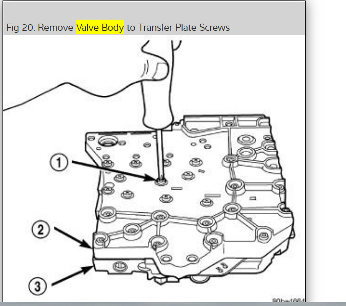

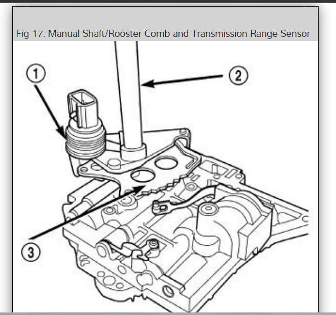

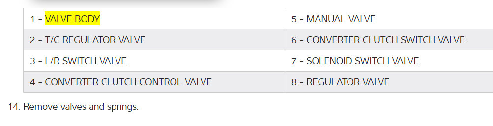

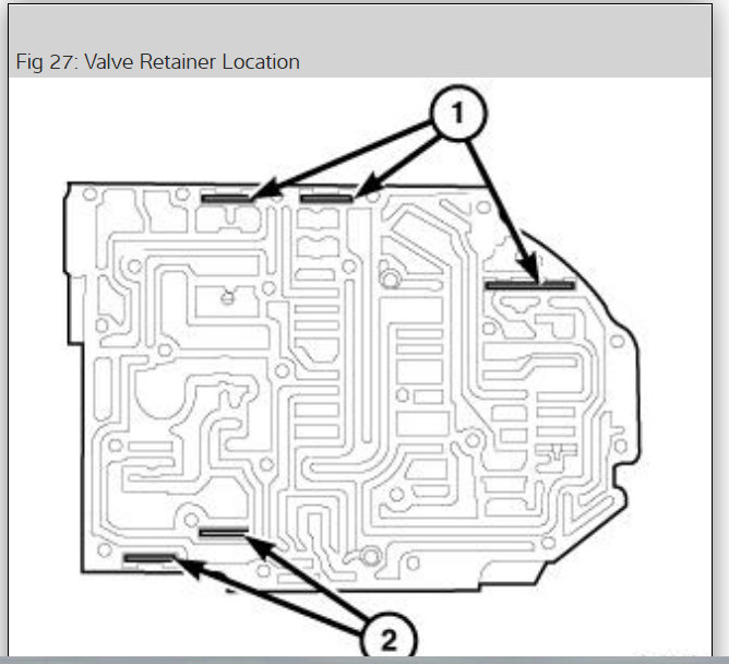

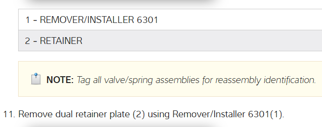

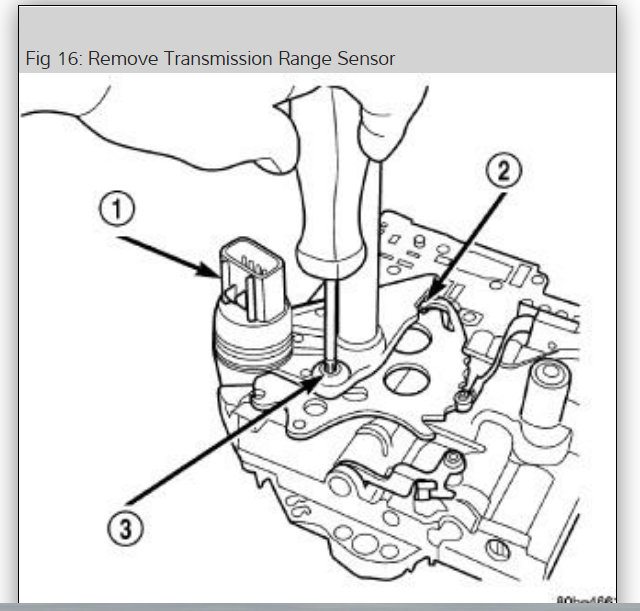

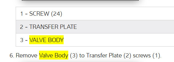

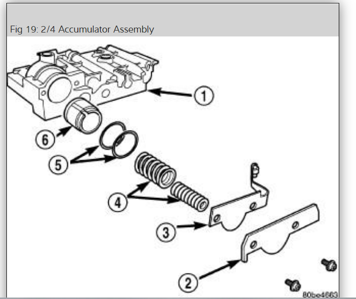

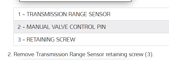

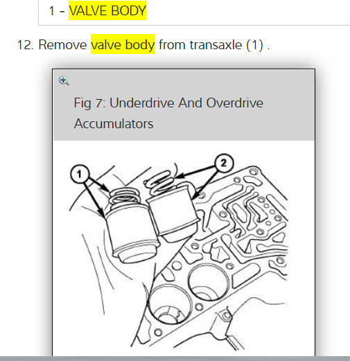

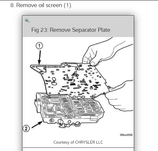

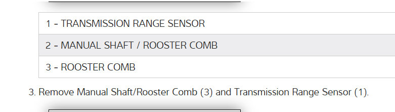

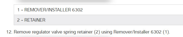

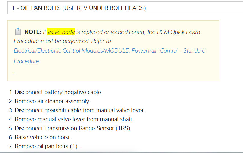

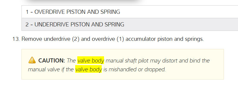

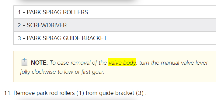

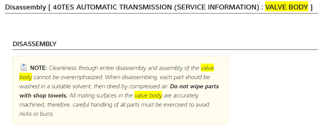

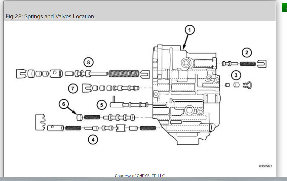

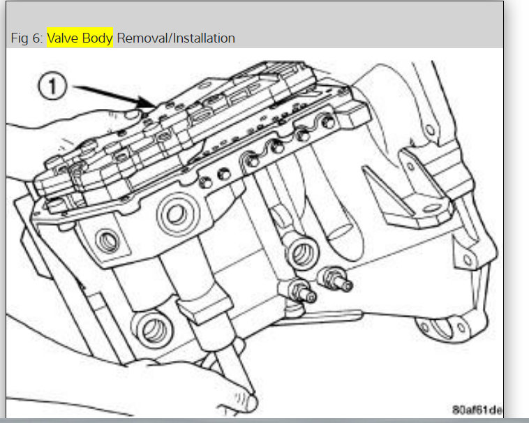

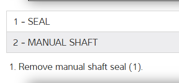

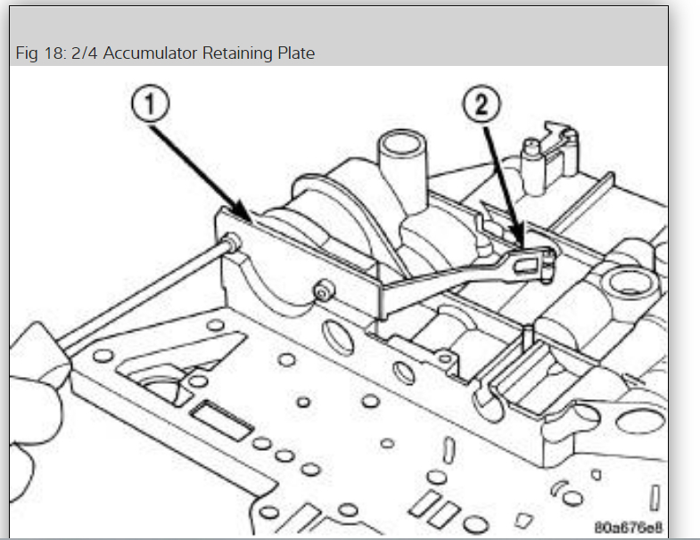

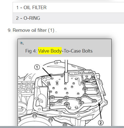

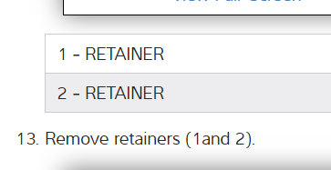

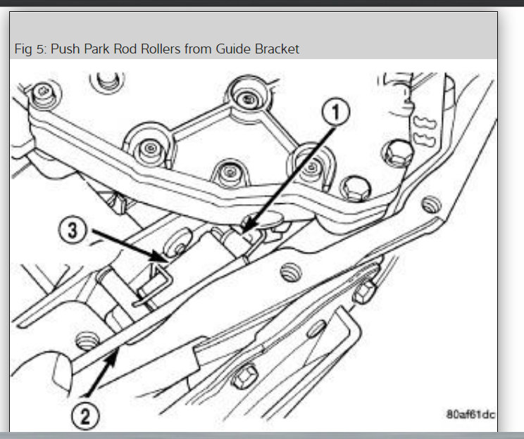

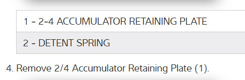

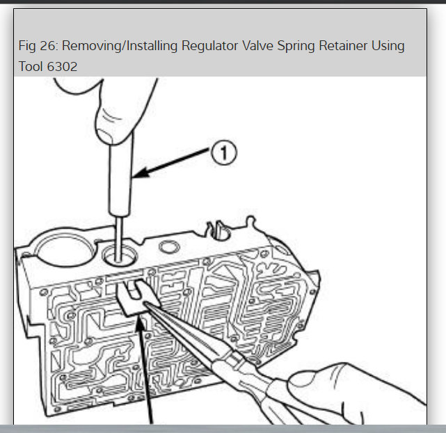

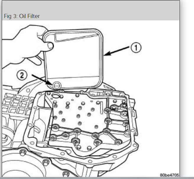

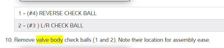

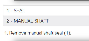

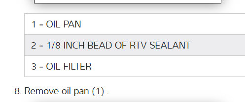

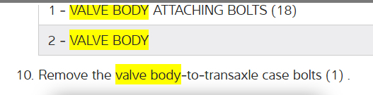

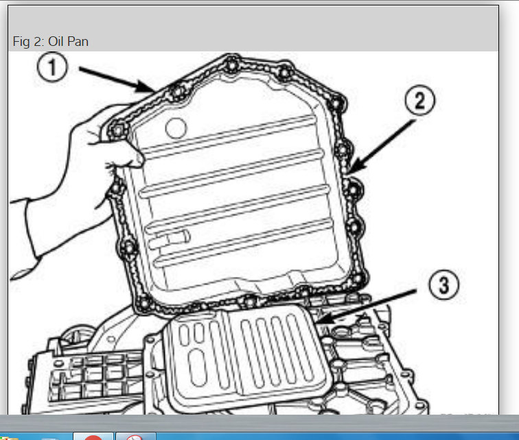

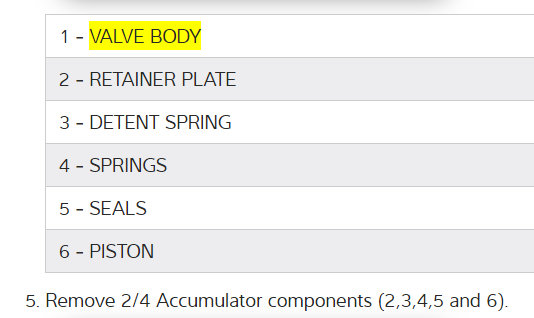

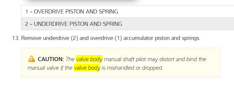

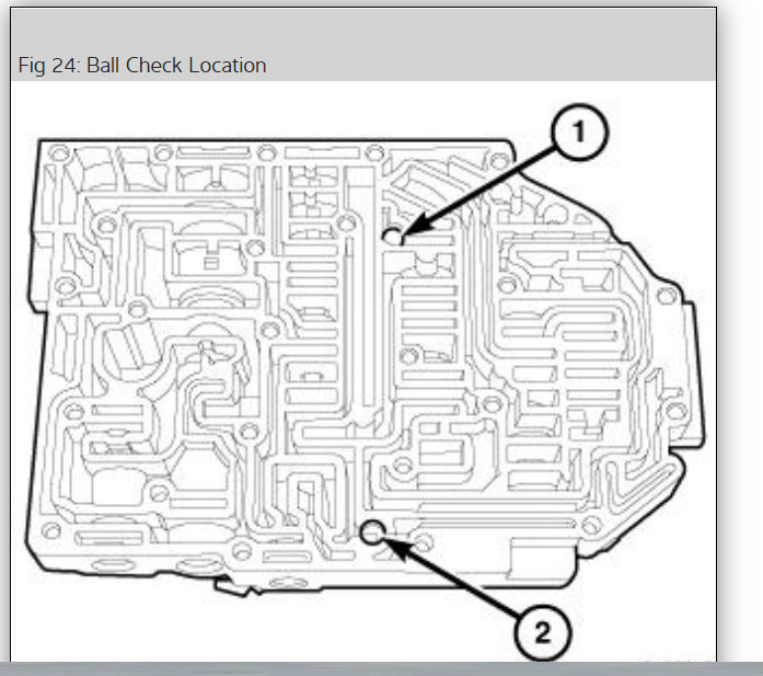

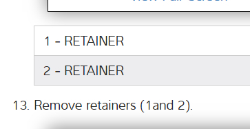

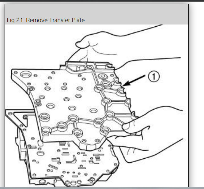

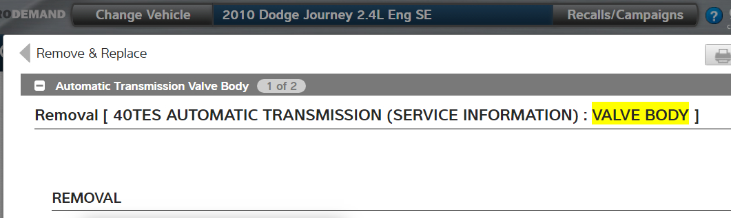

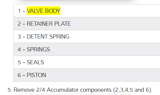

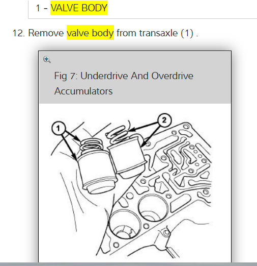

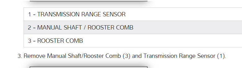

I don't know the placement for the check balls on the transmission.
Apr 4, 2019 at 8:50 AM
SCGRANTURISMO
  • 4,897 POSTS
I need to get the engine size from you as it makes a difference as to what transmission your vehicle has. We will get you detailed disassembly and assembly instructions including where the check balls go,
Thanks,
Alex
2CarPros
Apr 4, 2019 at 4:01 PM
SAMNDGRACE17
It is a 2.4L.
Apr 4, 2019 at 4:48 PM
SCGRANTURISMO
  • 4,897 POSTS
Hello again,

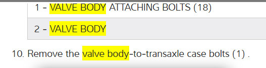

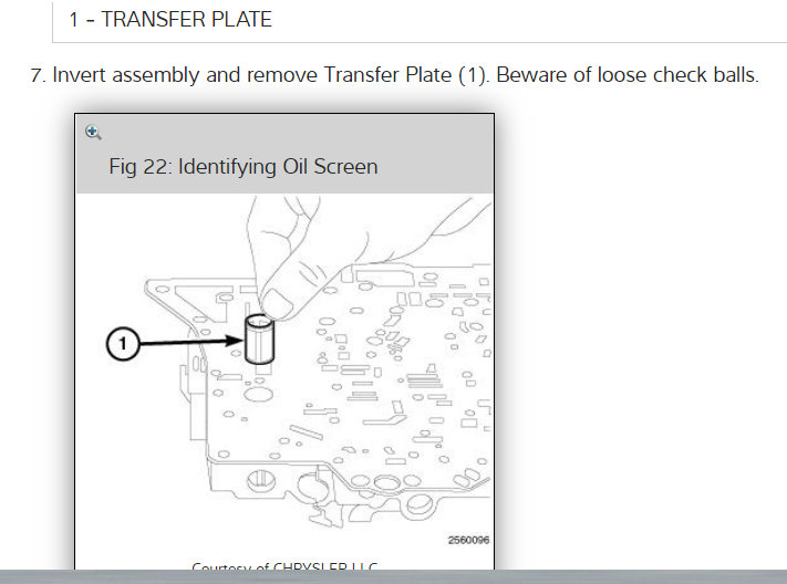

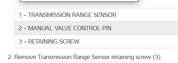

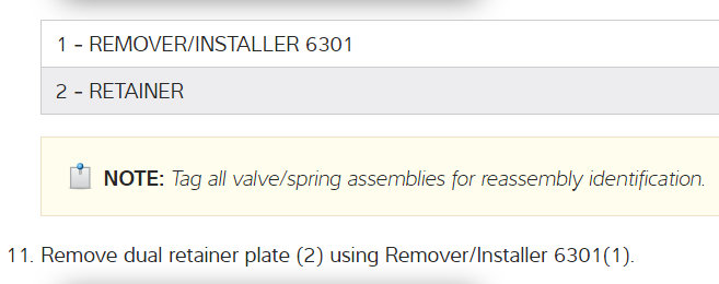

I have included the directions for removal and disassembly of the transmission valve body in the diagrams down below. If you need the assembly and installation instructions please get back to us and we will get those sent to you right away.
Thanks,
Alex
