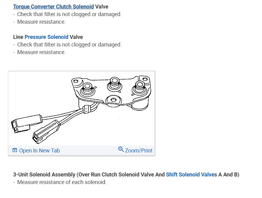

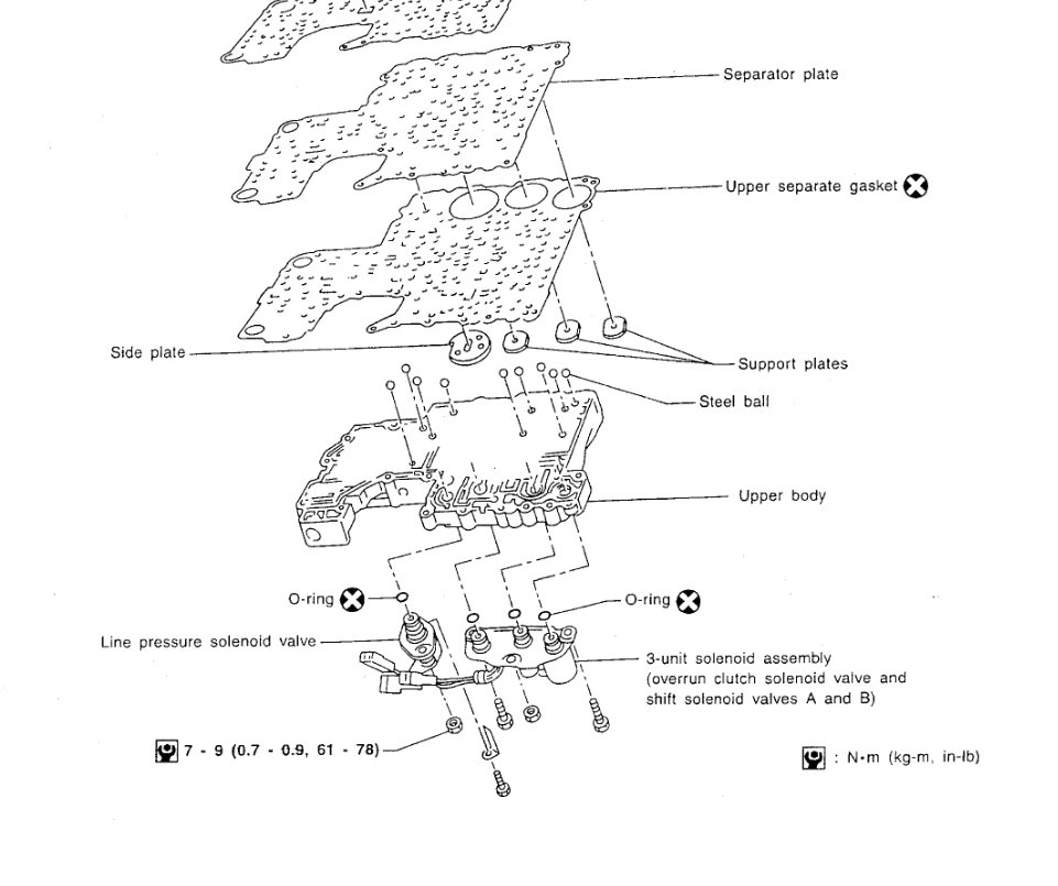

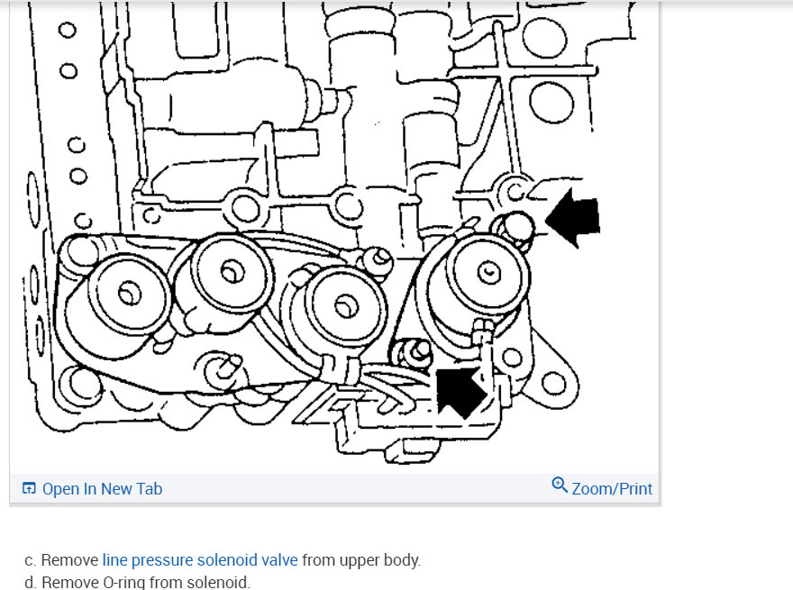

Transmission will work as intended one time and will get stuck in second gear at other times. It's a sporadic issue. My question is, would this be related to the solenoid pack. Thank you for any advice.
Sep 13, 2022 at 12:57 AM
  • 55,423 POSTS

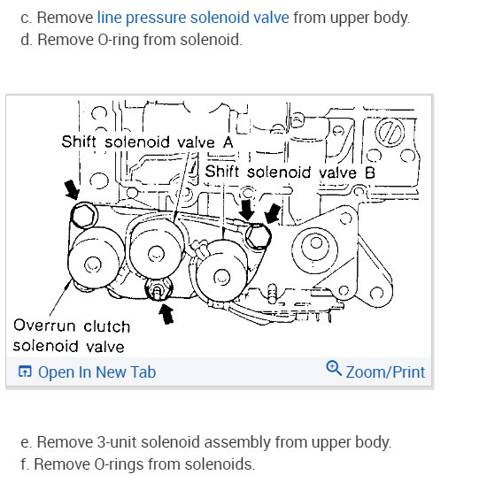

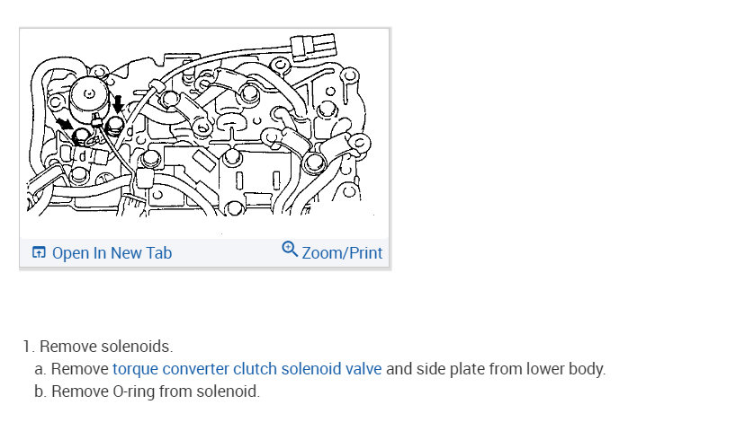

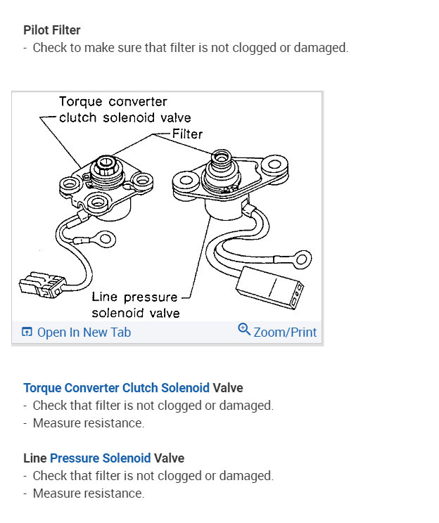

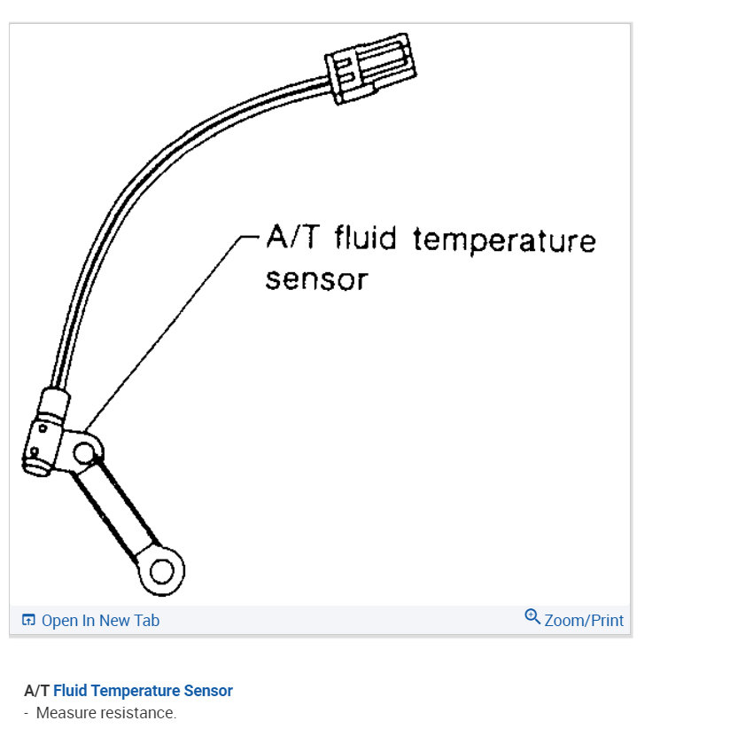

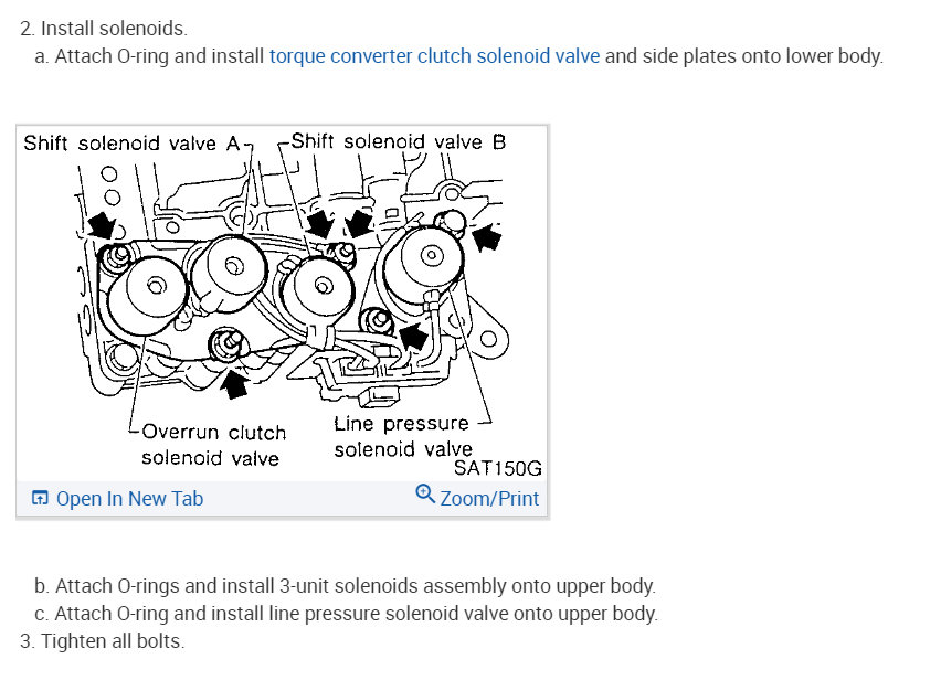

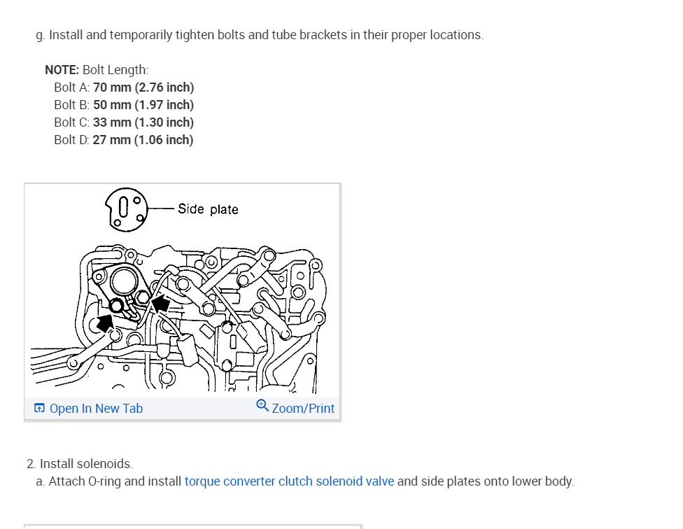

Yep, it sounds like the solenoid pack has gone out, they service them as a unit. here is the location of the solenoids and how to replace them in the images below.
