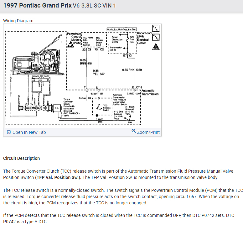

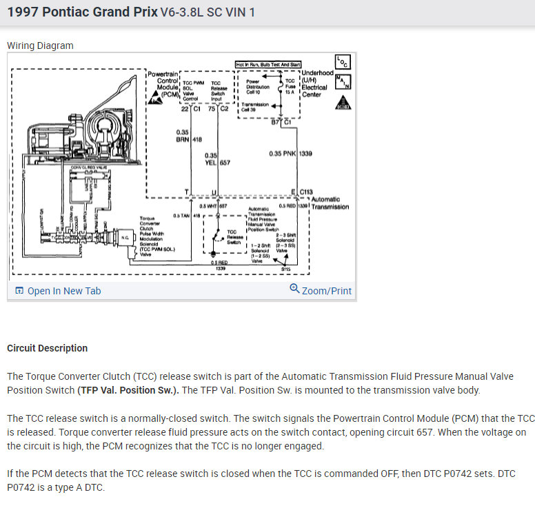

Transmission works perfect. Come up to a stop sign, no transmission. Turn car off then on turn it back on you have transmission. Has a code of P0742. Car is also supercharged.
Sep 30, 2021 at 8:06 AM
SQM
  • 6,383 POSTS

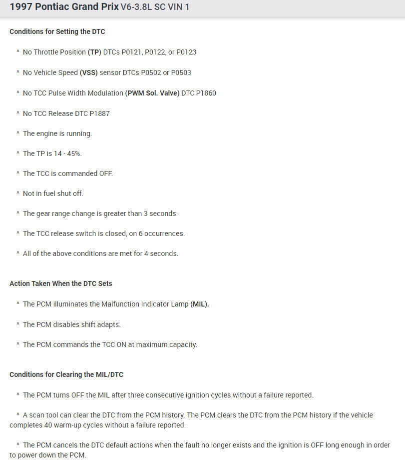

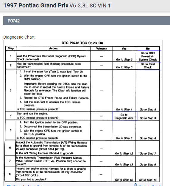

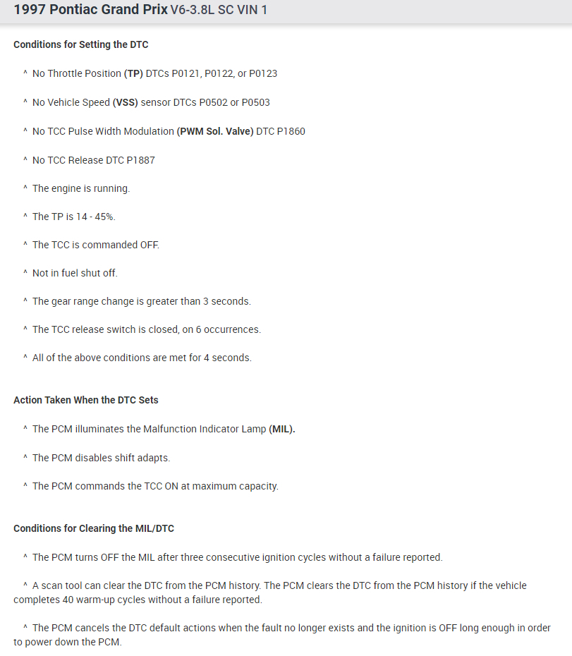

The code: P0742 - TCC (torque converter clutch) Stuck On.

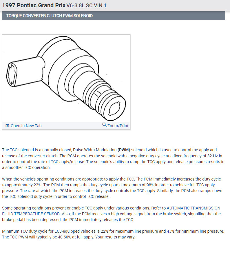

This can be due to a faulty powertrain control module or torque converter clutch switch.

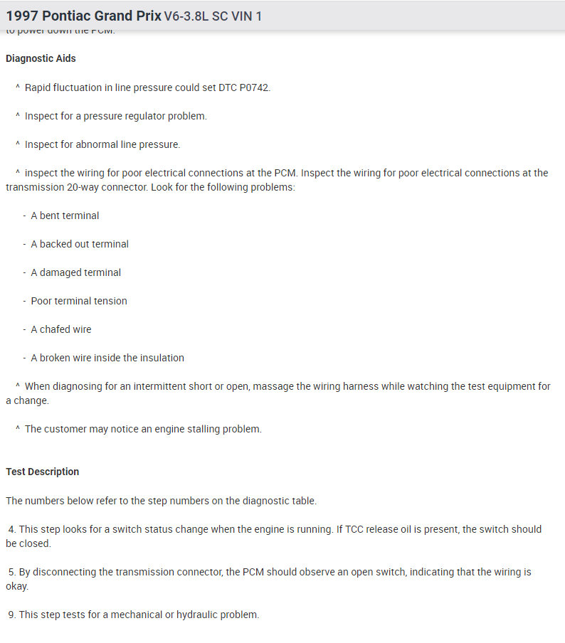

It could also be an issue with the switch not getting enough power or connection issue.

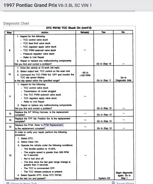

I have attached the diagnostics for that code (look below). This can help determine what is the reason you are having this issue.
