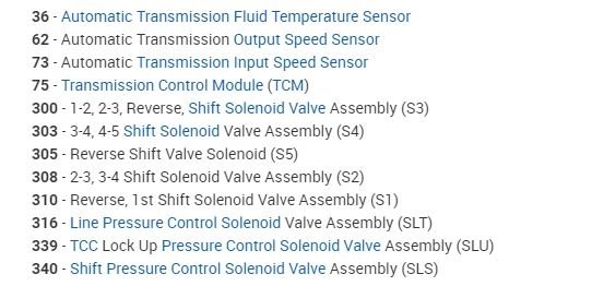

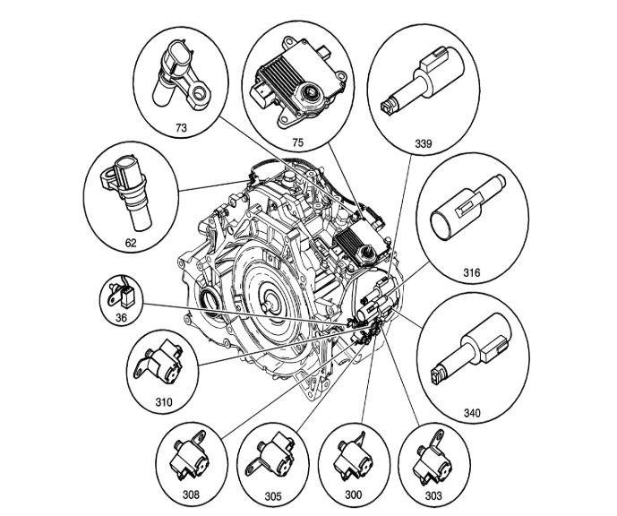

Transmission slipping from third to fourth gear. RPM's goes up when accelerating have to let off gas to change gear slow accelerating.

This sounds like the clutches are slipping inside the transmission.
Are there any codes set?
