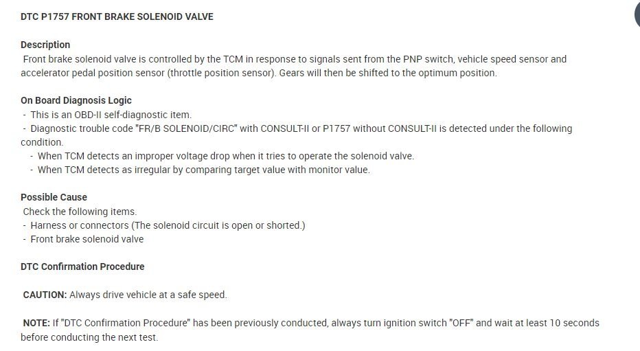

Check light came on had code read and says A/T FR/B Solenoid Valve Circuit Malfunction.
If i'm stopped and drive the car wont go. i step on gas and is slowly driving takes awhile to kick in and drive or wont drive at all.
Does this sound right?

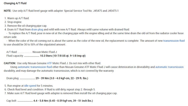

Good morning,
I need the code number to help you. It should start with a P and then some numbers.
As far as the operation, I would start by changing the fluid and filter. If you have a clogged filter, it will act like this.

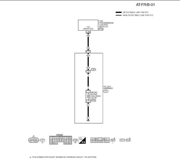

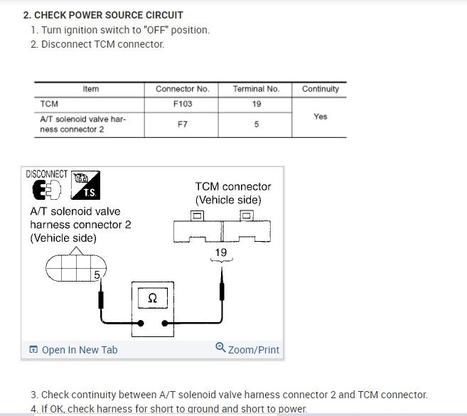

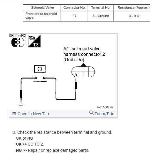

P1757.
Sep 21, 2021 at 2:53 AM
The code is for the front brake solenoid circuit. This is located in the ABS module and has nothing to do with your issue.
Did you get the fluid changed yet to see if that is the issue?

Did you change the fluid? I would try that first before buying a transmission.

I would change the fluid first. It is about $89.00. A lot cheaper than replacing the transmission.
