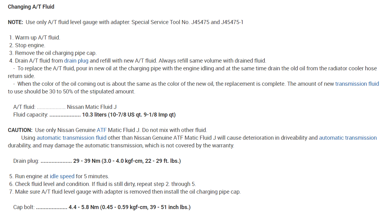

As far as the operation, I would start by changing the fluid and filter. If you have a clogged filter, it will act like this.

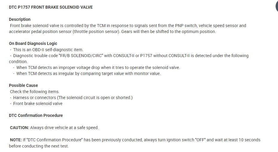

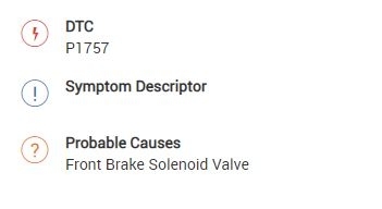

P1757.
Sep 21, 2021 at 9:53 AM
The code is for the front brake solenoid circuit. This is located in the ABS module and has nothing to do with your issue.
Did you get the fluid changed yet to see if that is the issue?

Did you change the fluid? I would try that first before buying a transmission.

I would change the fluid first. It is about $89.00. A lot cheaper than replacing the transmission.
