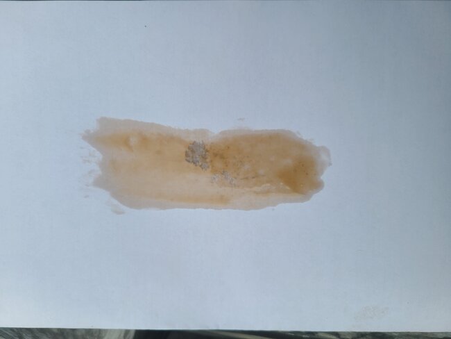

Here is a pic of the Transmission oil. I just smeared it onto plain paper. The car has yet to do it again. Honestly, I'm not going to do anything at the moment until it acts up again. Let me know what you think of the color of the transmission fluid.

Please keep in mind, I'm looking at a picture. But from what I see, it looks like you would be okay to service it. If it was dark brown or black and had a burnt smell, I may be concerned, but that doesn't look too bad.
In this case, when you decide to do it, only change the filter and the fluid that comes out of the pan when it is removed. Don't fully flush it with a machine. I say that only because of the mileage.
Let me know if there is anything I can help with or if you have other questions.

Thank you for your response. I realize though after looking at this picture this may not have been an accurate depiction of the state of the fluid.

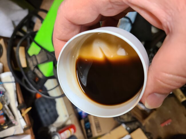

While I do not smell a burnt smell, in greater concentration the fluid is on the brown side. In other words, if I collect the fluid in a cup, it does have a darker look to it. I will try to collect some in a white container.

Let me see what you collect in a cup. Also, it may have been a one-time event. As far as knocking on wood, good idea. LOL At this point, let me see the fluid. From many years of experience, I agree with the idea that "if it isn't broken, don't fix it." LOL
I know you replaced the mounts. There is a chance that is why you got the original hard shift.

Yeah, this looks completely different! I don't have a good feeling about changing that. I'm driving this until it can't no more! Then maybe snag a used one with lower mileage. Rebuild I think is going to be out of the question. Too expensive.

Yep, that is a lot dirtier than I would have expected based on the first pic. If you decide you want to rebuild the transmission, let me know and I'll help you through it.
