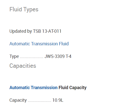

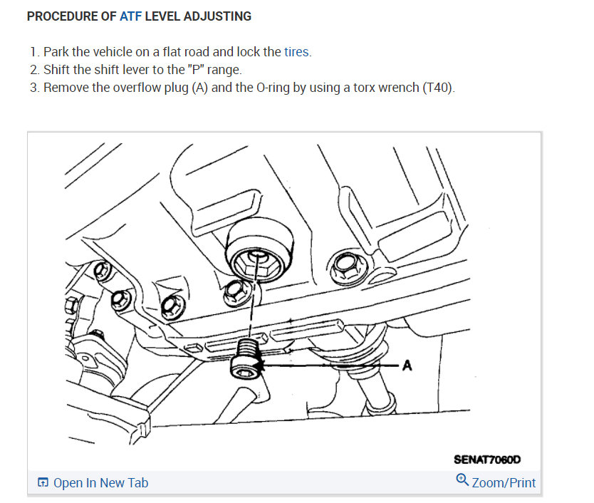

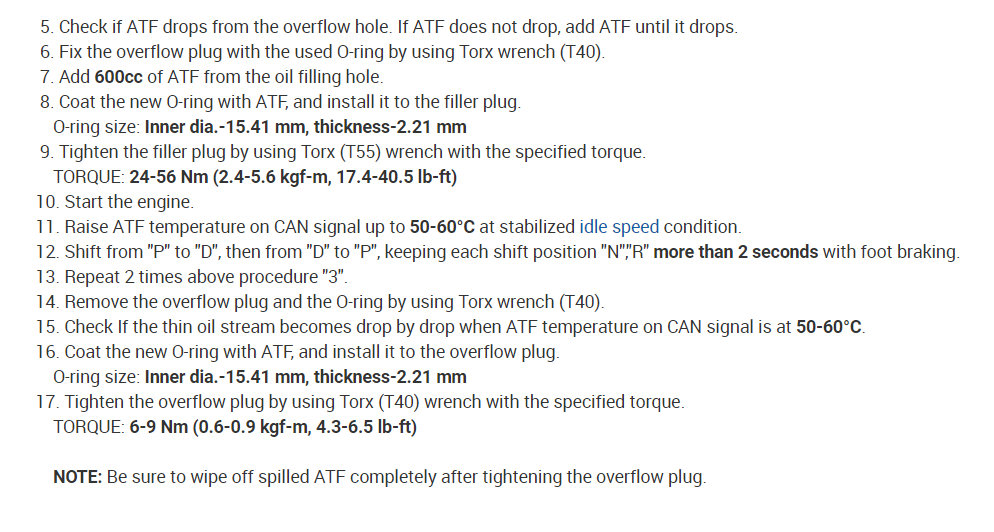

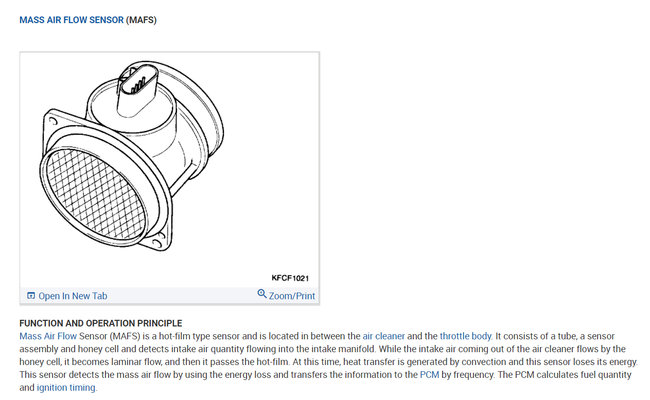

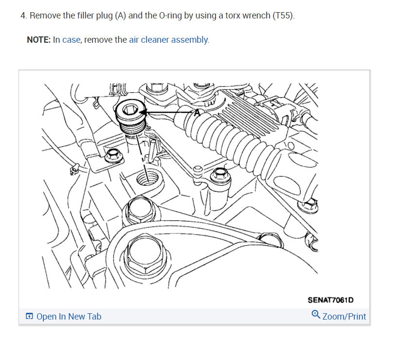

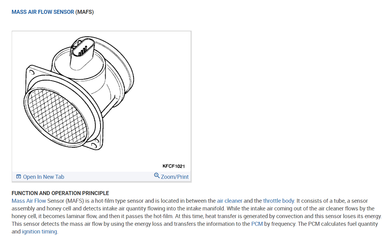

My transmission is stuck in 3rd gear my check engine light is on it says I need a mass air flow sensor. could that be the problem?
May 6, 2021 at 3:26 PM
Experienced Mechanic
52,796 POSTS
Good morning,
Codes do not tell you to replace anything. They tell you there is a failure in that system.
https://www.2carpros.com/articles/how-a-mass-air-flow-sensor-works-maf
Can you list the code number for me to see? Then I can check that code to see if there is a connection to the transmission issue.
Have you changed the fluid in the transmission?
