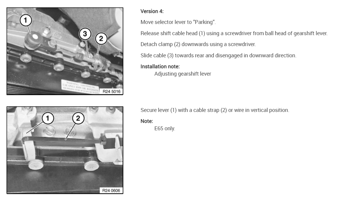

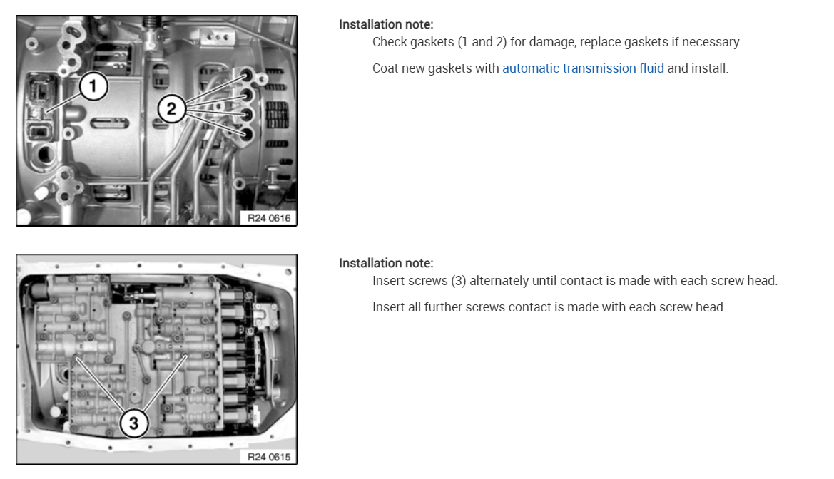

I hear a weird sound when the gear is shifted from 3 to 4 at a particular speed. What should be the reason for this?
When the car is drive about 100kmph or sudden acceleration is given, the car shows a transmission error and the car is getting stopped. Then i have to clear the error to drive again. What may be the reason for this?
Sep 17, 2022 at 2:09 PM
  • 55,402 POSTS

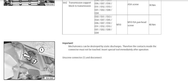

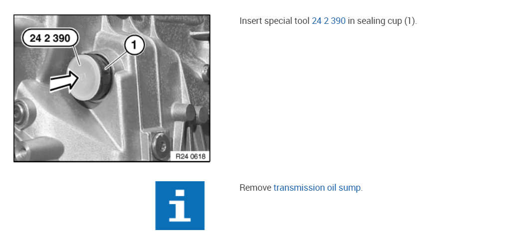

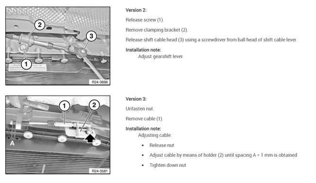

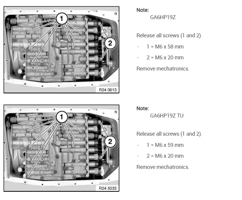

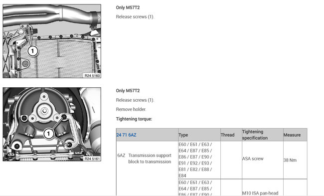

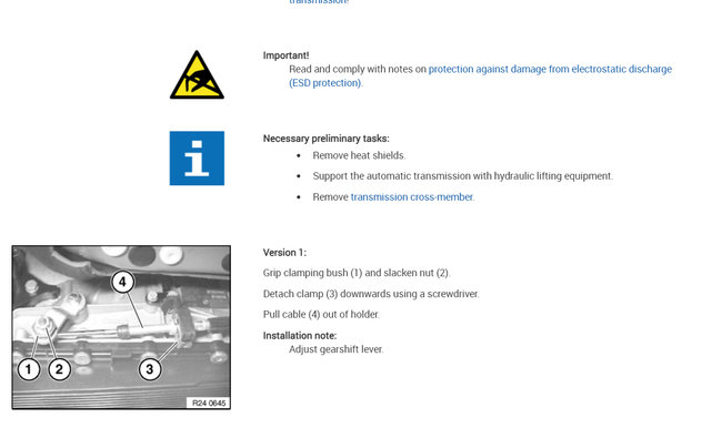

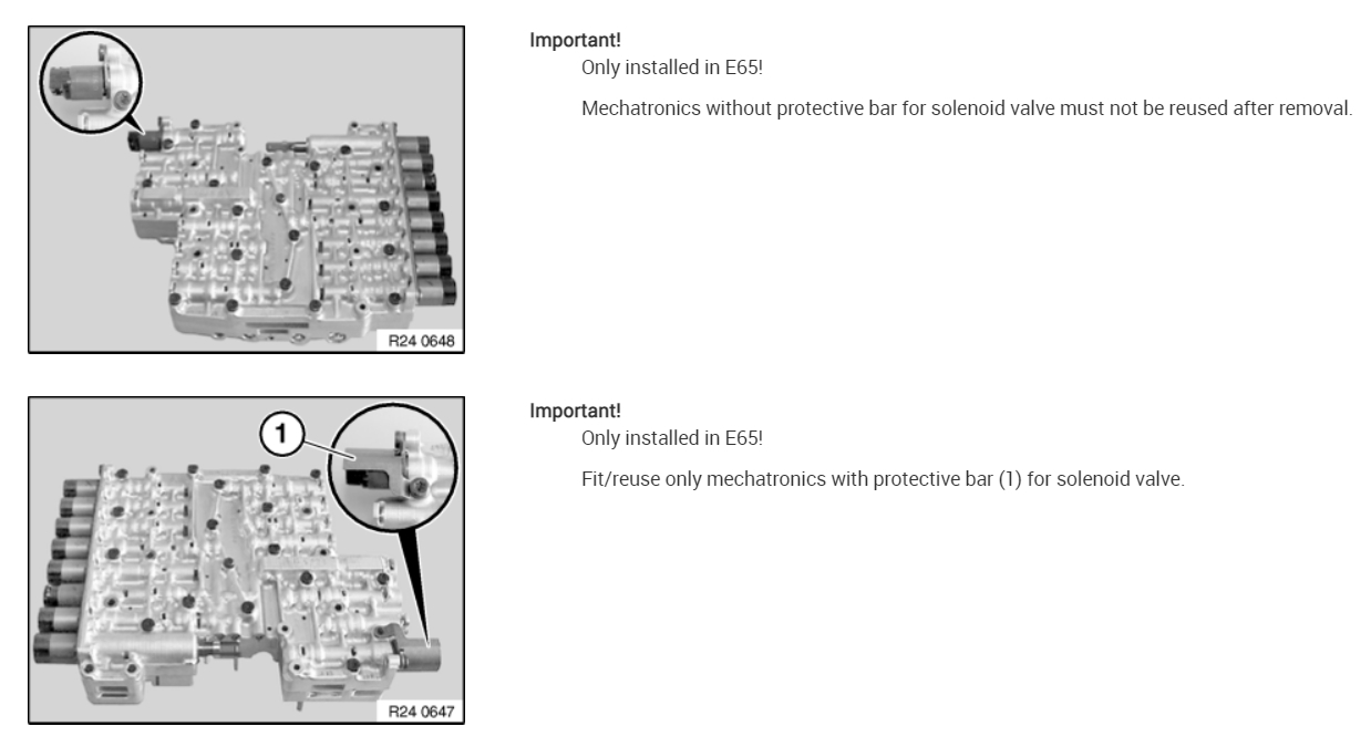

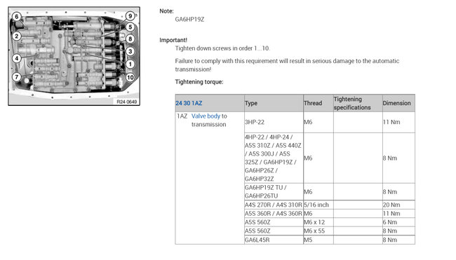

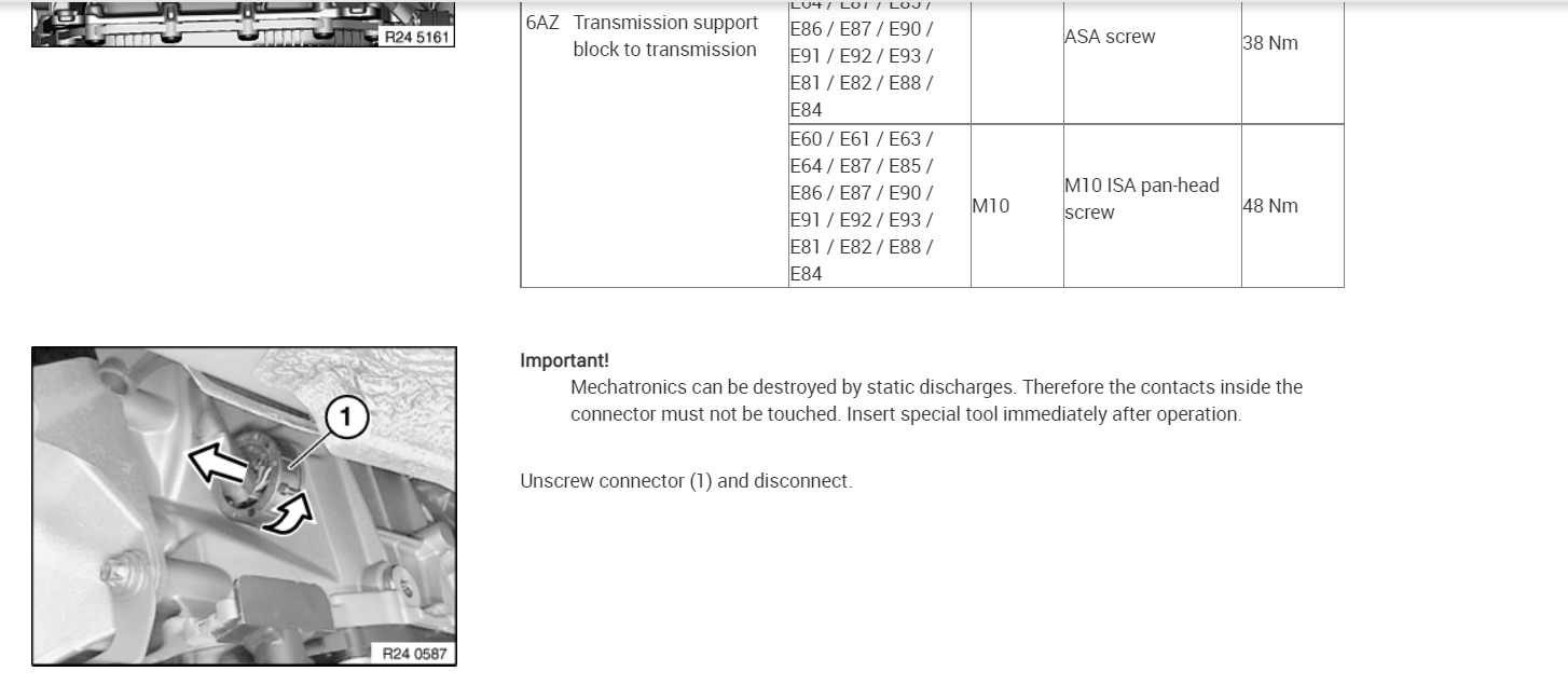

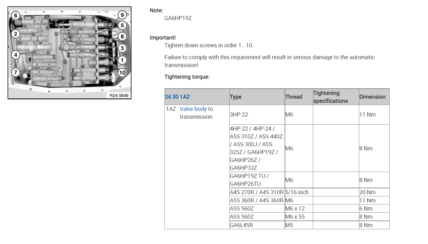

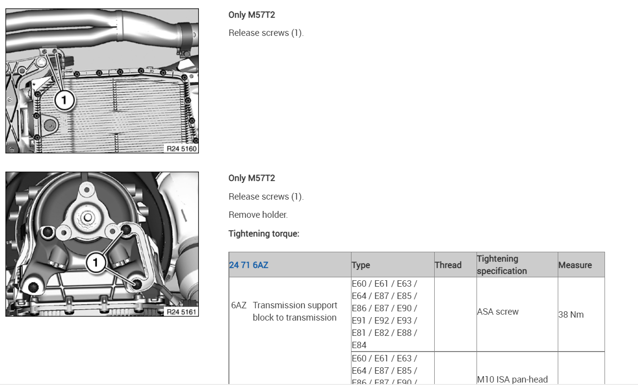

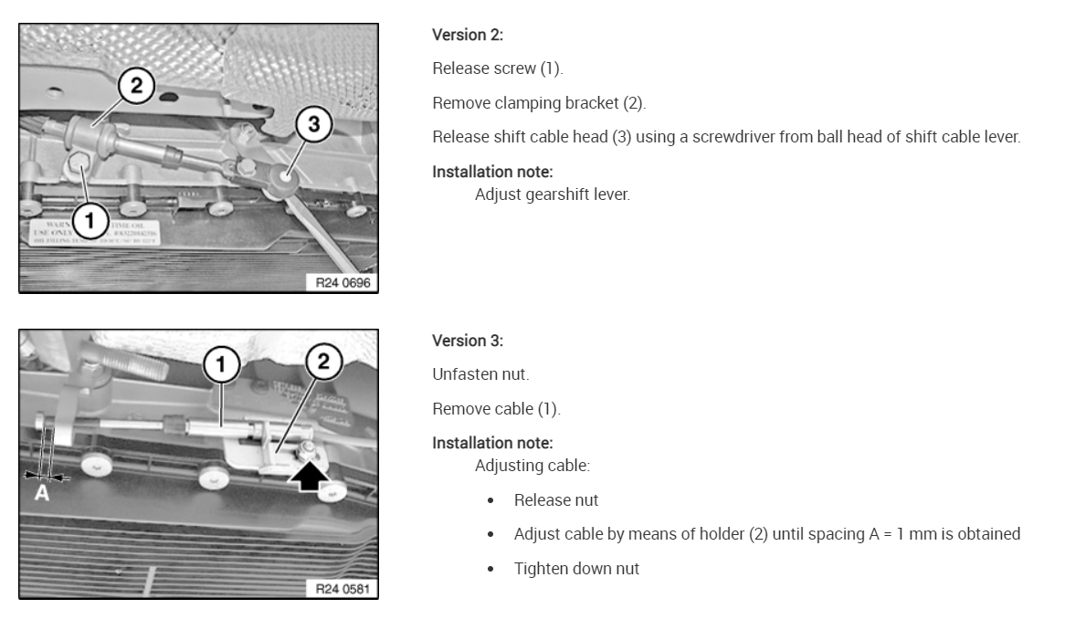

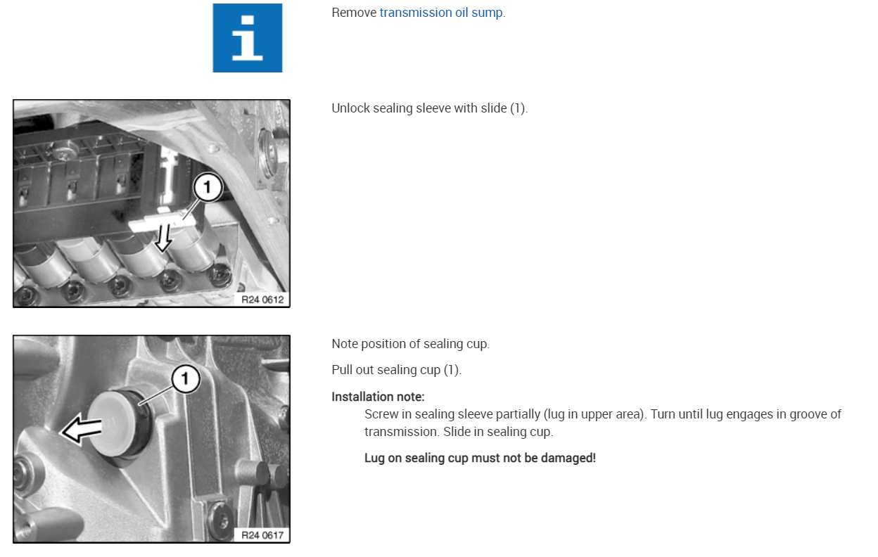

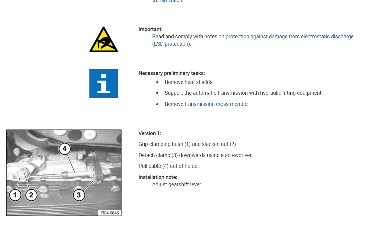

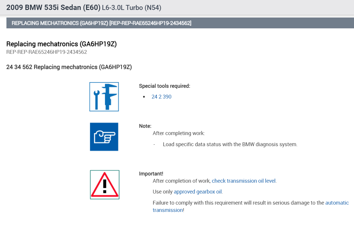

This happens when the transmission valve body and solenoids need to be replaced. This is because one of the solenoids is not closing completely. I could tell for sure if you could upload a short video of the noise here in your response. Just in case I have included how to change out the valve body so you can get a rebuilt unit to help fix the problem. Sometimes you can get away with replacing just the solenoid pack. Also, we should run the codes.
Check out this guide to help:
Check out the images (below). Let us know what happens and please upload pictures or videos of the problem.
