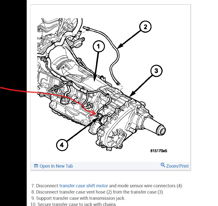

After replacing the transmission it will not shift into 4-wheel drive?
152,000 MILES • 4.7L • V8 • 4WD • AUTOMATIC
GEORGE VORHIES
Changed transmission out and now will not shift into 4-wheel drive.
Oct 30, 2022 at 11:47 PM
  • 55,721 POSTS

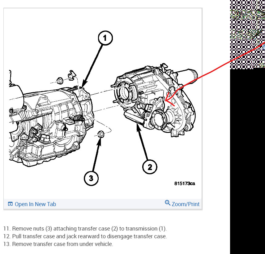

I would make sure the electrical connector to the shift actuator is secure and clean with no damaged pins. Here is the location of the actuator on the transfer case so you can see what I am talking about. Check out the images (below). Please let us know what happens.
