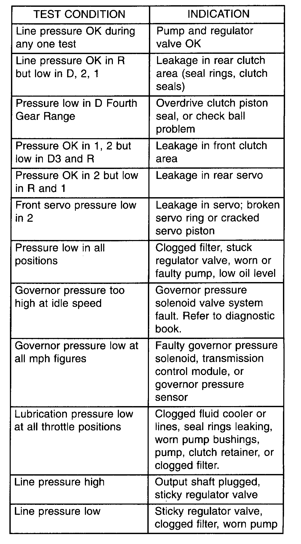

If the transmission is slipping normally that is the result of worn clutches or low fluid. However, I question if the pressure sensor you installed has failed or is not properly installed. Low line pressure can cause a slip.
First, take a look through this link and see if anything helps.
Here are specific directions for testing line pressure. I hate to say it, but I feel you need to start here if there are no codes. All attached pictures correlate with these directions.

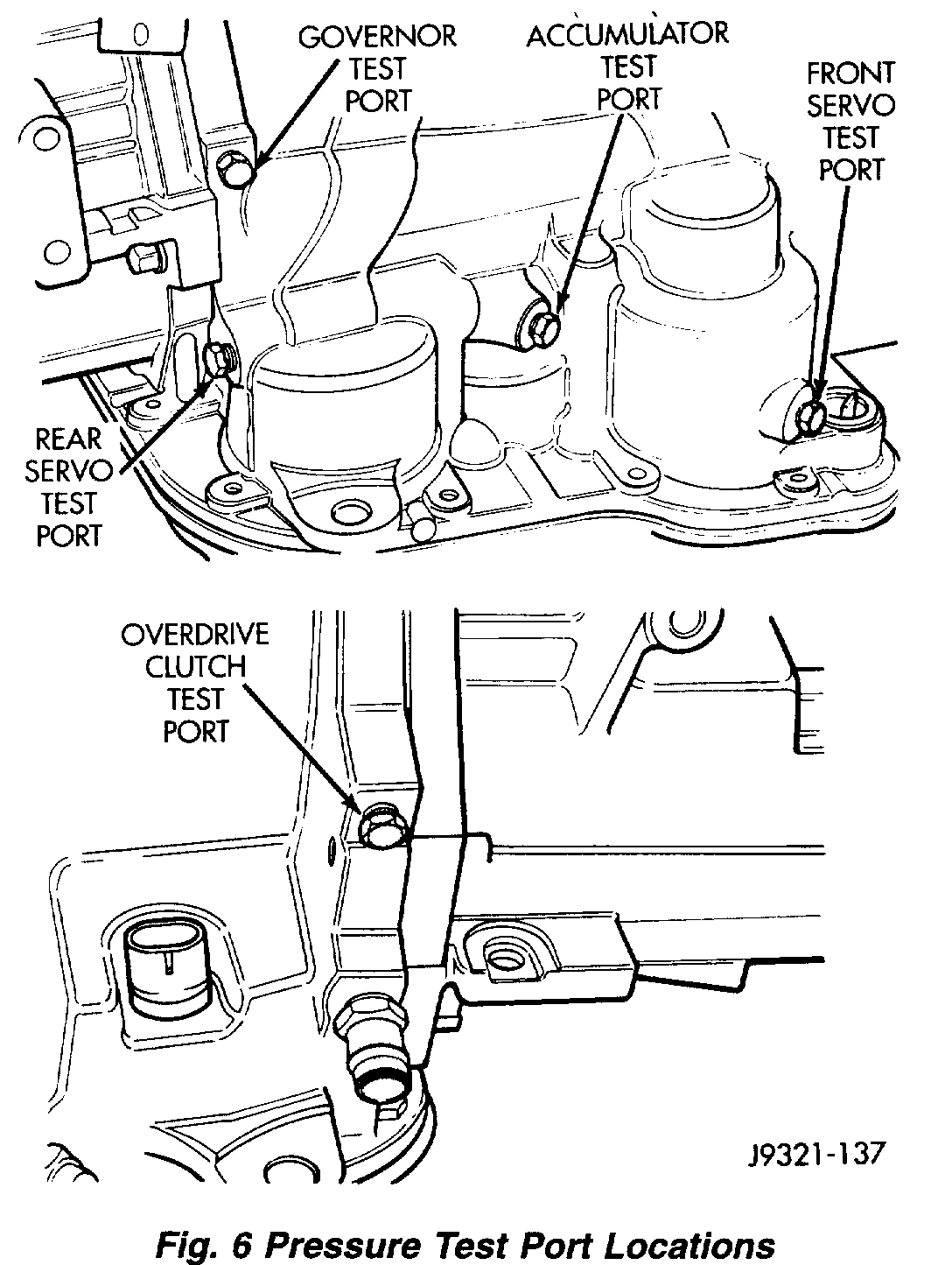

Pressure Test Port Locations
Test ports are located at both sides of the transmission case (Fig. 6).
Line pressure is checked at the accumulator port on the right side of the case. The front servo pressure port is at the right side of the case just behind the filler tube opening.
The rear servo and governor pressure ports are at the right rear of the transmission case. The overdrive clutch pressure port is at the left rear of the case.

Pressure test analysis chart
