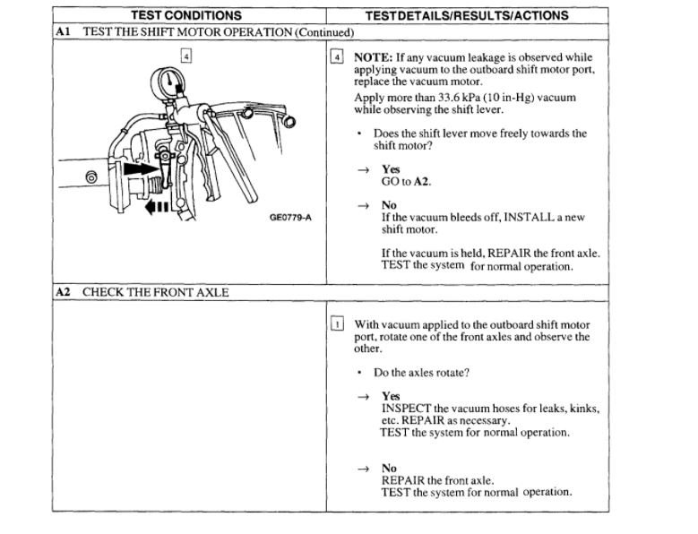

Okay, 743 is for the torque converter solenoid circuit either being open or shorted. the pan would have to be dropped to inspect the harness and do voltage tests to the solenoids to be sure. the solenoid needs to be checked for about five ohms across the terminals.
The 755 is for the shift motor for the four wheel drive system.

Okay as far as 755 code I can understand that one and why. For the 743 code, could that circuit have been fried with a transmission wiring harness issue I had, melted to exhaust? but has been repaired.
Mar 13, 2018 at 2:27 AM
It may have damaged the solenoid and the inside harness, yes.
