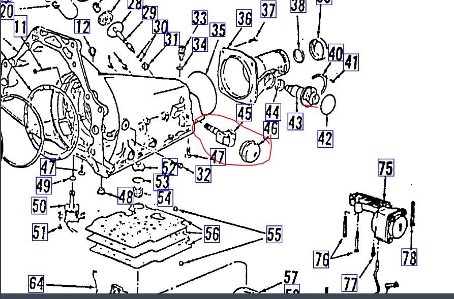

My truck will idle High on 1 and 2 rpm's. also it won’t shift past first gear. I think it might be the filter or the reaction son gear. Also my truck sways back and forth when I go past 50 mph. please help

Good morning,
The throttle position sensor controls the commands for the shifting. It sends a signal to the TCM and then the commands go to the shift solenoids for operation.
Do you have any codes sent?
Have you changed the fluid and filter?

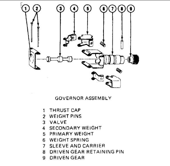

there is a governor that also controls the shifting on the driver's side of the transmission. If the plastic gear is bad, it will not shift. This is a common failure.

That is the very last thing in the flow chart. You need to start with checking the TPS and the governor as I stated.
Does it have a check engine light?

Okay, I’ll look but I didn’t think that year had a governor gears.I know the gear isn’t plastic it’s all metal.

There is a code stored for that light. I need that code as it may be related to the issue.
The end of the governor should have a plastic gear.

Yeah, I know what your talking about, my old classic Chevrolet had the governor gear. my 1996 Yukon is newer and doesn’t have a plastic gear,it’s all metal and I’ll stay in touch until I get it.
