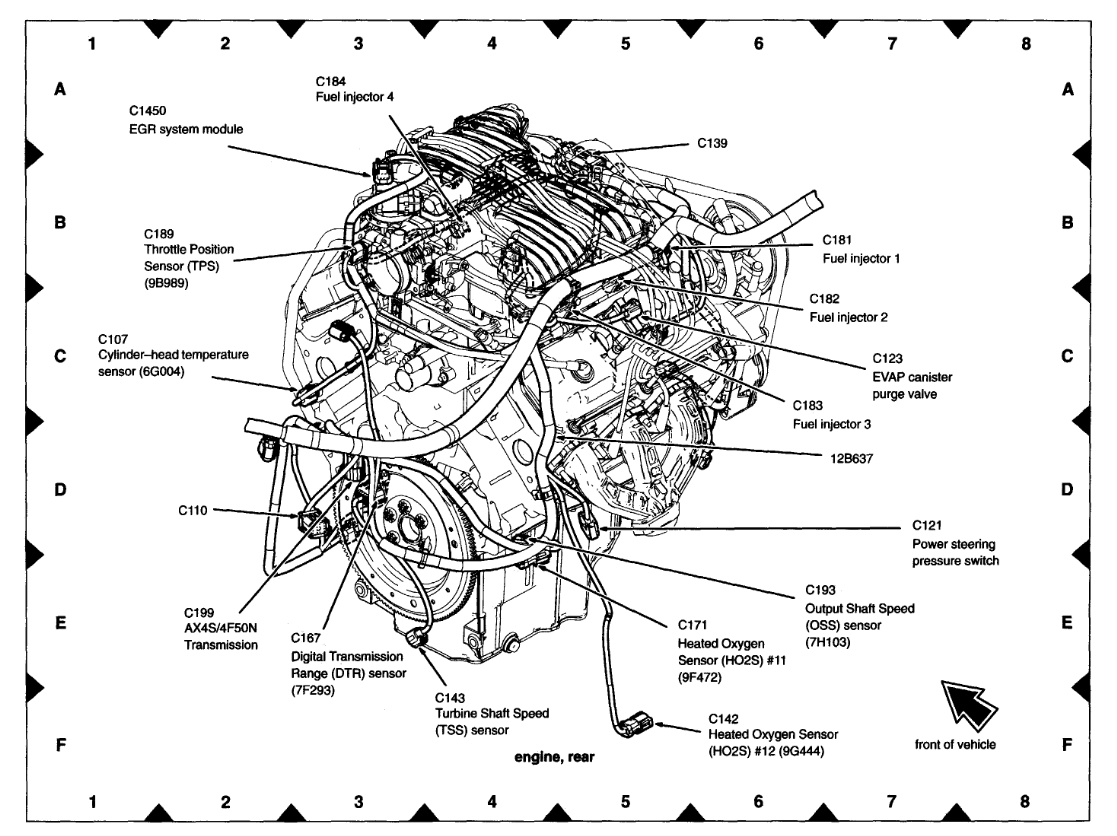

Transmission not shifting into second gear intermittently?
125,000 MILES • 4.2L • 6 CYL • 2WD • AUTOMATIC
RMORGAN123
transmission will-miss shift when shifting into second gear does not do it every time.
Apr 13, 2022 at 7:51 AM
  • 55,745 POSTS
This happens when the turbine speed sensor starts to go out here is the location so you can change it out which a guide and how to fix automatic transmission problems just in case. Also are there any codes?
