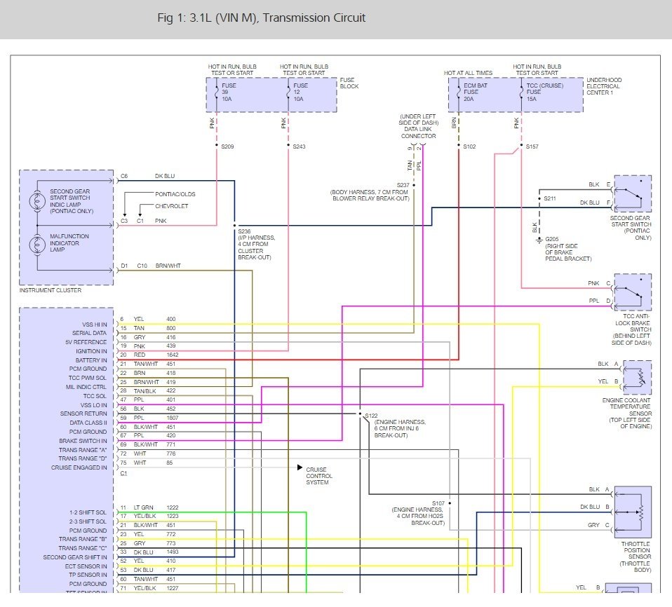

Hi how is your day? my question is, why did my reverse go out on my car? is there any basic way I could fix it without buy a new car? please help it my first owned car.
Jul 7, 2017 at 1:53 AM
  • 55,732 POSTS

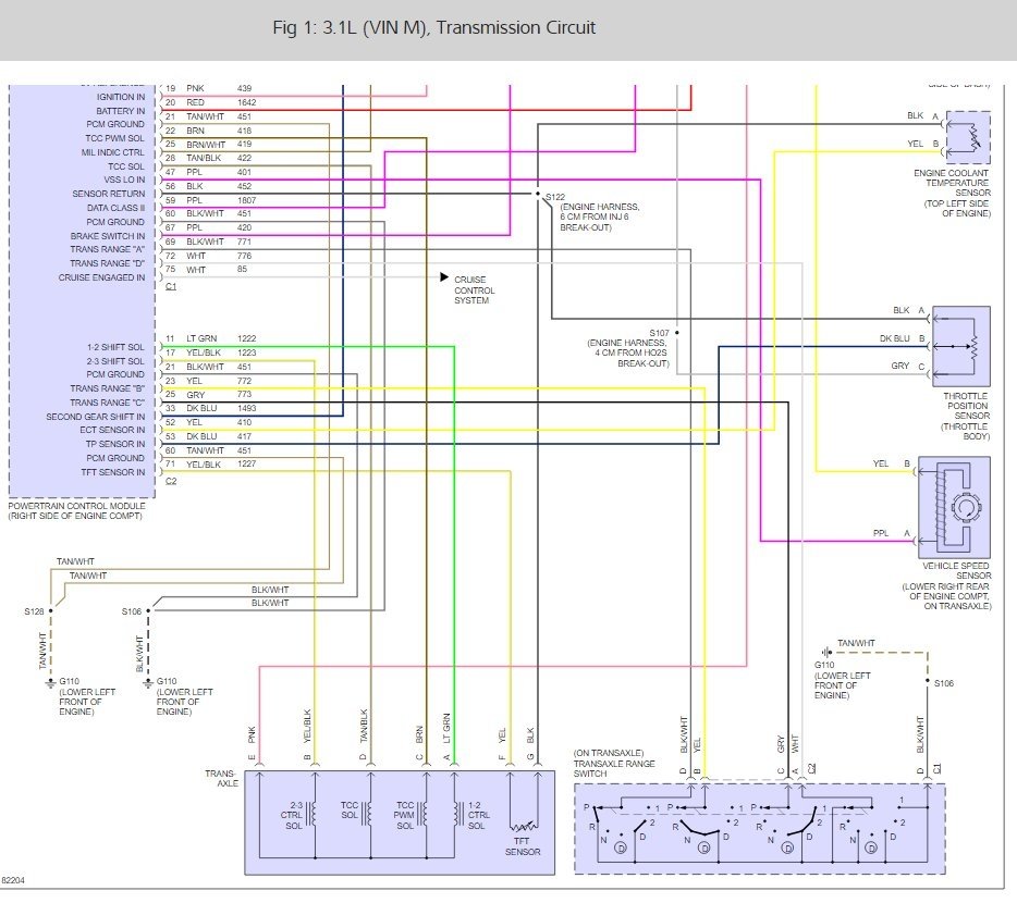

It sounds like you lost your reverse shift solenoid and it needs to be replaced. Here is a guide to help you
and the wiring diagrams (below) to make sure you replace the right one.
Also check the fuses
Please let us know what happens, we are interested to see what it is.
