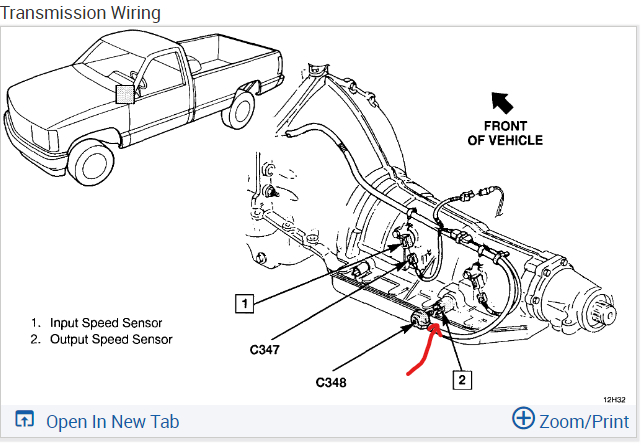

Lose / struggle power when turning left and won’t shift to 1st or 2nd by itself I can put it in 1st or 2nd manually but yeah, I’m lost. help please.

We need to run the codes first, but it sounds like the VSS sensor needs to be replaced.
Here is the location of the sensor and a guide to help you check the codes:
https://www.2carpros.com/articles/buick-cadillac-chevy-gmc-oldsmobile-pontiac-gm-1983-1995-obd1-code-definitions-and-retrieval-method

We had this problem in the shop not too long back, the speedometer works because there are two VSS sensors in the 4WD models. The sensor that runs the speedometer is in the transfer case.
