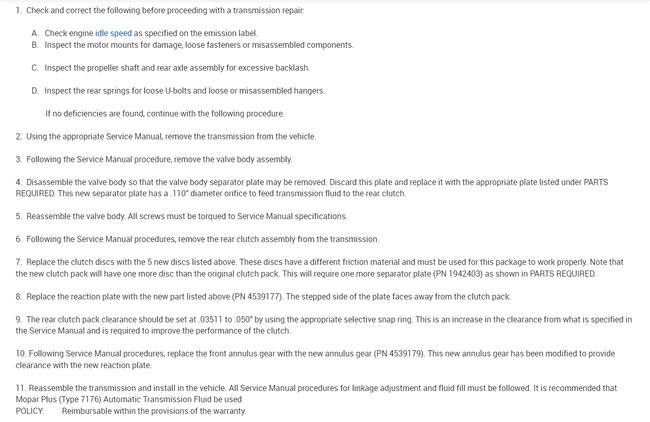

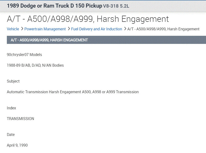

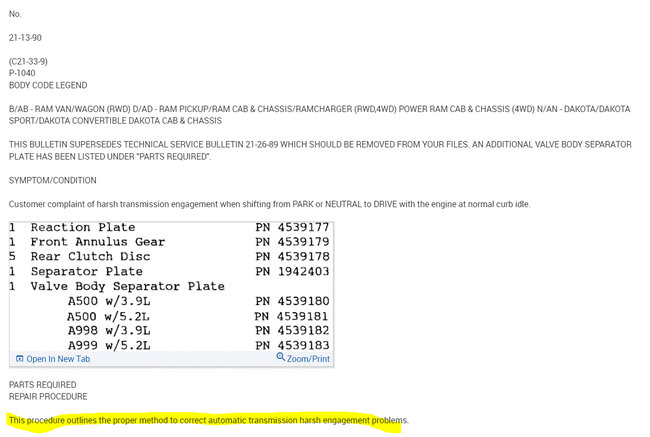

I don't want to say it's normal, because it isn't, but it was a common issue. Inside the transmission valve body is what is called a separator plate. The plate needed to be removed and replaced with a revised plate. The new separator plate has a .110" diameter orifice to feed transmission fluid to the rear clutch. Also, when this was done, the rear clutch plates were to be replaced, but I assume that was done with the rebuild.
If you look below, I attached a technical service bulletin related to this problem. I'm surprised a transmission shop wasn't aware of this. However, I guess it is getting older and they may not have seen one for some time.
Let me know if this helps.

Thank you for the information. Also, the shop that did transmission told me that this unit had three clutch plates and they added two more for a total of five. Would this have an effect on the hard shifting?
May 11, 2022 at 6:10 AM
  • 110,248 POSTS
Often times plates are added to reach tolerance. It really shouldn't be causing the hard shift.
You may want to consider contacting them to see if this is something they would consider fixing.
