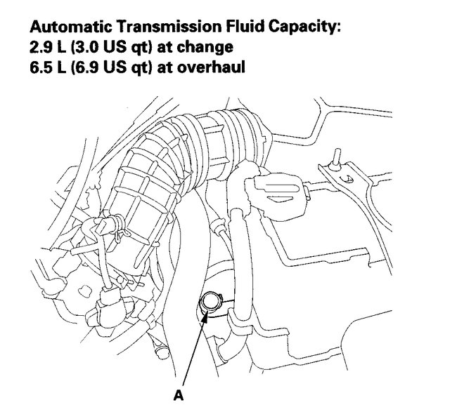

Here are the directions for servicing the transmission. At the end, it explains how to check fluid level. The attached pics correlate with the directions.
_________________________________________
2004 Honda Accord L4-2.4L
ATF Replacement
Vehicle Maintenance Fluids Fluid - A/T Service and Repair Removal and Replacement ATF Replacement
ATF REPLACEMENT
ATF Replacement
NOTE: Keep all foreign particles out of the transmission.
1. Bring the transmission up to normal operating temperature (the radiator fan comes on).
2. Park the vehicle on level ground, and turn the engine off.
pic 1
pic 2

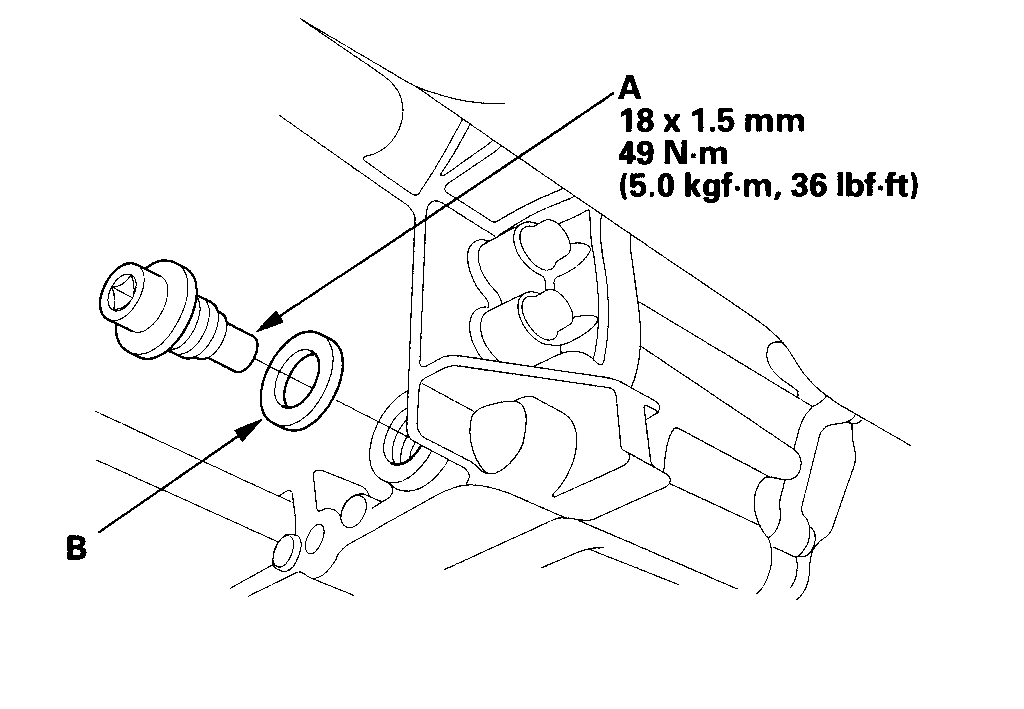

Note: Use a 3/8 drive ratchet for the drain plug.
3. Remove the drain plug (A), and drain the automatic transmission fluid (ATF). Then reinstall the drain plug with a new sealing washer (B).

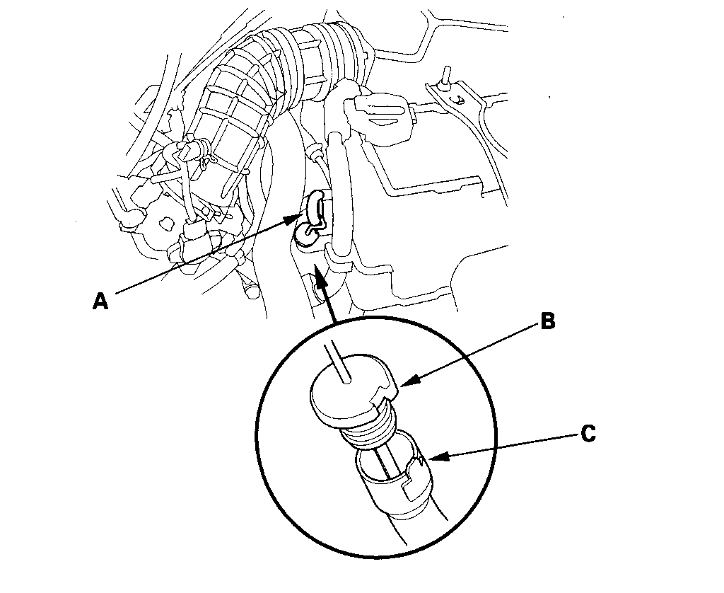

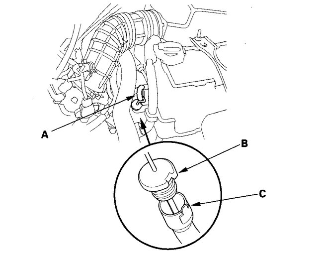

4. Remove the dipstick, and refill transmission with the recommended fluid amount through the opening of the dipstick guide pipe until the level reaches the upper mark on the dipstick. Always use Honda ATF DW-1 (ATF-Z1 has been replaced with ATF DW-1, Honda Service News Nov 2010) automatic transmission fluid (ATF). Using a non-Honda ATF can affect shift quality.
pic 4
5. Insert the dipstick (A) into the dipstick guide pipe aligning the cap (B) with the guide tab (C).
