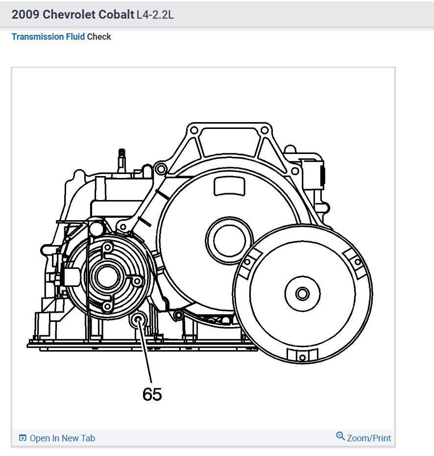

Loud whining noise coming from center front underneath of the car. Thought it might be a wheel bearing and took the wheel off and pushed on accelerator and car still made humming noise. It starts at around 20-25 mph and gets louder as you acclerate. What is it? Tried to check tranny fluid and there is no dipstick. Could it be something simple to fix. Too expensive to get a new transmission. Want to fix my car if it is inexpensive other wise I'll get rid of it.

It is like a stick shift style with a plug on the side. Check out the diagrams (Below). Please let us know if you need anything else to get the problem fixed.
AUTOMATIC TRANSMISSION FLUID
DEXRON-VI Automatic Transmission Fluid
Capacities
Bottom Pan Removal .................... 6.6 liters (7.0 quarts)
Complete Overhaul .................... 9.0 liters (9.5 quarts)
Dry Fill .................... 12.2 liters (12.9 quarts)
NOTE: All capacities are approximate. When adding, be sure to fill to the approximate level. Recheck fluid level after filling.

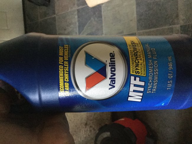

I was also wondering what kind of manual transmission fluid would be compatible with my car as I can’t seem to find a correct answer online. Weight/brand. Thank you. I have a Valvoline MTF but can’t seem to find the code as it does say it’s recommended for most Chrysler and GM models.
Jul 16, 2020 at 12:18 PM (Merged)
Good afternoon,
I attached the recommended fluid for the transmission.
