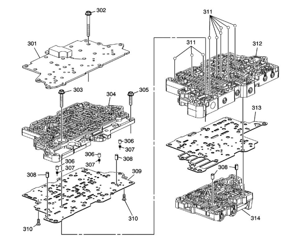

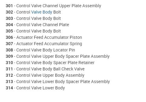

When starting the car for the first time in a day all is okay with shifting from park to reverse and to drive after a few hours of running errands. However, when the vehicle is hot for some reason when backing out of a parking space when shifting to drive it will not shift, everything else will works; reverse, park, and neutral, but trying to shift it in drive it will not take. almost as if the vehicle is on neutral. i have changed plates, cleaned the valve body and changed the pressure point on the TCM and still nothing. fluids are also good.

Good morning,
This sounds like a valve body issue.
Did you remove the valve body and take every valve out and make sure the bores are clean and not scored?
Also, the front pump. There is a pressure valve in the front pump that is a common failure.
Dec 23, 2021 at 10:26 PM

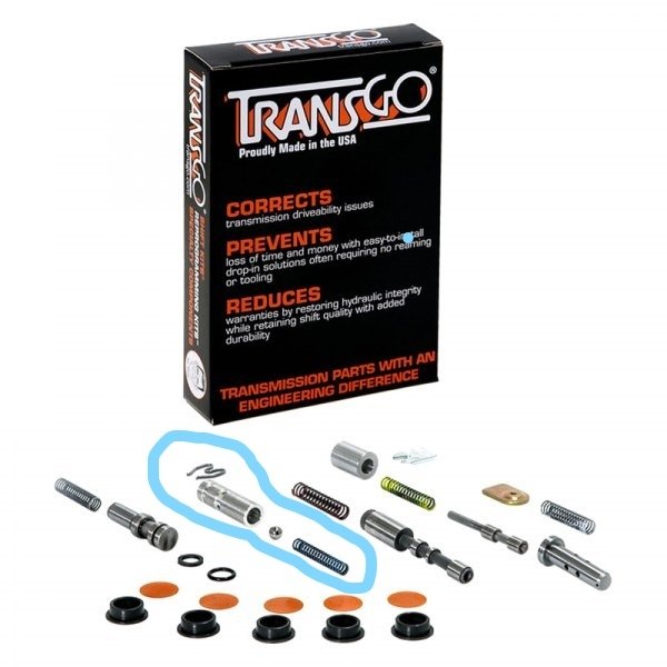

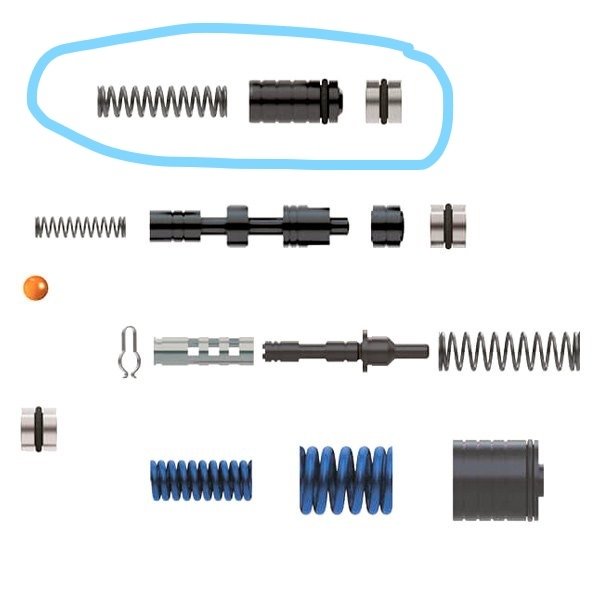

Yes, took valve body apart and bought a repair kit for it there was one valve that looked different that i left the way it was because didn't know if that needed to be changed. The first image is the piece that was already there and didn't know if i needed to change to the other on image 2. Also, when i tried to put tips with rubber ring it would go through kept getting stuck.

What did you do to get it to work and not bind?
Dec 23, 2021 at 11:00 PM
TADRIAN712
  • 5 POSTS
I left the other end tips on because they still worked, or maybe should i put in the new pieces, but I don't know what kind of grease to use to make valve move with new tips and rubber rings. a video on YouTube and the guy on there did it with no problem.
Dec 24, 2021 at 12:08 AM
This may be the actual problem.
We use Vaseline jelly. Good lubricant.
Dec 24, 2021 at 12:16 AM
