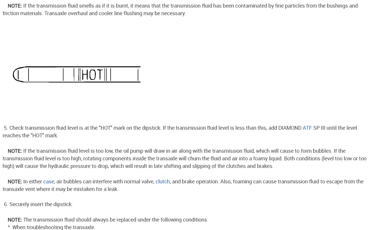

juddering when I'm pulling off sometimes pulls off very slowly before it accelerates. works fine once it's in motion.

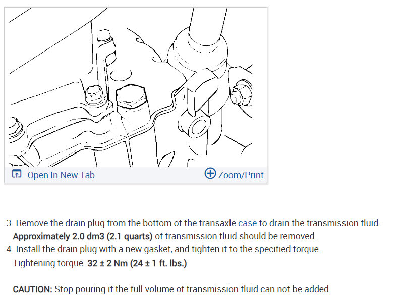

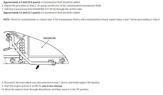

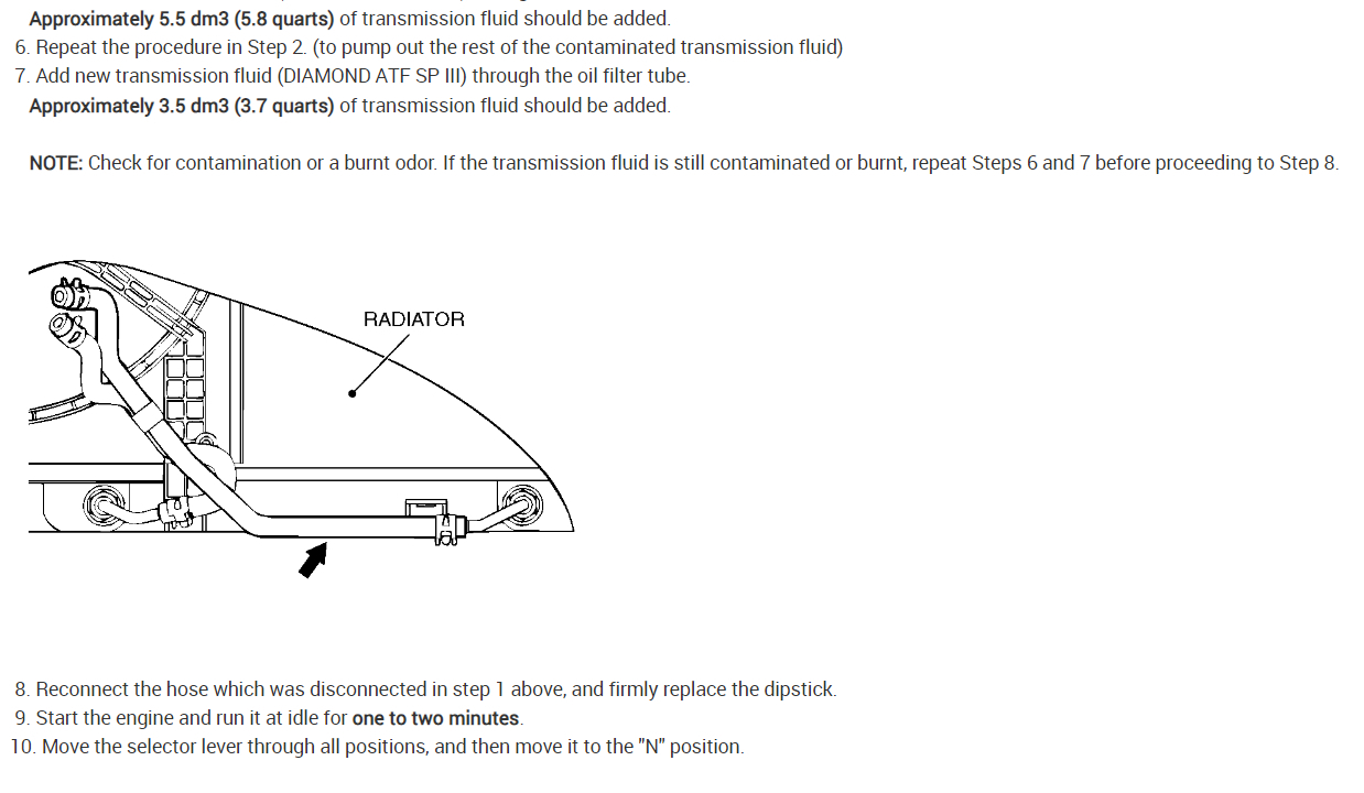

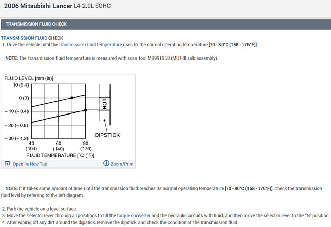

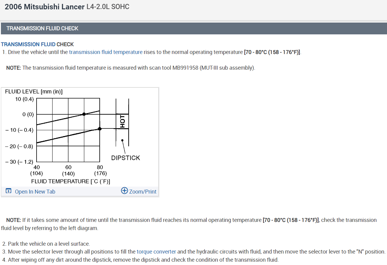

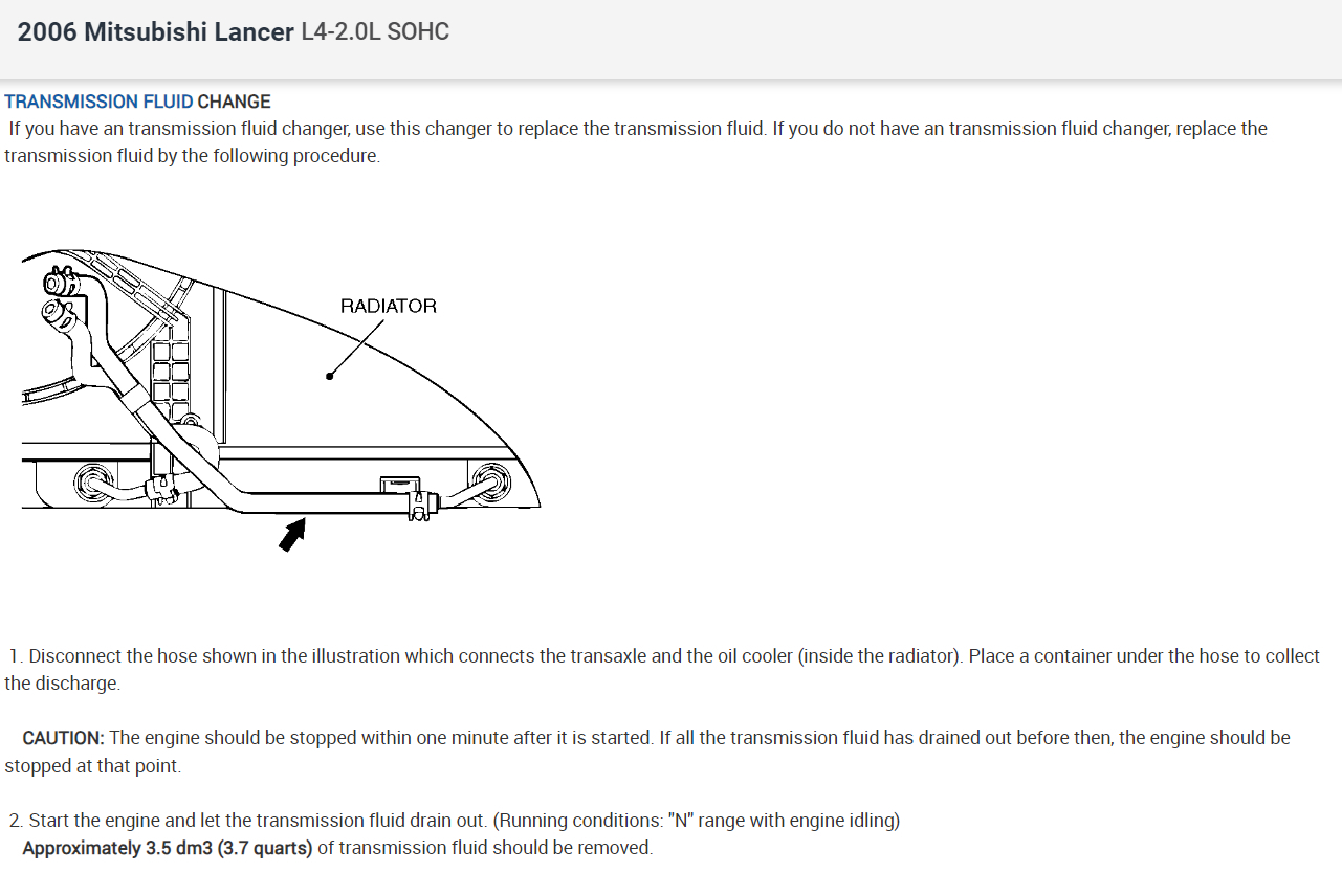

The first thing I would do is check the transmission fluid level and if it is burnt, I would do a fluid service. Here is a guide to help and I have included instructions in the images below for your car:
https://www.2carpros.com/articles/how-to-check-and-add-transmission-fluid
Fluid Types
Fluid Type .................... MITSUBISHI genuine ATF SP-III
Capacities
Automatic transmission .................... 7.7 L (8.1 qt)
Check out the images (below). Let us know what you find.
