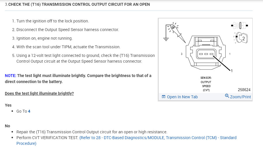

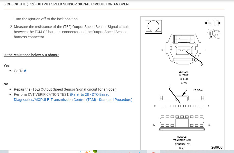

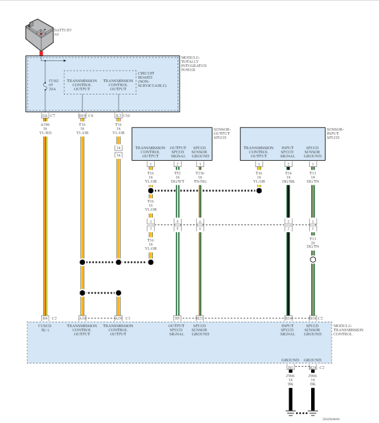

Code P0722 for output shaft sensor no signal, I have 12 volts and ground with the reference. I changed the output sensor, but it still won't shift. My primary and secondary pulled RPMs will not change. Does anyone know anything about this? I pulled the transmission pan and there were a small amount of shavings.

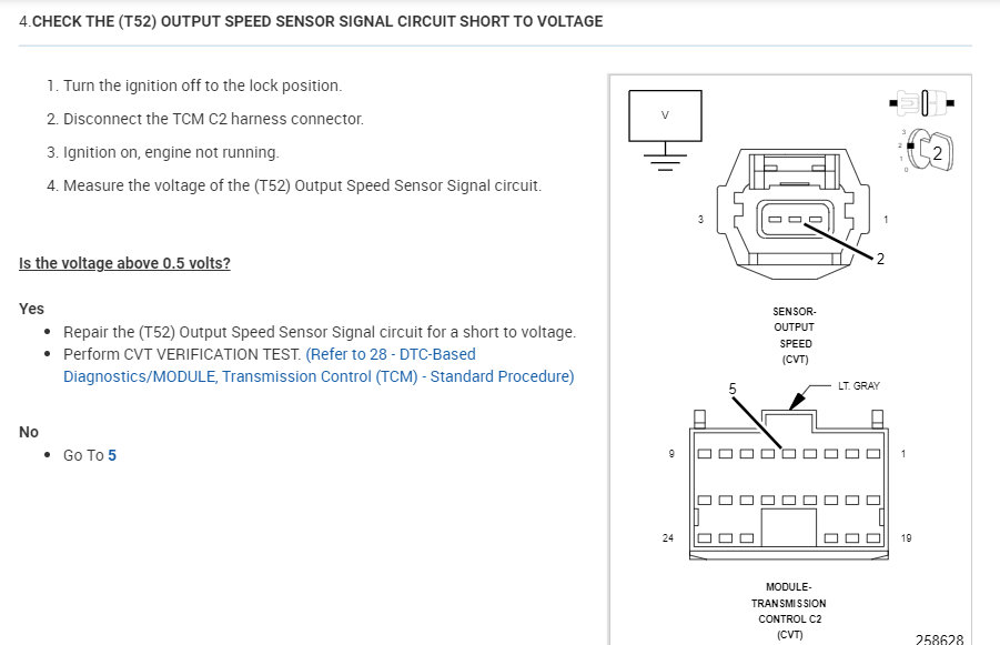

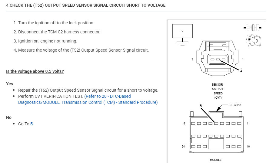

Where are you getting 12v? The speed sensor output voltage should be less than .05v when the vehicle isn't moving. To me, it sounds like you have a short to voltage.
Do me a favor. Perform the test in the attachment below. Let me know the results.

I have 12 volts for pin 3, .02 volts for pin 2 and ground at pin 1.

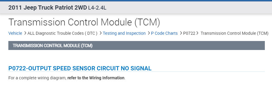

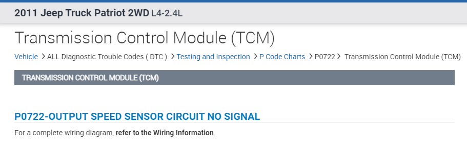

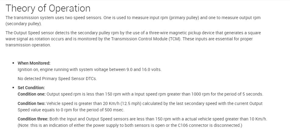

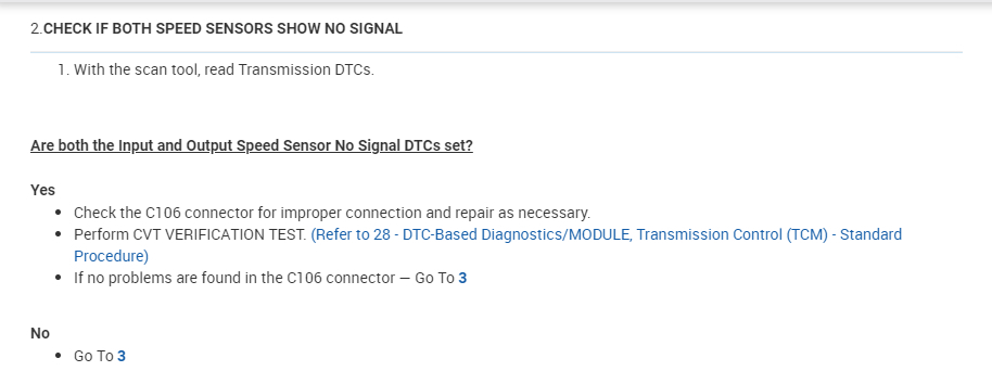

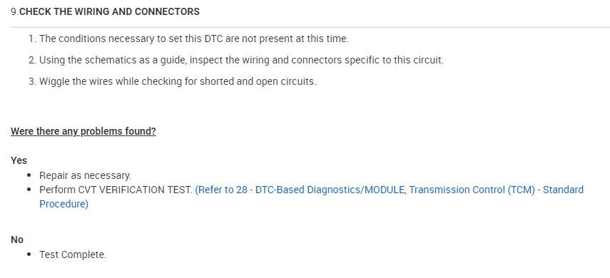

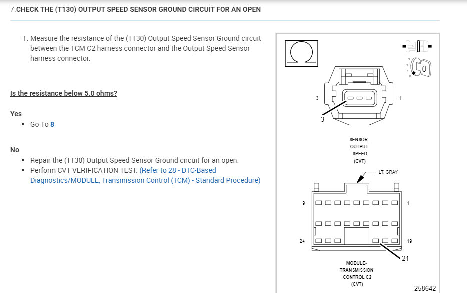

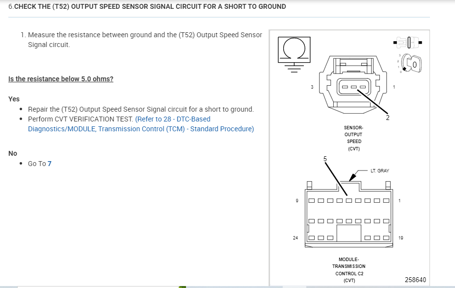

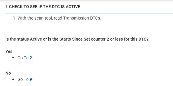

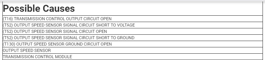

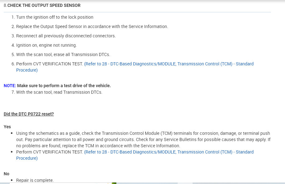

Okay, that sounds like everything is correct. What I've done is attach the diagnostics specific to this code. I am attaching all of them because I feel you have already done some of them.
Take a look through them and let me know if you have questions and what you find.
See pics below. Note: Each pic is a test. I have them in order and separated for you.

I have done all of the test everything tested correctly when I manually shift the transmission, I have found that going into 4th gear will result in whining and growling from the transmission. There is most likely issues internally with the transmission.

It's very possible. Is the P0722 the only code? Have you checked again recently? Also, is the sound you hear when shifting manually loud enough for you to record and upload so I can hear it?
