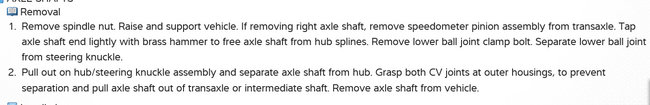

fluid leakage from transmission when axle is removed is normal. if it is a transmission problem have a transmission professional look at it. if you are replacing axle, see picture. install is pretty much reverse of removal.
