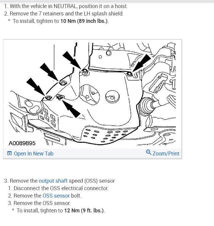

The car had been hit, front center, replaced hood, right fender. starts up put in drive, no go, drop to low engages, went for ride, got going shifted 2nd, kept going to about 45 mph, shifted to drive, got up to 60 plus. Okay, slowed down have no drive, second weak, low sort of, went to put on lift in low gear barley got on/ slipping.

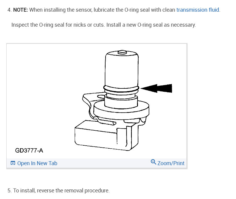

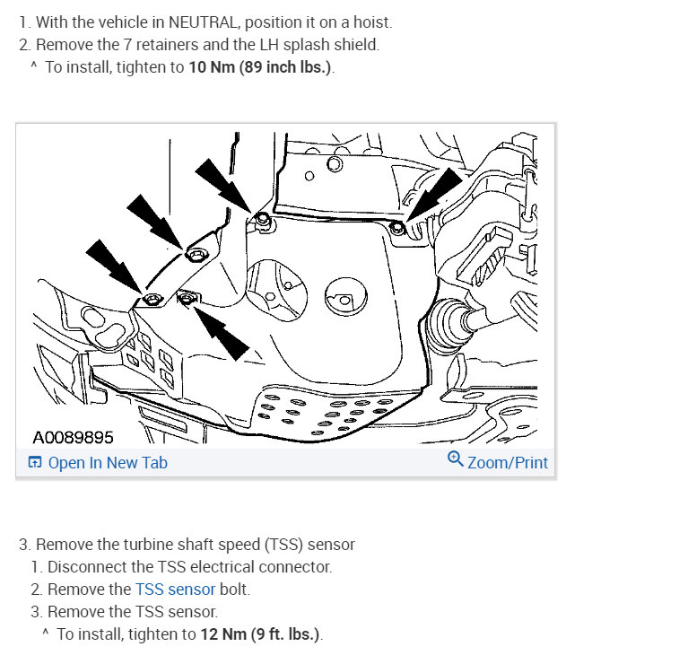

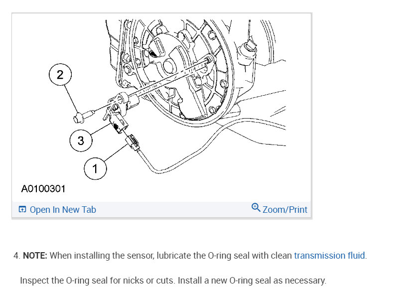

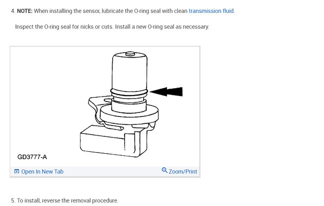

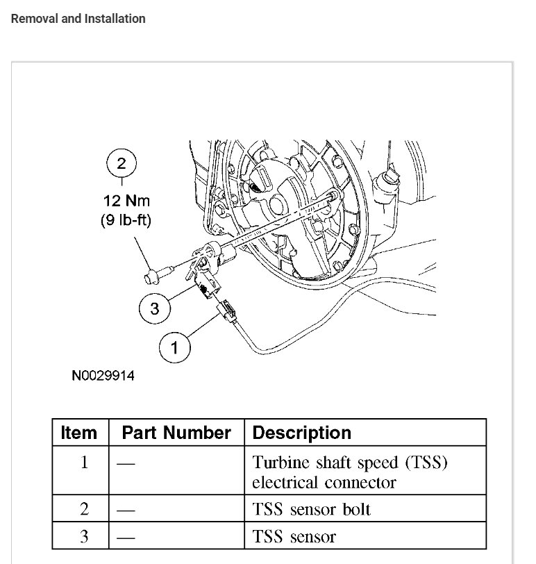

Does the speedometer work? If so, it sounds like the input shaft sensor is unplugged or not working. I would check the fluid level and then run the codes; these guides can help:
https://www.2carpros.com/articles/how-to-check-and-add-transmission-fluid
and

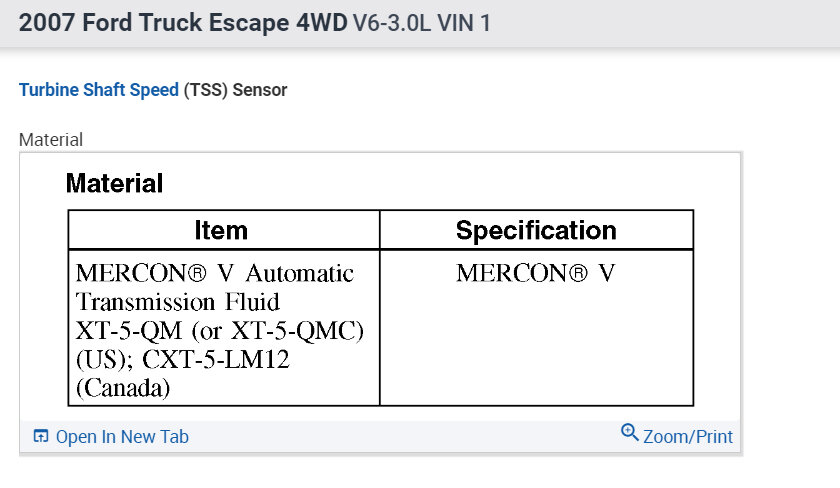

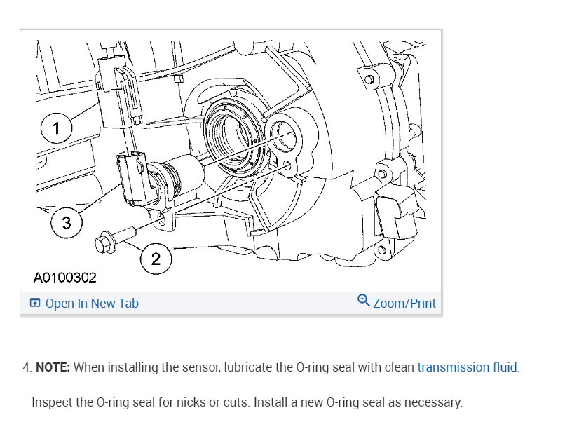

Here is how to replace the input shaft sensor in case you need it. Check out the images (below). Please let us know what happens.

i changed the input shaft sensor in the 2007 Ford Escape, now i have only sort of reverse slips bad in forward gears, service 4x4 came on said disabled then cleared, then same again, still no drive.

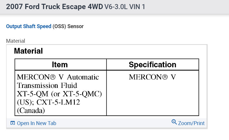

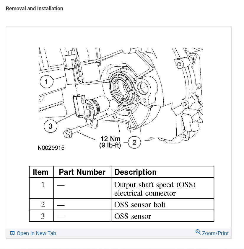

Output shaft, no signal? So does the speedometer work? If not, I would check the output shaft speed sensor to make sure it is connected and if so, I would replace the sensor. Here is the location. Check out the images (below). Please let us know what you find.

i changed the output shaft sensor, i can feel it go into low and second, when i step on the pedal it starts to move, then nothing but rev. fluids good, i tried to idle around some, and the 4x4 light started to flash, reverse is moving me. i think there is an ECM code.
