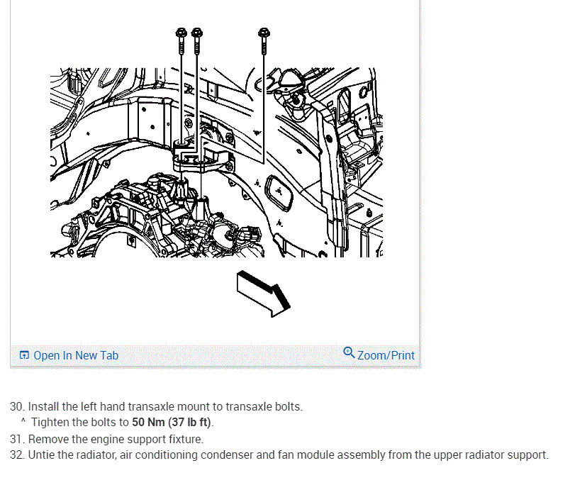

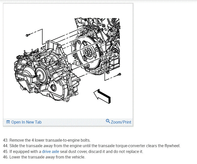

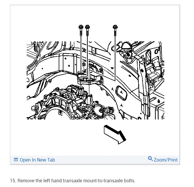

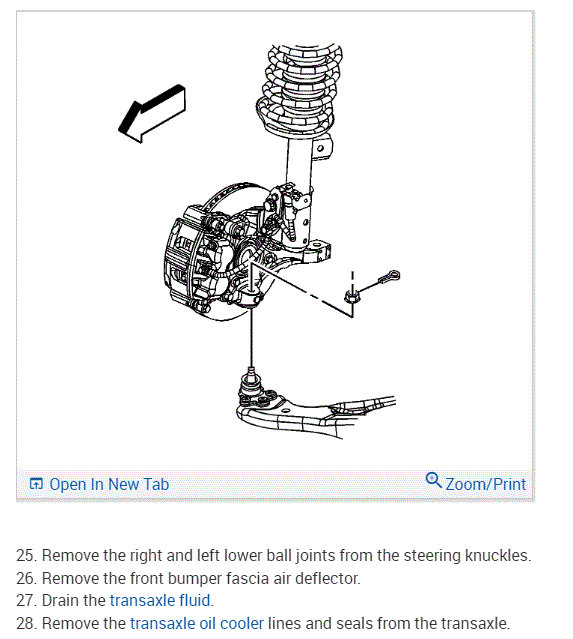

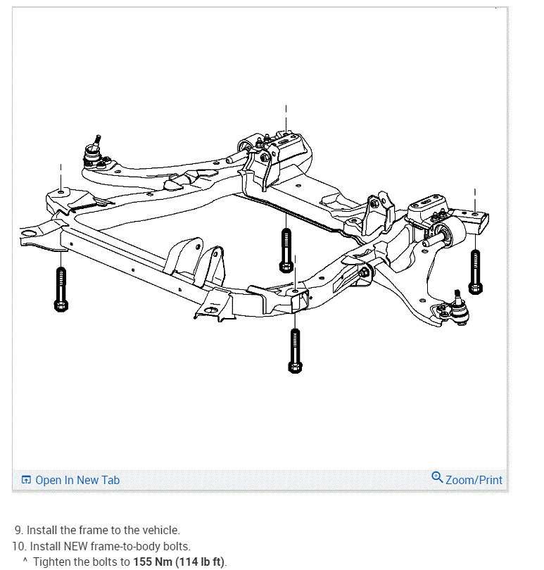

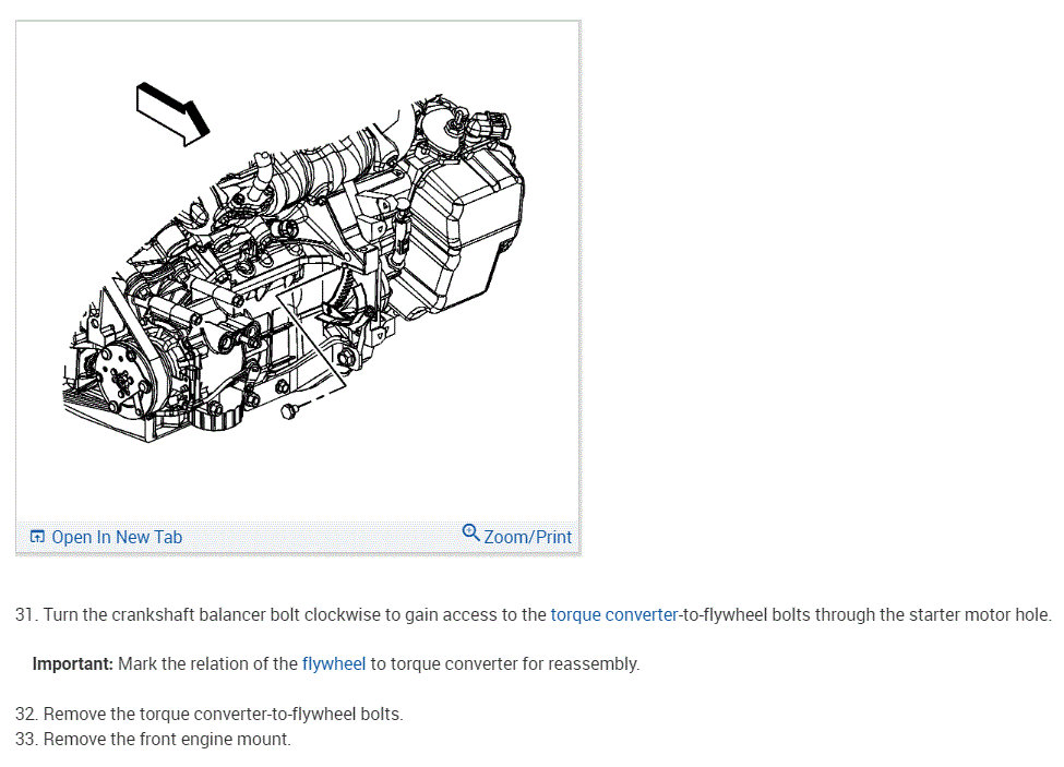

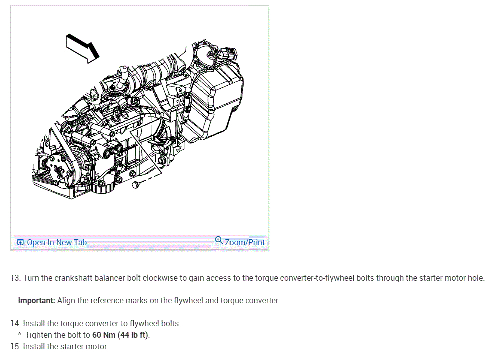

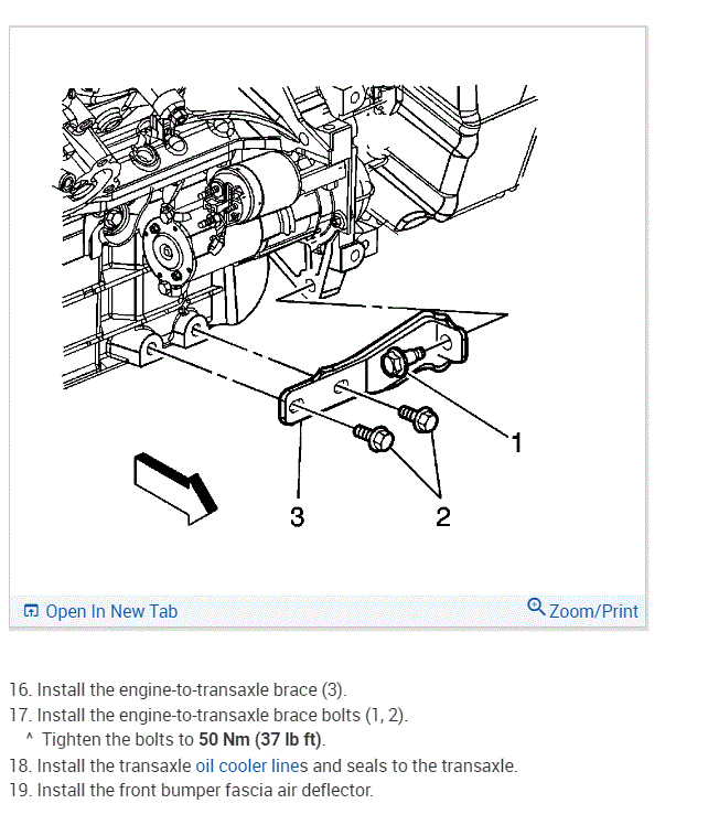

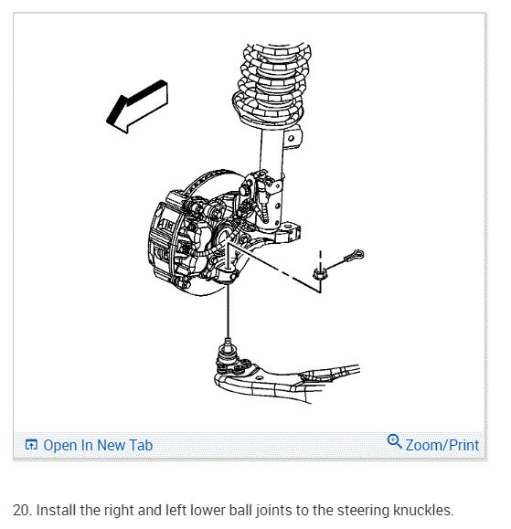

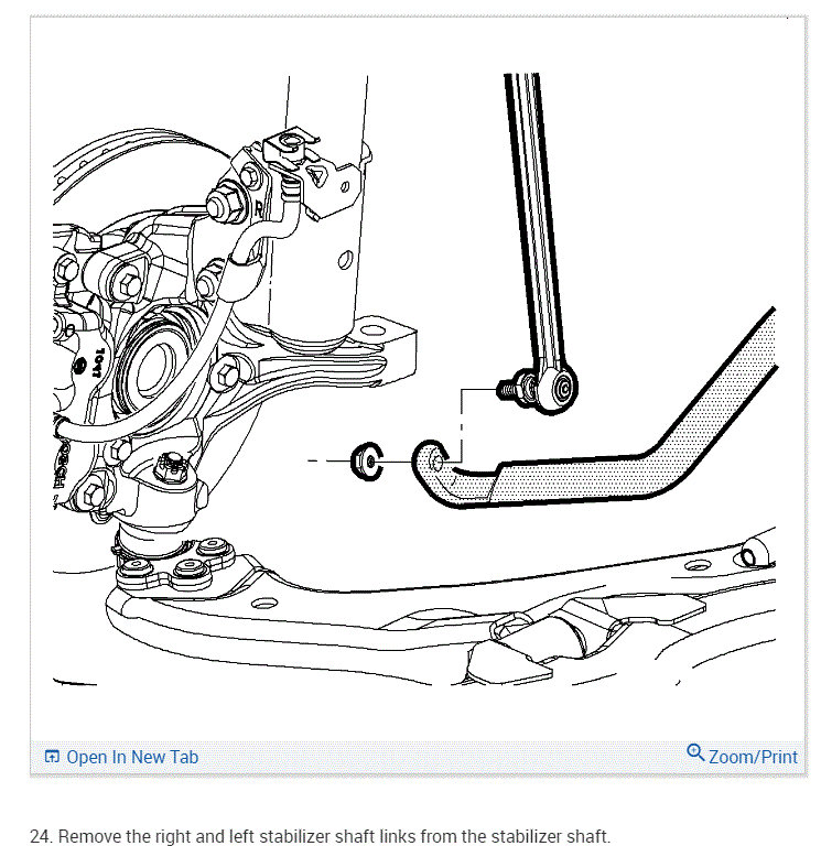

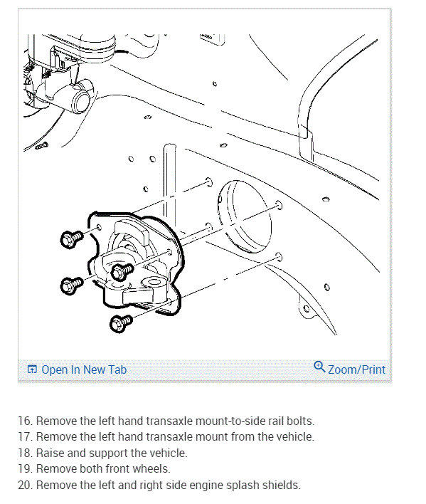

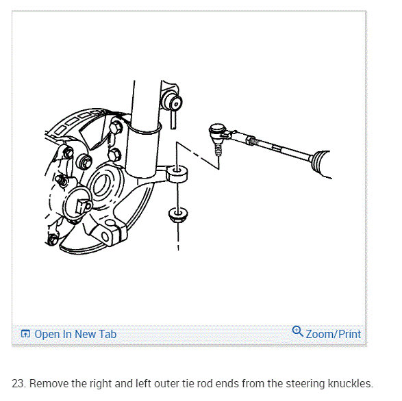

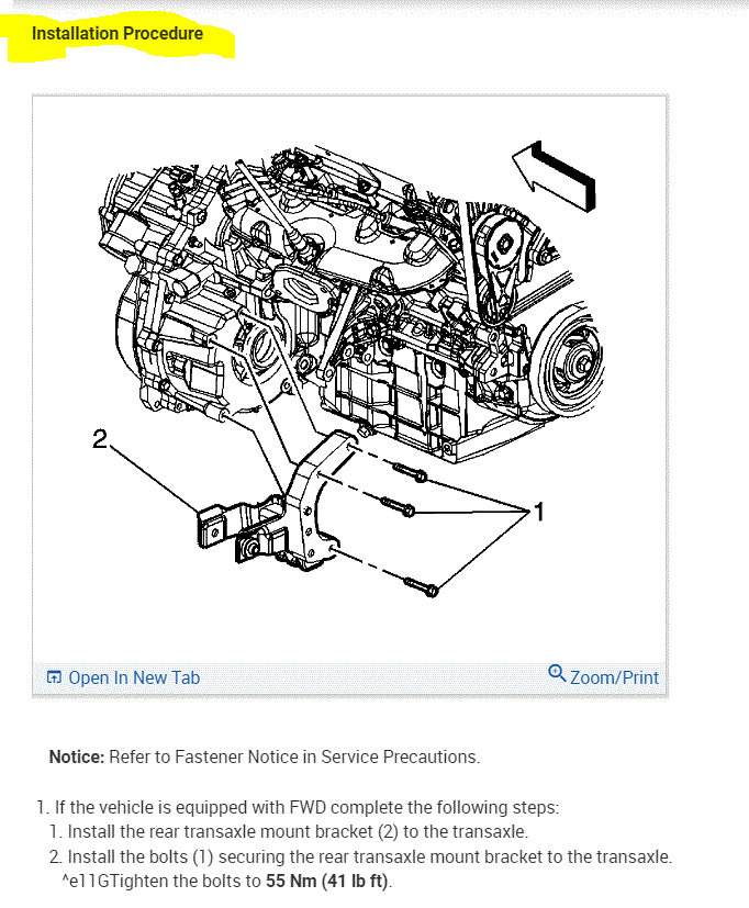

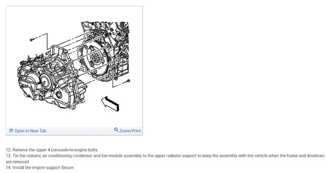

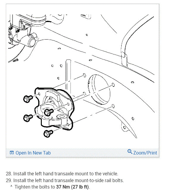

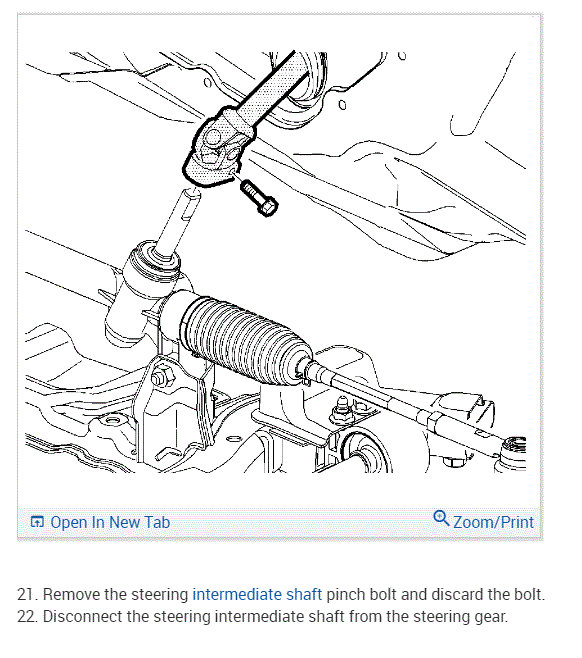

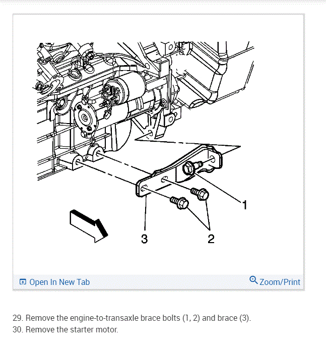

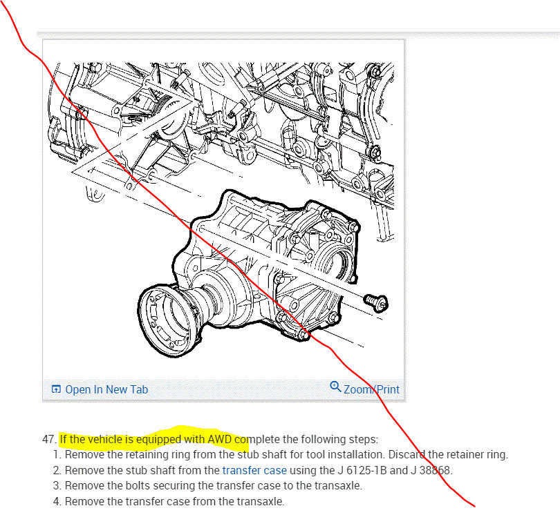

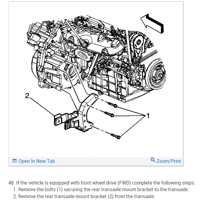

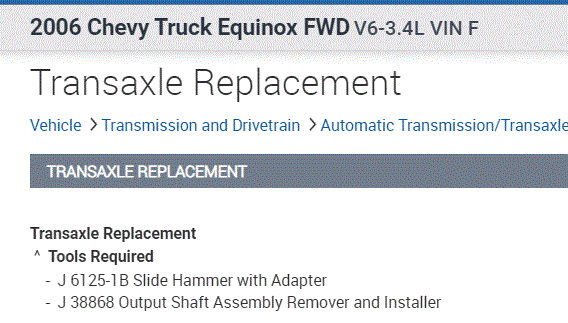

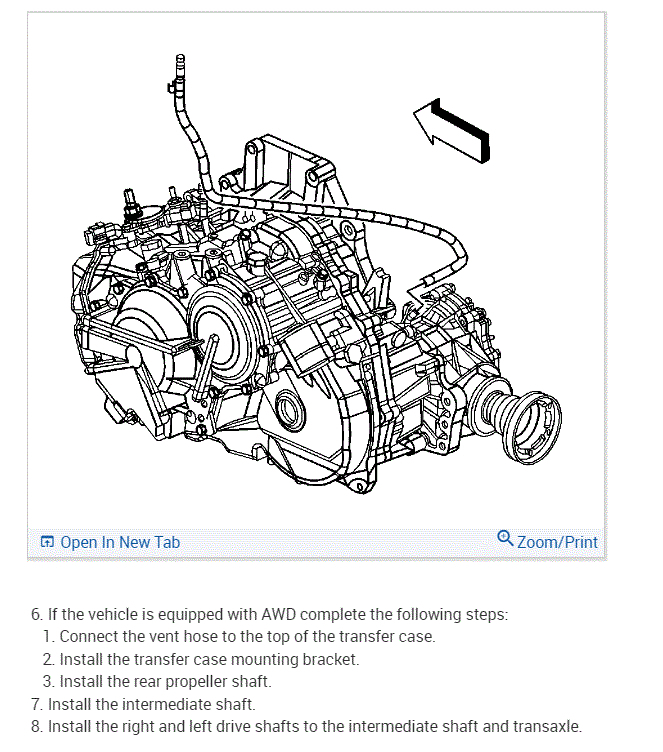

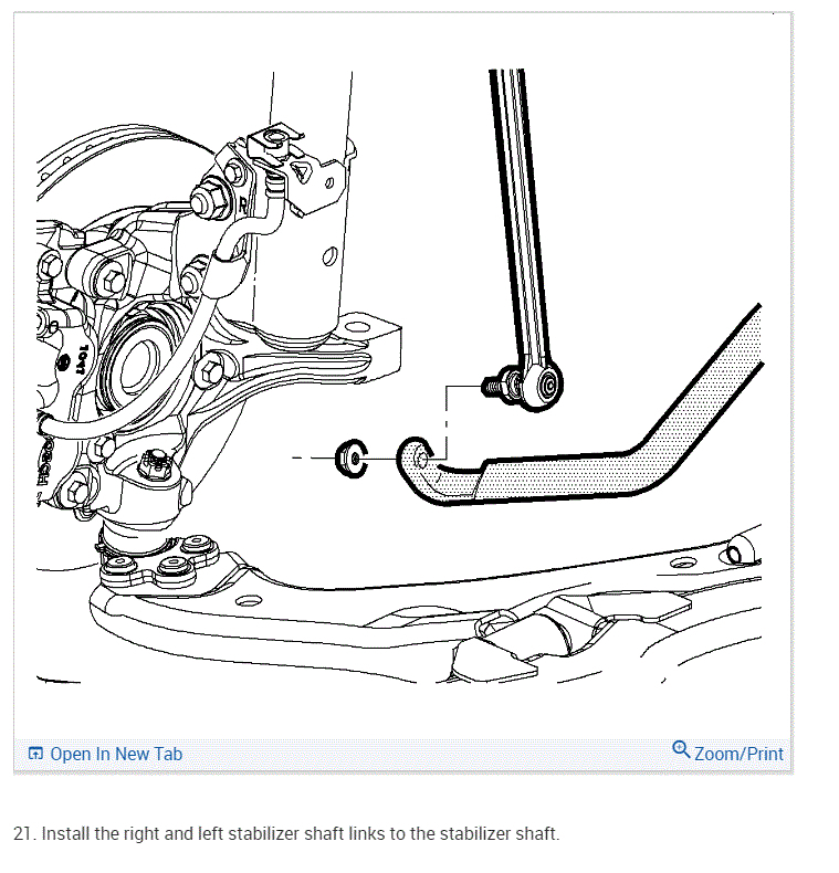

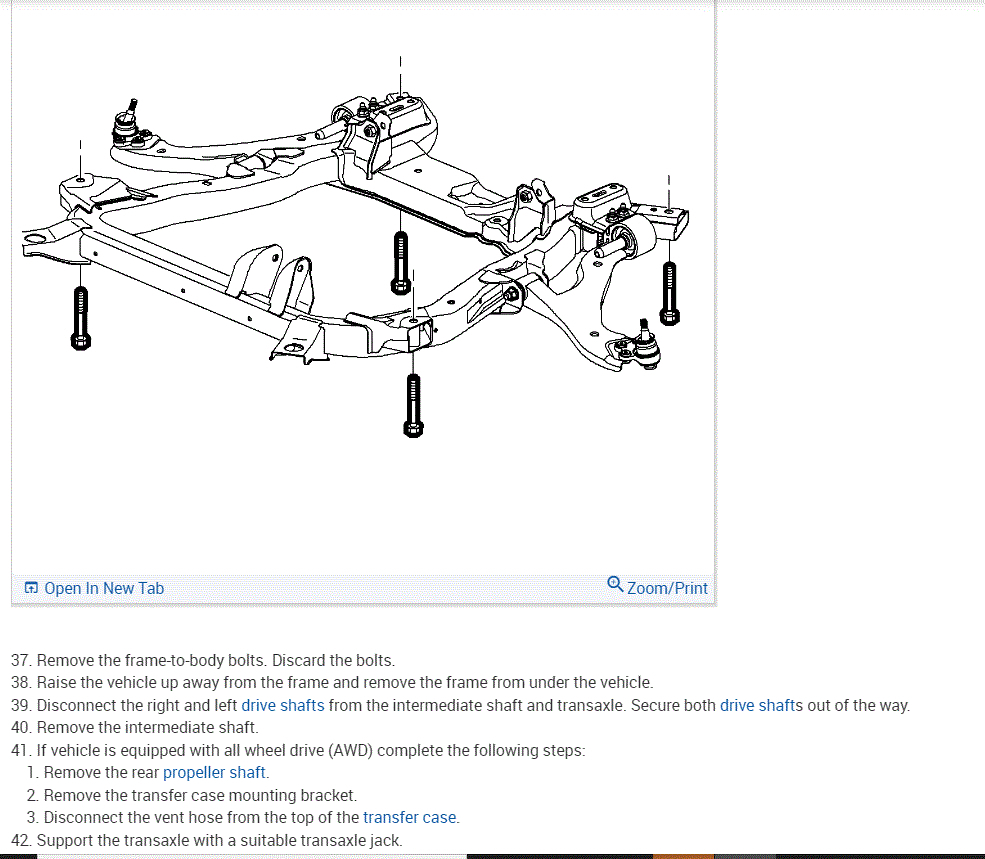

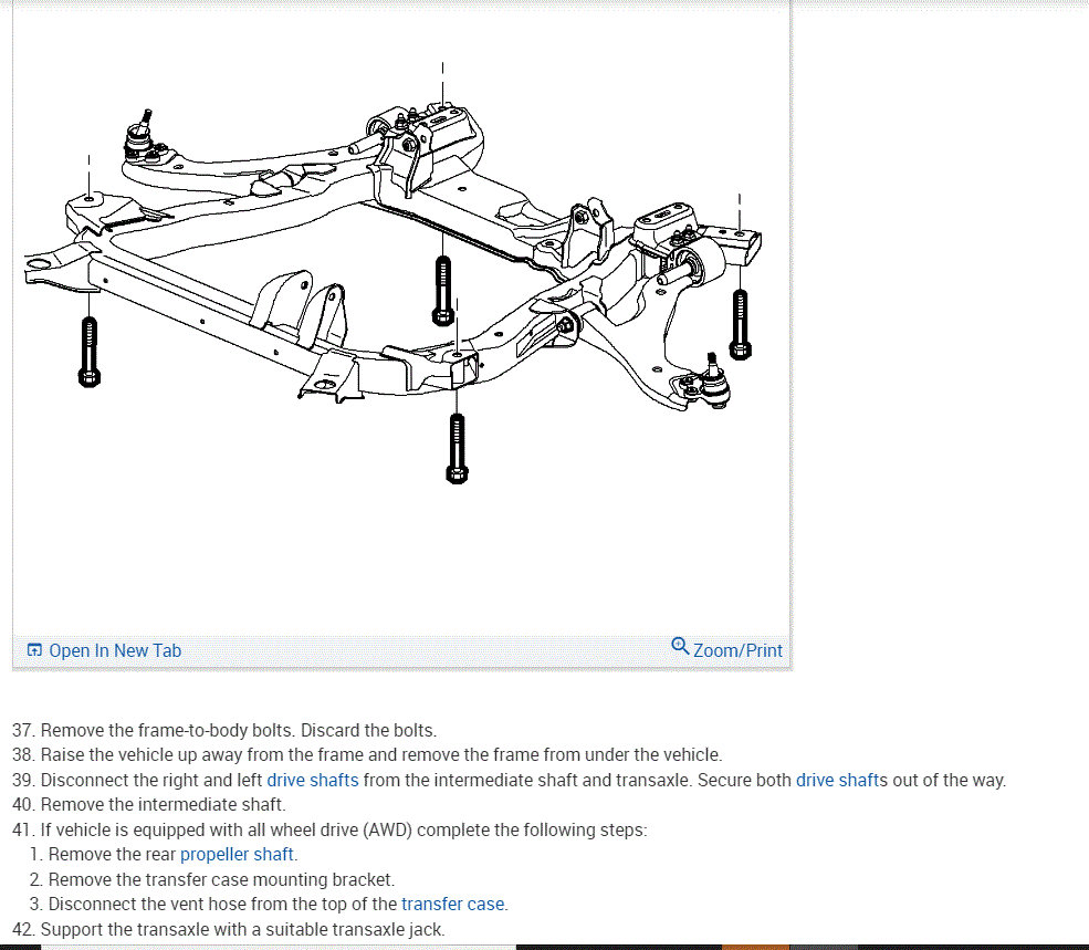

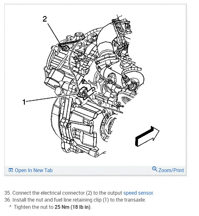

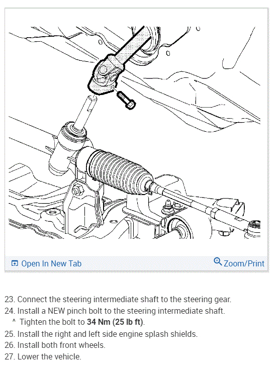

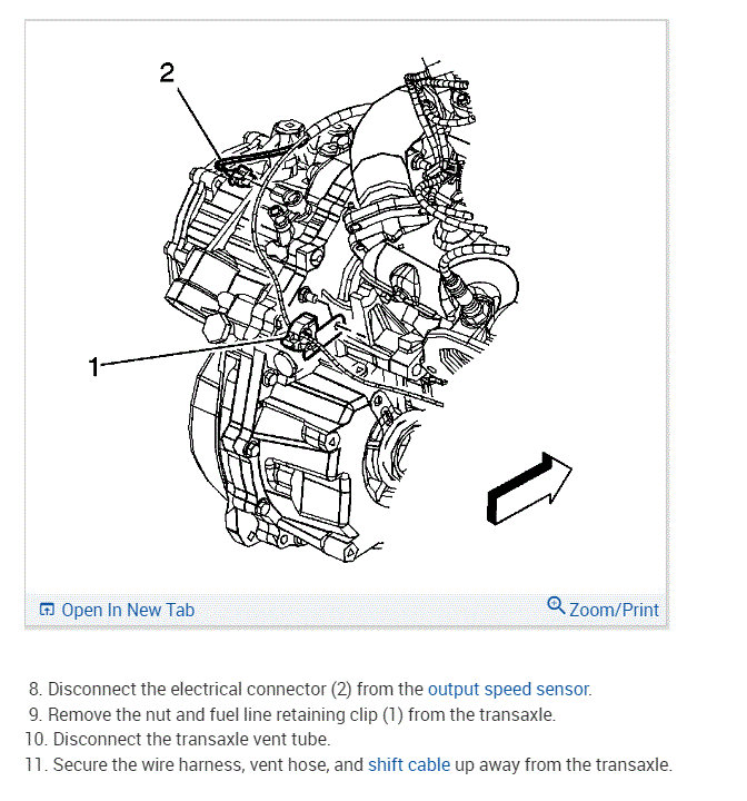

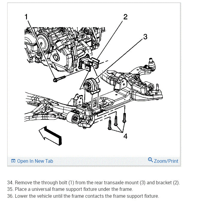

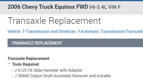

Requesting instructions for removal and replacement of transmission in the vehicle listed above.
Jun 2, 2022 at 4:01 AM
  • 110,240 POSTS

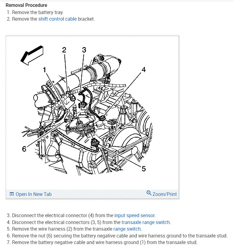

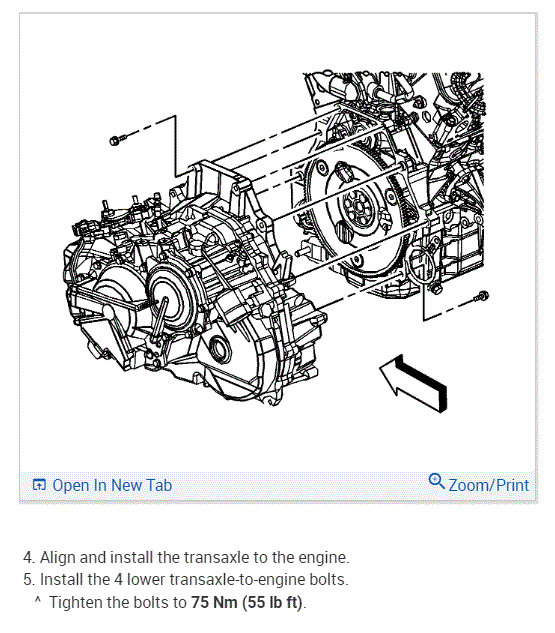

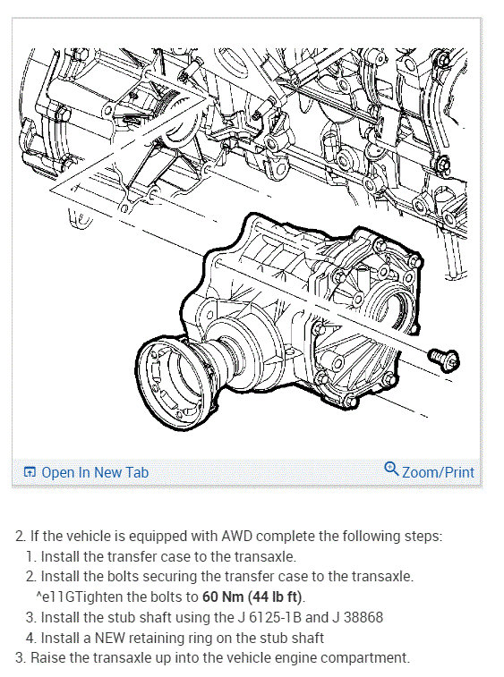

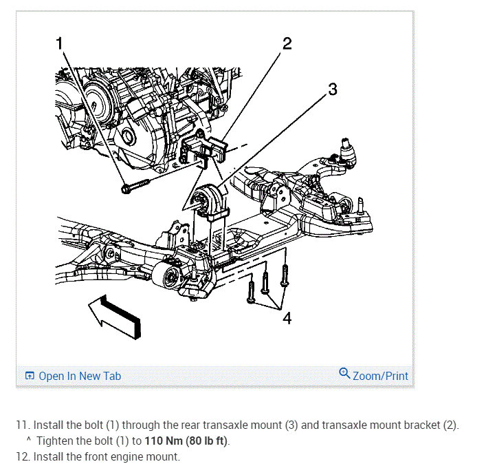

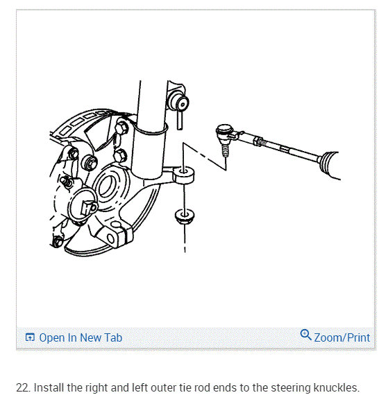

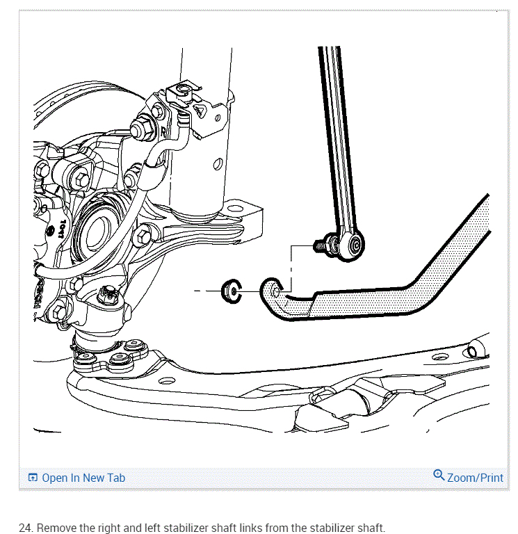

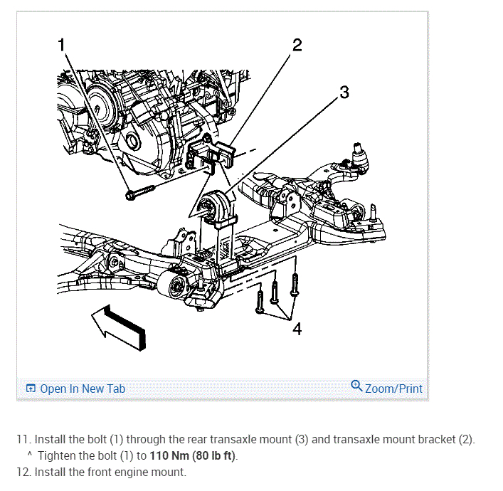

This is a big job. The cradle will need to be removed. As far as the directions, there is one set for both a 2wd and 4wd vehicle.
When you come to the 4wd info, you should be able to simply bypass them.
If you look below, the directions for both the removal and replacement of the transmission. Take a look through them and let me know if you have questions.

What size are the top bell housing bolts? Can't seem to find the right tool to remove them. Are they a hex head?
Jun 3, 2022 at 1:05 AM
  • 110,240 POSTS
Hi:,
They should be a hex-head bolt. The manual doesn't provide the size, and I always make size determinations when it's in front of me. If I had to guess, I would suspect them to be around 18mm. That should get you at least close.
Let me know what you find.
Jun 3, 2022 at 12:57 PM
JACKIECHIDERS76
Thanks..the two top bell housing bolts were a T55..thanks again for all the info!

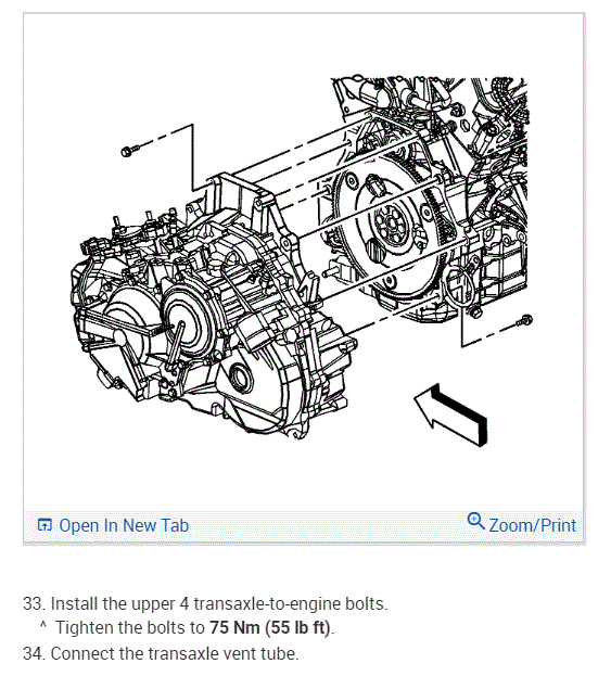

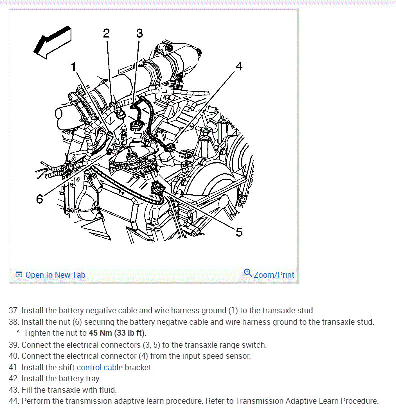

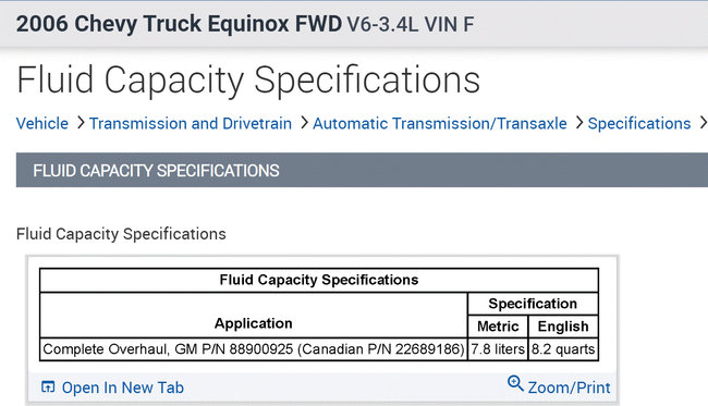

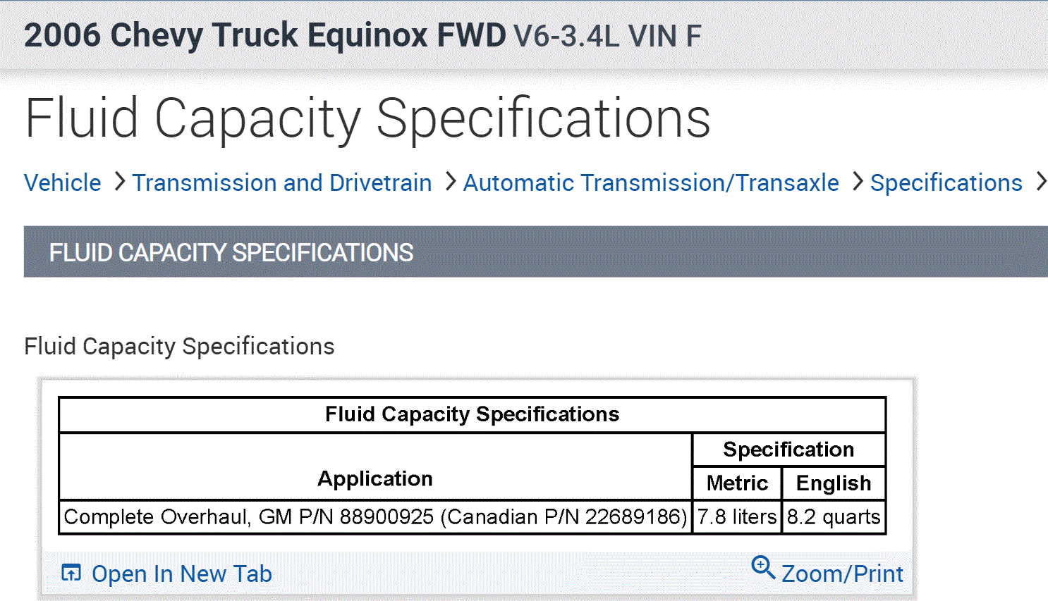

Have old transmission out and new ready to go in. What is the correct amount of transmission fluid for this application?
Jun 4, 2022 at 8:45 AM
  • 110,240 POSTS
If the system is totally empty, it holds 8.2 quarts. Keep in mind that if you are using the old torque converter, it holds fluid in it.
If you look below, I provided the info from the manual for you.
I hope this helps.
