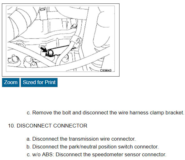

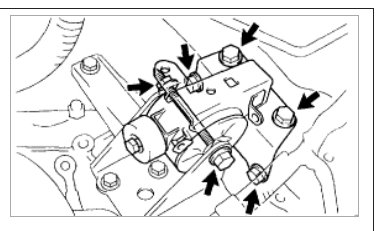

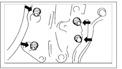

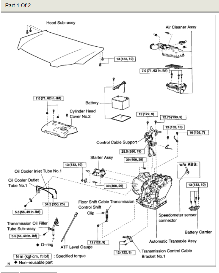

My reverse gear will not engage when hot. I changed the transmission oil but it persists. What can I do help!
May 25, 2018 at 5:12 PM
Experienced Mechanic
52,796 POSTS
Good morning.
It sounds like you have either a failed seal or drum in the transmission. This is an internal failure.
What did the condition of the fluid look like when you changed it?
May 26, 2021 at 11:15 AM
EDMUND ANIEKWE
MEMBER
2 POSTS
The transmission fluid was dark.
55,697 POSTS

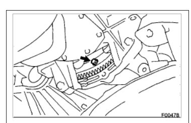

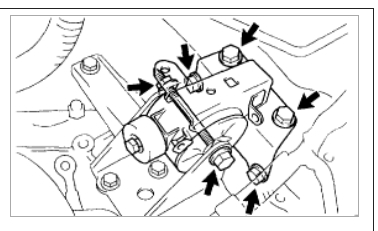

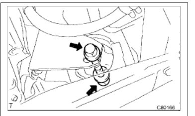

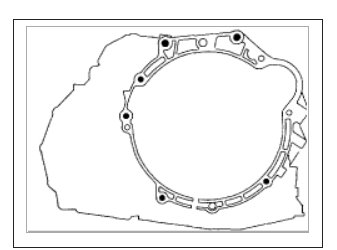

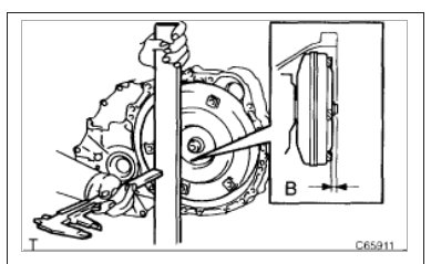

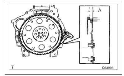

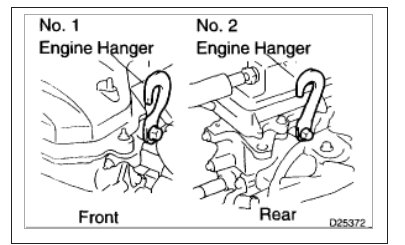

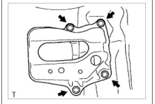

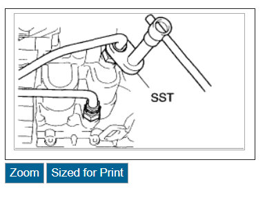

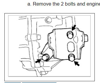

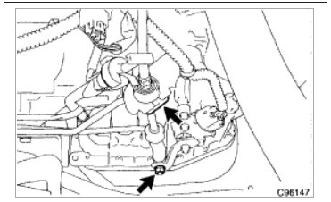

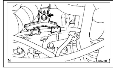

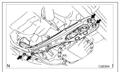

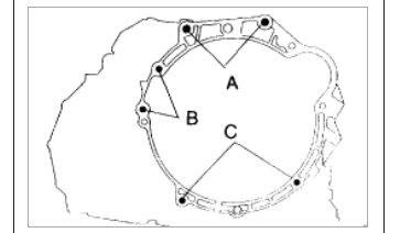

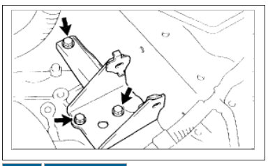

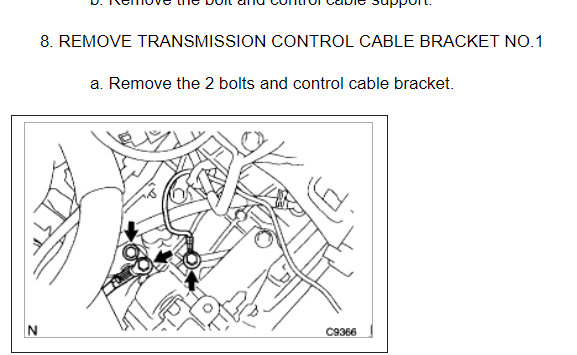

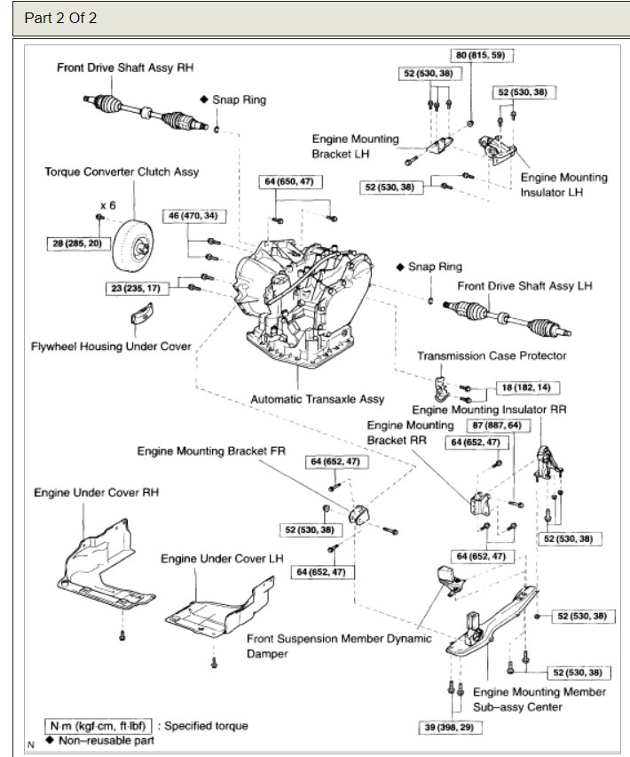

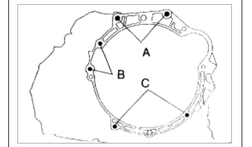

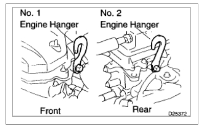

Here is how to change the transmission out. Check out the diagrams below. Let us know what happens and please upload pictures or videos of the problem.
Images (Click to enlarge)
