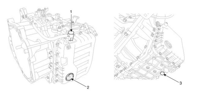

Had to jump daughter's car this morning. She drove to the store and turned the car off. When she got back it in, it started but wouldn't let her put it in reverse. Thoughts? Transmission fluid?

I would check the fluid level first, here is how this transmission uses a see through eye to check the fluid level
Fluid Types
Updated by TSB 13-AT-011
Automatic Transmission Fluid Type
Type .................... SP4-M
Capacities
Automatic Transaxle Fluid
Capacity .................... 7.71 qt (7.3L)
This guide can help as well,
If the fluid level is okay we should scan the car, you can get a CAN scanner (Controller Area Network) from Amazon for about $30.00 here is a video to show you how.

Check out the images (below). Please let us know what you find. We are interested to see what it is.
