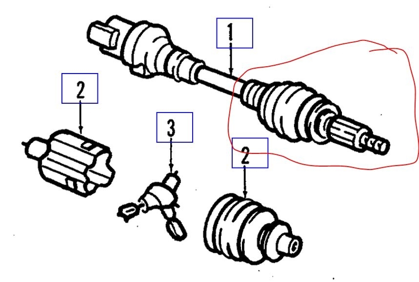

This sounds like you have a failed axle shaft going from the transmission to the wheels.
https://www.2carpros.com/articles/symptoms-of-a-bad-cv-axle-joint
https://www.2carpros.com/articles/replace-cv-axle
I would look at these axles for damage. The outer CV joint is the most common failure in the axles. If we are right, and it sounds like we are, I would replace both sides.

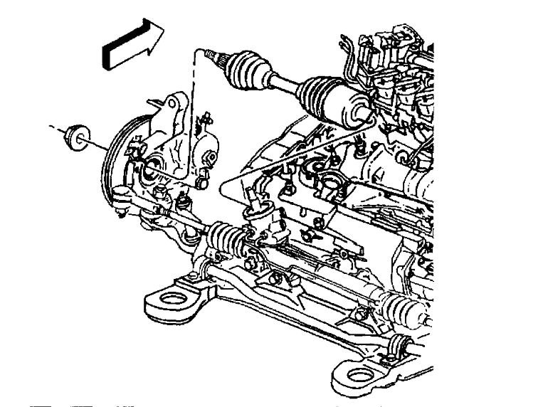

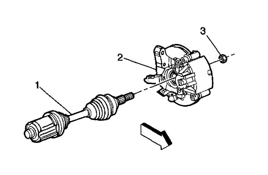

Front Wheel Drive Shaft Replacement
Tools Required
J 2619-01 Slide Hammer
J 29794 Extension
J 33008-A Wheel Drive Shaft Remover
J 42129 Hub Spindle Remover
Removal Procedure

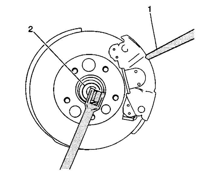

1. Raise and support the vehicle. Refer to Vehicle Lifting.
2. Remove the tire and wheel assembly.
3. Remove the engine splash shield.
4. Insert a drift or punch (1) through the brake caliper and into the brake rotor in order to prevent the wheel hub and bearing from turning.
5. Remove the wheel drive shaft spindle nut (2).
6. Remove the stabilizer shaft link.
7. Disconnect the outer tie rod end from the steering knuckle. Do NOT loosen the tie rod end jam nut.
Important: Be sure that the wheel speed sensor wiring harness is repositioned away from the ball joint after disconnecting the electrical connector from the sensor.
8. Disconnect the electrical connector from the wheel speed sensor and reposition the wiring harness away from the ball joint.
9. Disconnect the lower ball joint from the steering knuckle.
10. Install the J 42129 onto the wheel hub and secure with wheel nuts.
Important: Be sure to support the wheel drive shaft until it is fully removed from the vehicle.
11. Using the J 42129, disengage the wheel drive shaft from the wheel hub and bearing and support the wheel drive shaft.
12. Assemble the J 33008-A, the J 29794, and the J 2619-01.
13. Using the J 33008-A, the J 29794, and the J2619-01, disengage the wheel drive shaft from the transaxle.
14. Remove the wheel drive shaft from the vehicle.

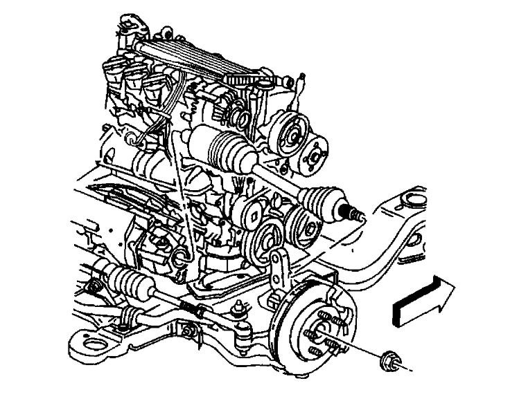

Installation Procedure
1. Install the wheel drive shaft to the transaxle.
2. Verify that the wheel drive shaft is properly engaged to the transaxle by grasping the inner tripot housing and pulling outward. Do not pull on the wheel drive shaft bar. The wheel drive shaft will remain firmly in place when properly engaged.
3. Install the wheel drive shaft to the hub and bearing (2).
4. Connect the ball joint to the steering knuckle.
5. Connect the wheel speed sensor electrical connector.
6. Install the stabilizer shaft link. Refer Stabilizer Shaft Link Replacement to in Front Suspension.
