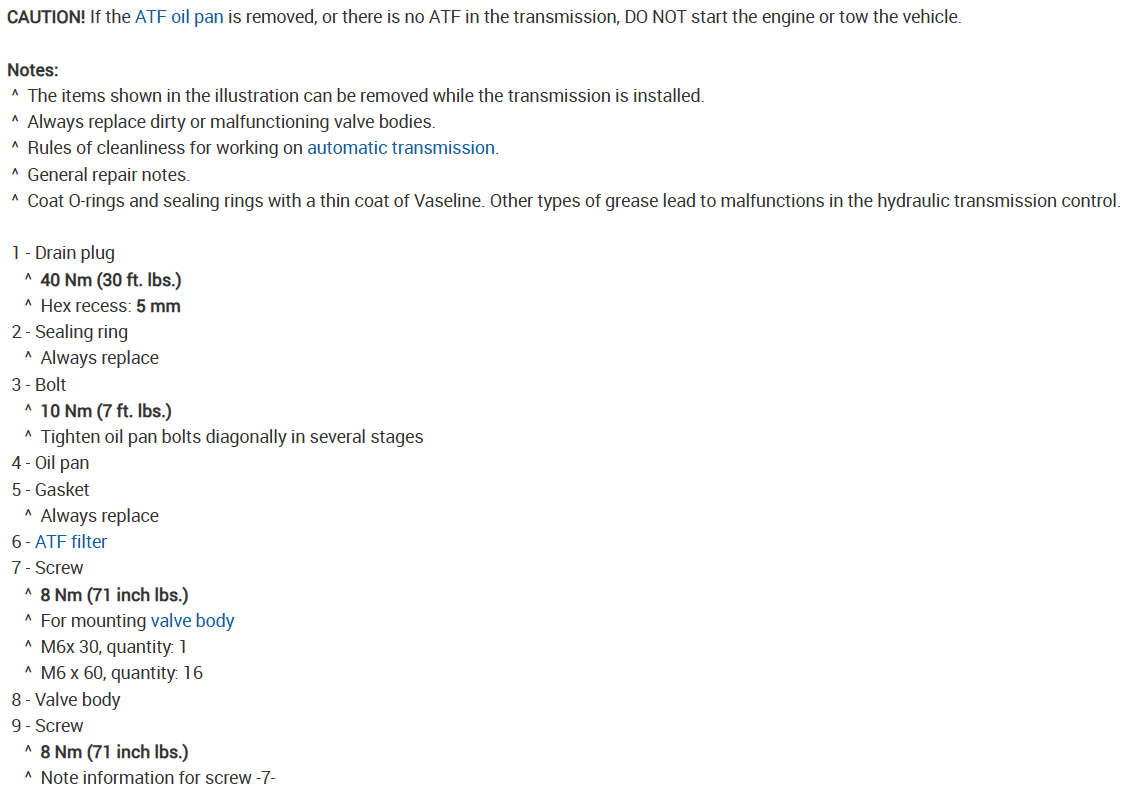

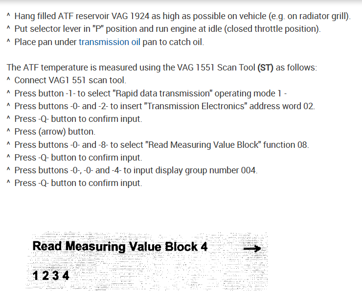

Car shifts good in reverse and drive it shudders at 35 to 40 mph. Will shift good in drive 3 and 4 with on shuddering.
Nov 11, 2024 at 4:43 PM
  • 55,402 POSTS

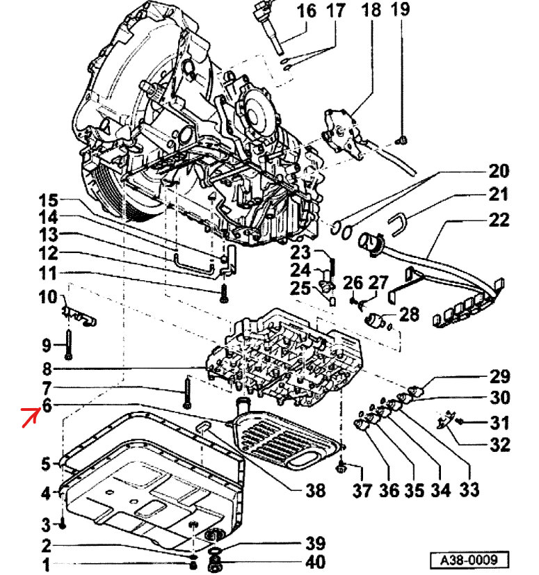

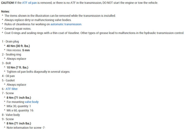

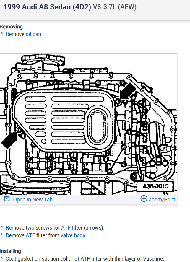

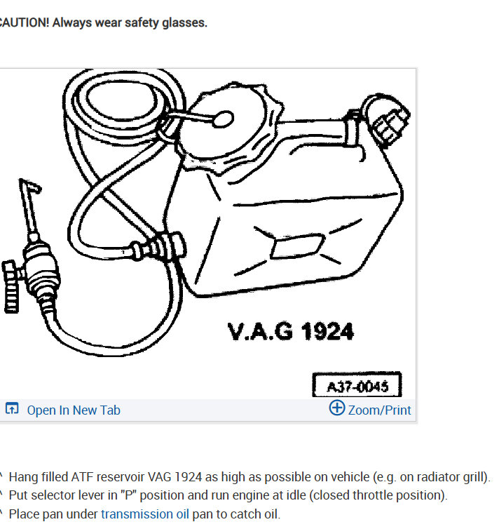

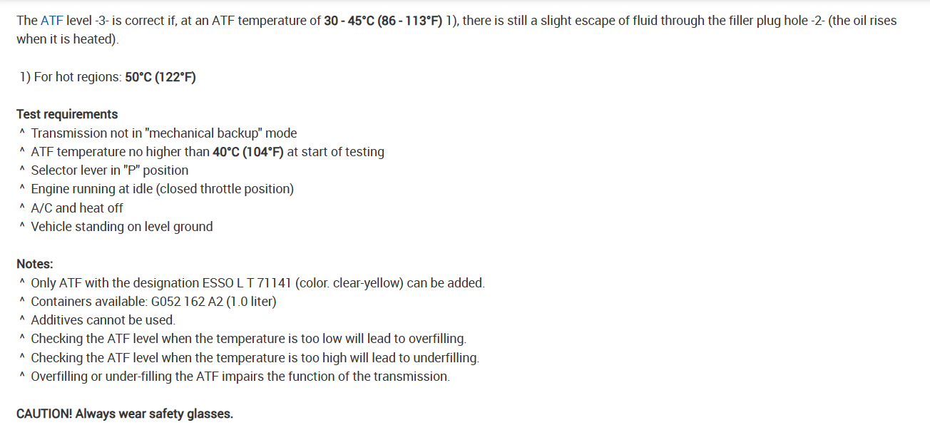

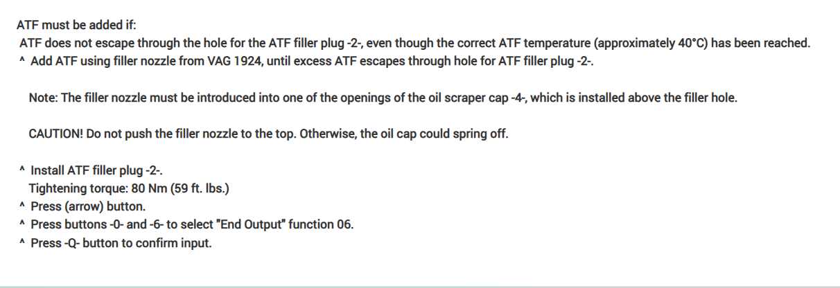

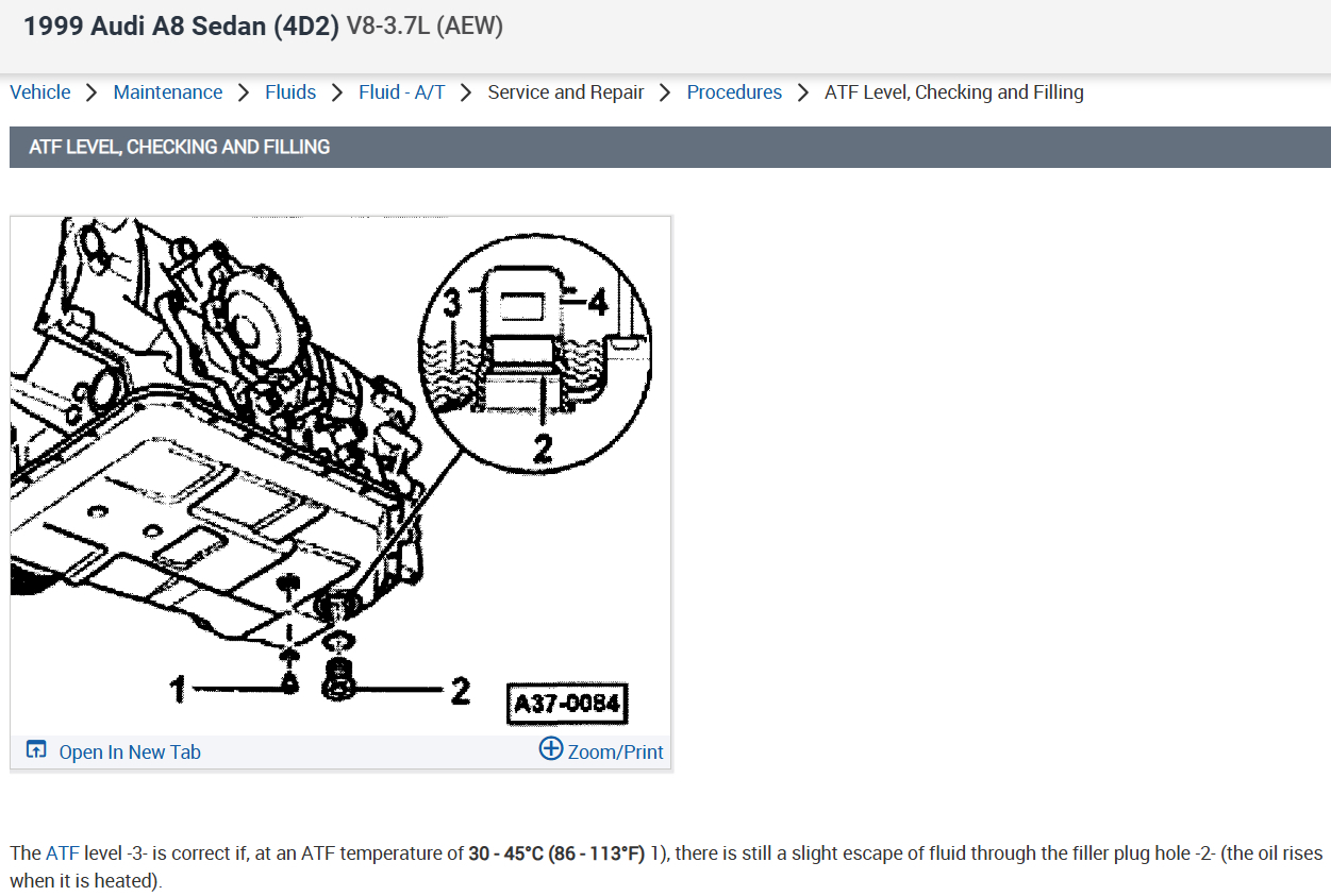

This an happens when the transmission fluid is worn out and needs to be changed along with the filter, here is a guide to help with the instruction for your car in the images below.
https://www.2carpros.com/articles/how-to-check-and-add-transmission-fluid
Fluid Types
Lubricant .................... ESSO LT 71141 (color. clear-yellow) Or equivalent
Note Lifetime filling.
Capacities
Capacities, Planetary gearbox
Automatic Transmission 01V
Initial Fill .................... 9.0L (9.5 Qt)
Fluid Change .................... Approx. 2.6L (2.75 Qt)
Caution
Additives cannot be added to the ATF.
Capacities, Final drive
Initial Fill .................... 0.75L (0.80 Qt)
Fluid Change .................... filled for life. No Change
Check out the images (below). Please upload pictures or videos in your response of any problems so we can see what to help you with.
