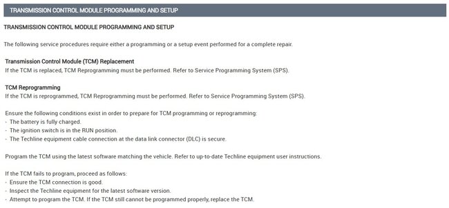

Hello, with these different problems, have you had the entire vehicle scanned for diagnostic trouble codes? The must be codes setting in either the PCM or TCM. And I don't mean just scanning the PCM with a basic OBD2 scan tool, you need a full system scan done. The TCM does need to programmed, if replaced, that requires a capable scan tool as well. But I would check for codes first and go from there. If there's an issue with the vehicles network and there is a communications issue between the PCM and TCM, you could have these types of issues as well. I'll post the service info on programming the TCM, but you don't want to replace that module and still have the same issues.

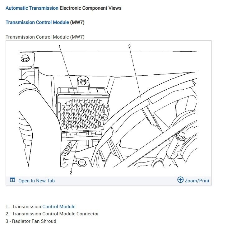

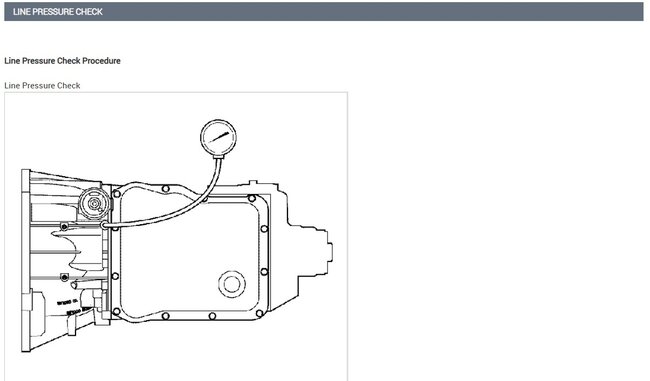

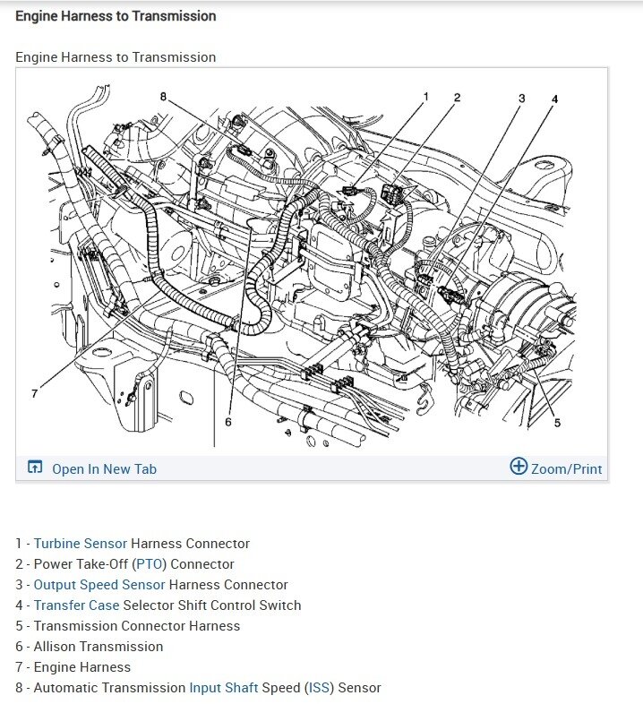

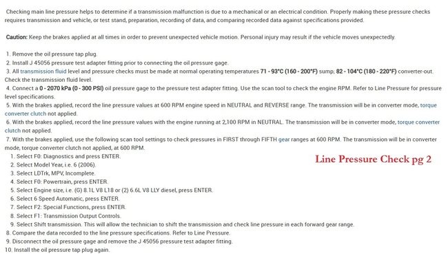

Diagrams 1 and 2 are for a transmission line test, which is something you should do to rule out a pressure issue with the pump inside the transmission, diagram 3 is the wiring harness to the transmission itself, diagram 4 is the TCM location and 5 is the module programming. But let us know what codes are stored in any modules first, that way we can look up the testing procedure for any specific codes.
Corrosion in any of the connectors will also cause faults like this, being a 2006 and if you live in an area where they use salt on the roads during the winter, you could definitely have connector issues or if connectors have been disconnected and reconnected a bunch of times, there could be pin fitment issues.
