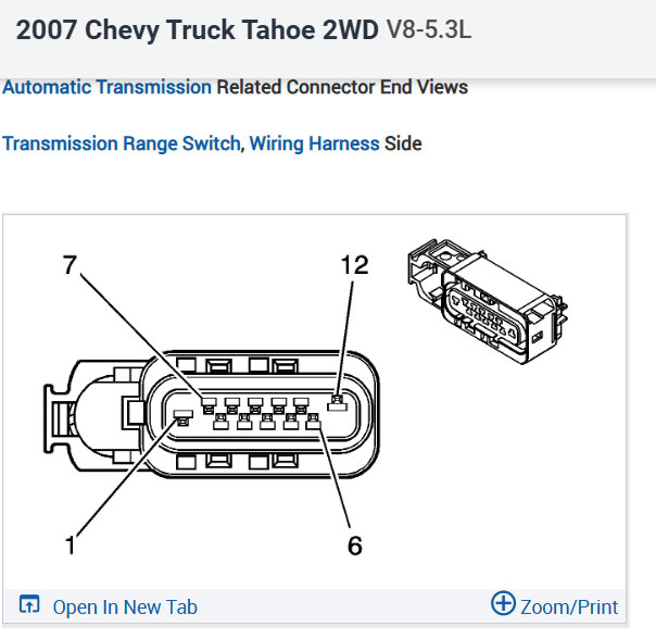

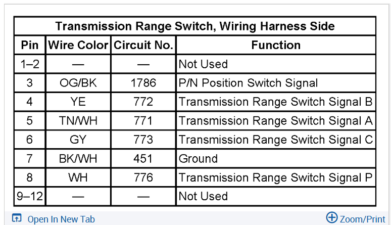

neutral safety switch connector?
2007 CHEVROLET TAHOE
123,456 MILES • 5.3L • V8
ALMATT
replace neutral safety switch connector need 6 wire diagram.
Jun 27, 2025 at 3:48 PM
  • 55,433 POSTS
Sure, here is the gear range sensor (neutral safety switch wiring pin outs and colors. Check out the images (below). Let us know if you need anything else.
