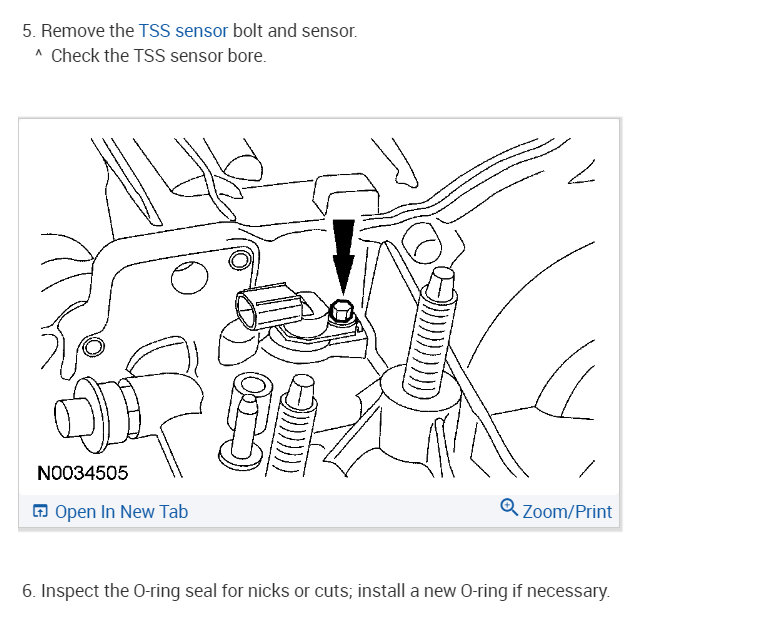

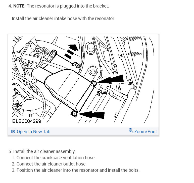

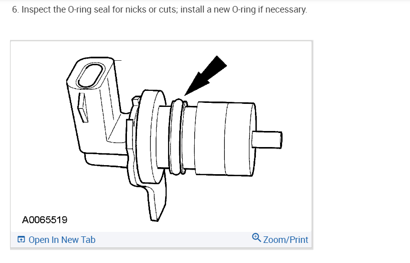

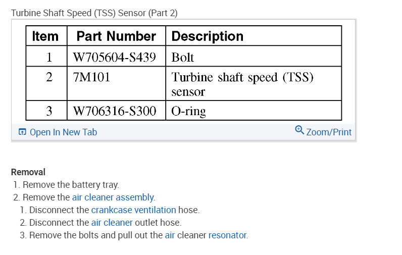

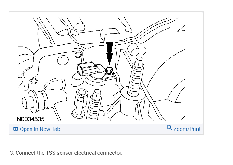

O/D off light flashing and is shifting harder won’t shift to 4th.
Aug 25, 2022 at 3:44 AM
Experienced Mechanic
55,732 POSTS
We need to run the codes because it sounds like you may have a clogged catalytic converter. you can get a code scanner from Amazon for about $20.00.
Here is a guide/video to show you how:
Here is a scanner link:
https://amzn.to/3Qi1SS6

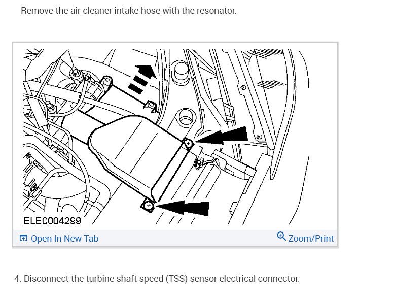

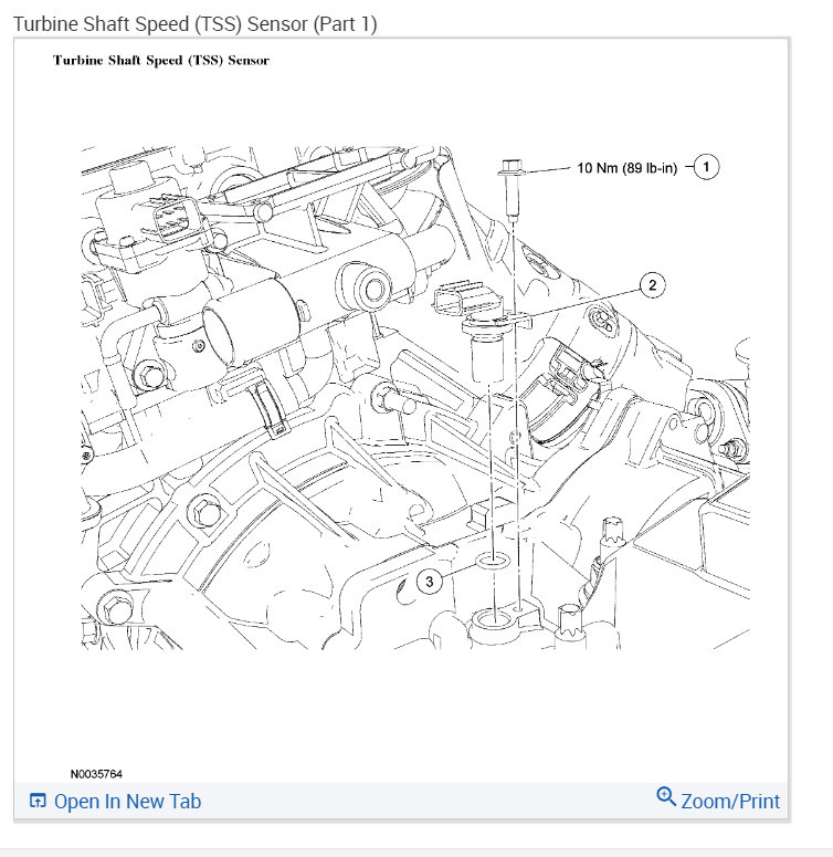

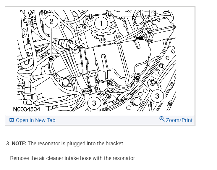

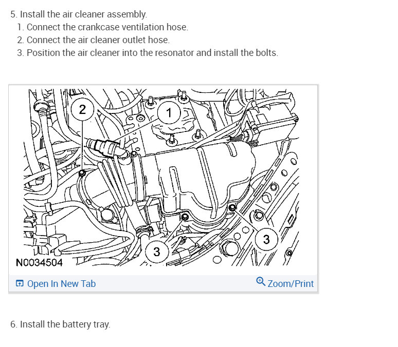

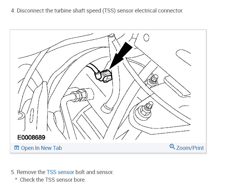

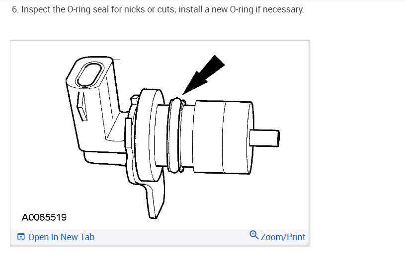

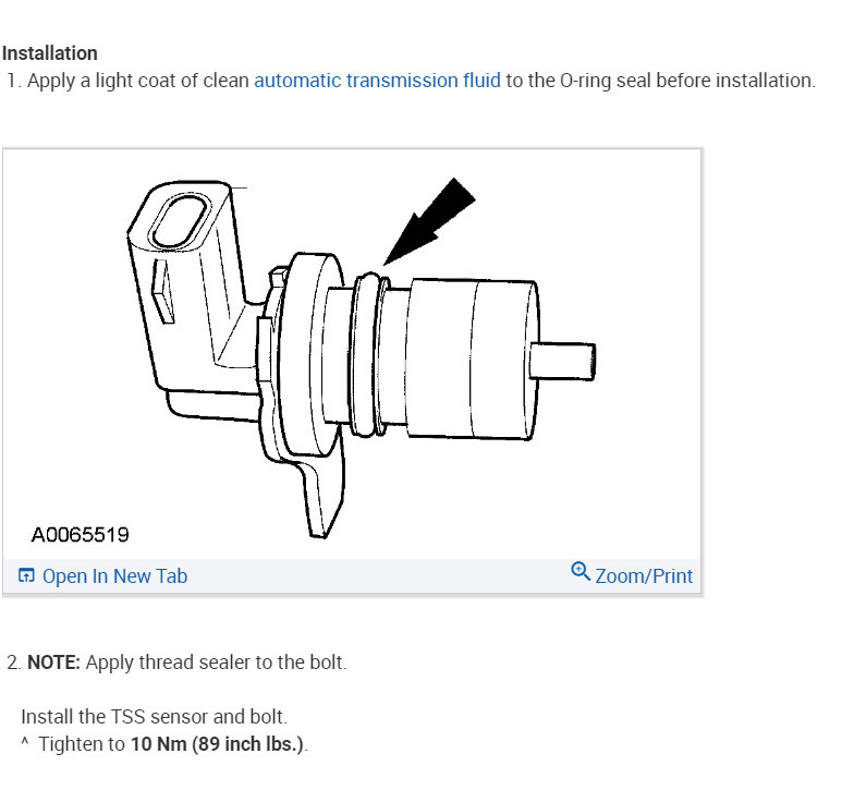

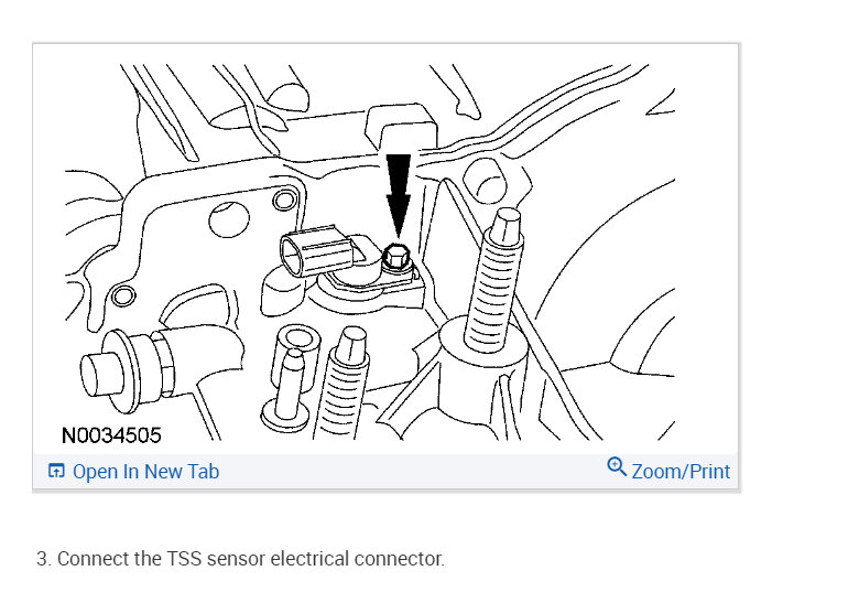

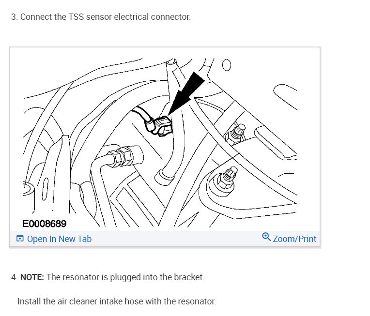

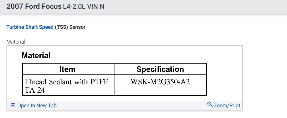

If no codes are present, I would try replacing the turbine shaft speed sensor. here is how the job is done in the images below.
Images (Click to enlarge)
