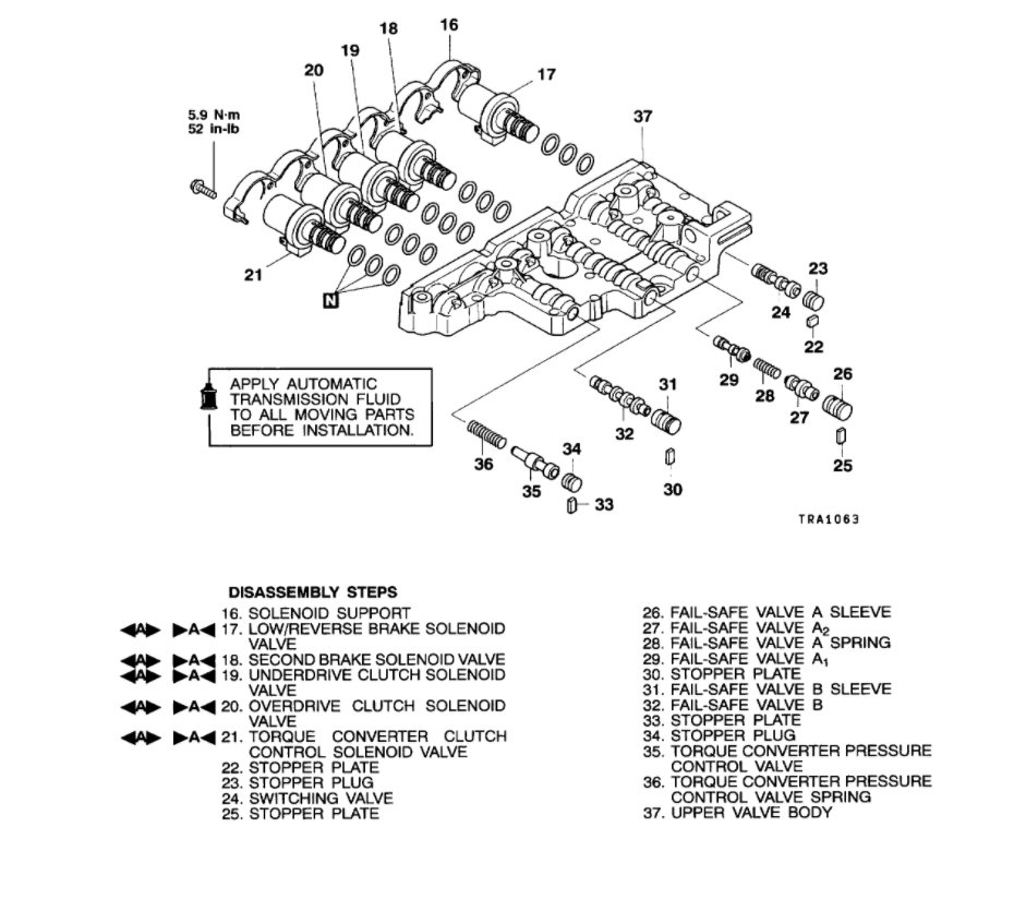

can't find TCC relay and where is the location of the solenoid?
Oct 18, 2019 at 6:42 PM
  • 55,604 POSTS

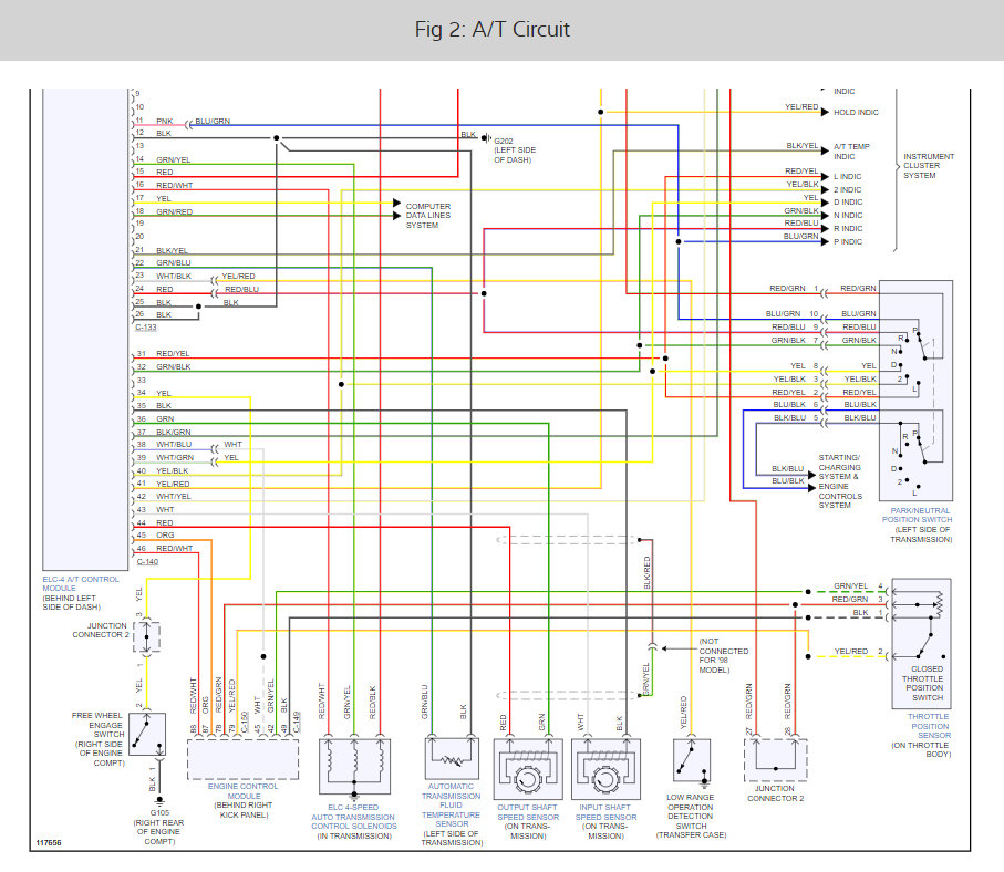

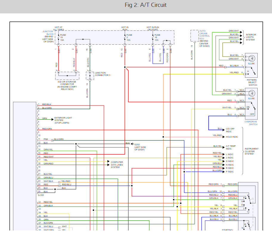

Here is the transmission clutch control solenoid location with the transmission wiring diagrams so you can see how the system works. Check out the diagrams (below). Let us know what happens and please upload pictures or videos of the problem.
