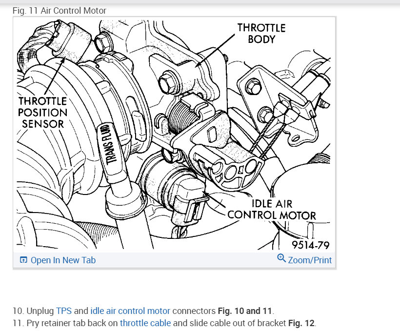

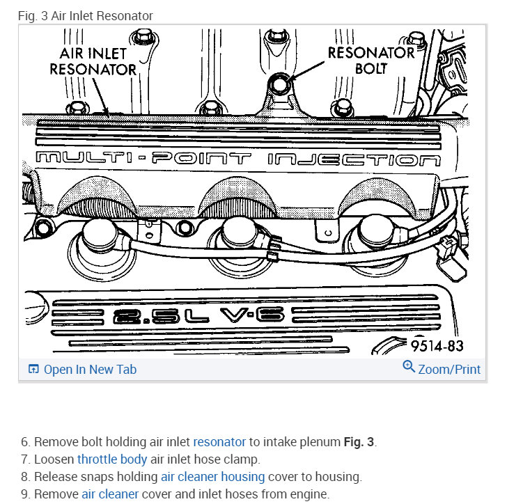

I pulled a code by clicking the ignition three times it flashes p1266, what is that?
Sep 17, 2022 at 8:19 PM
  • 55,684 POSTS

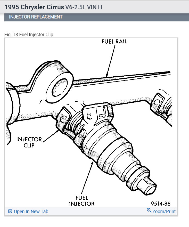

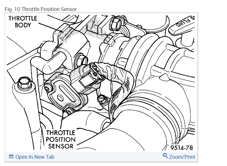

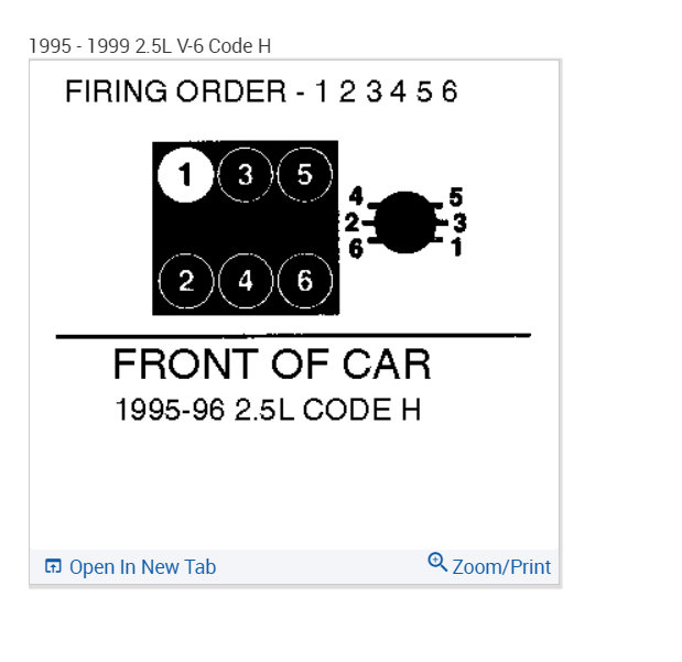

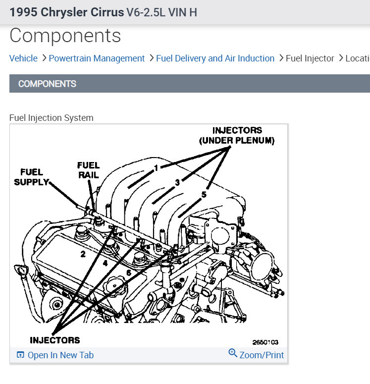

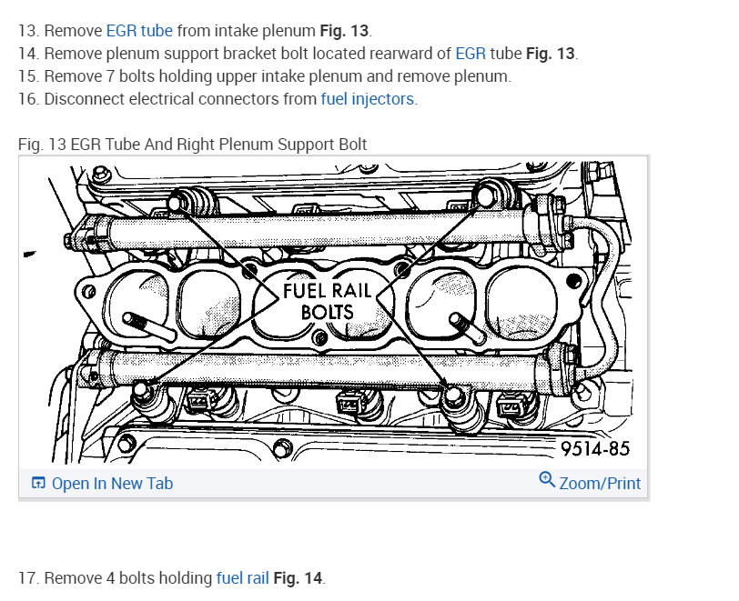

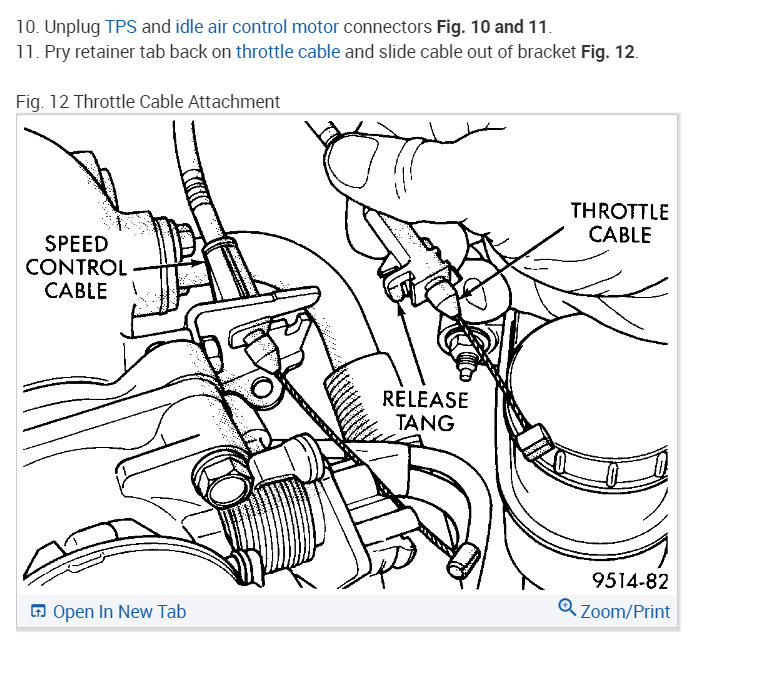

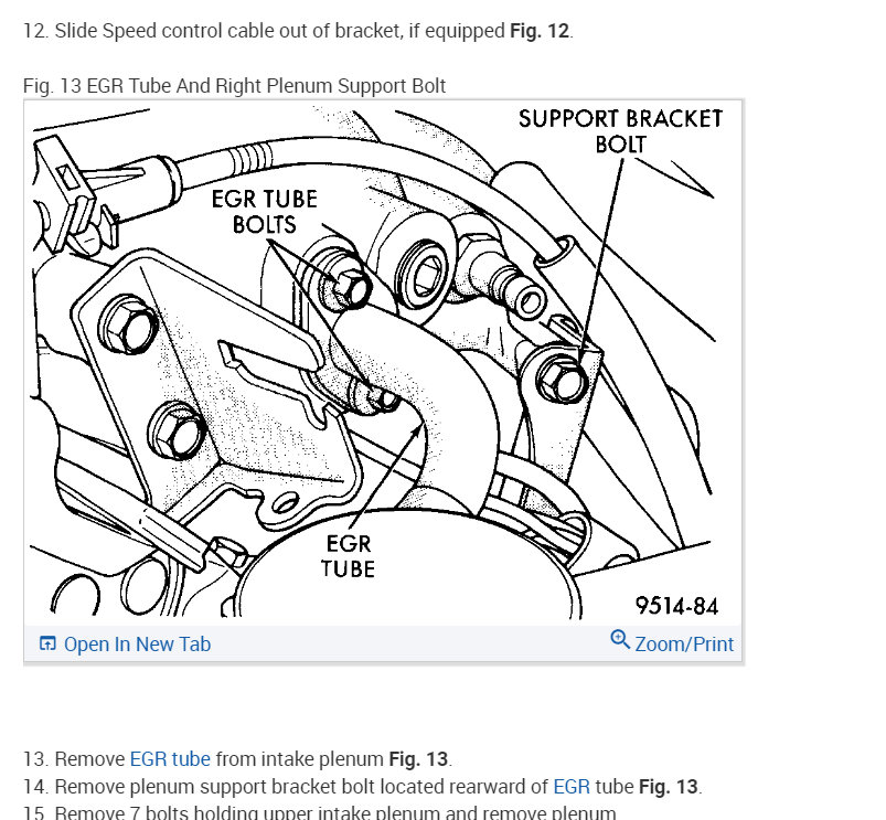

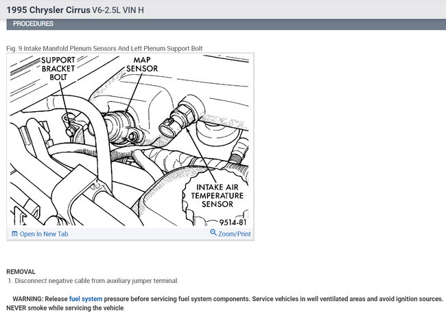

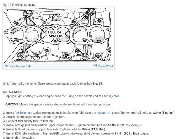

This code P1266 Faulty Fuel Injector #6, here is how you can replace it and fix the problem. I have included the firing order so you can see which injector #6 is. Check out the images (below). Let us know what happens and please upload pictures or videos of the problem.
