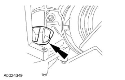

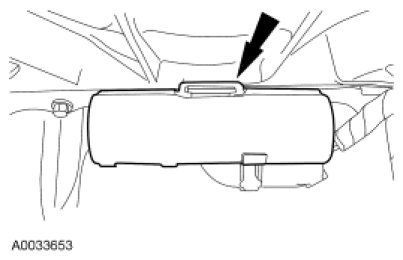

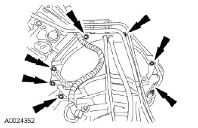

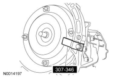

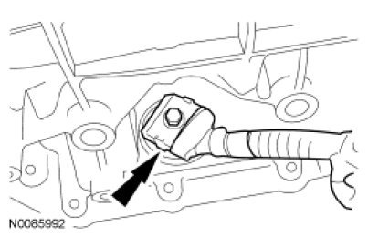

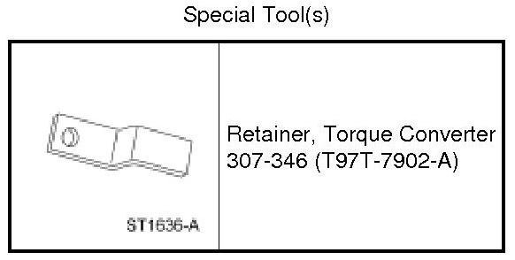

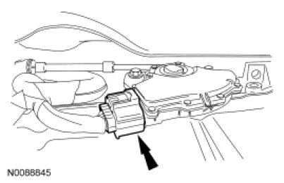

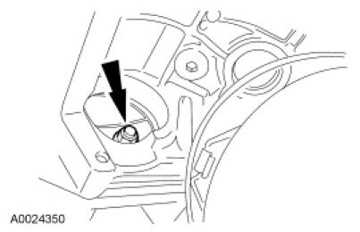

I don't know if you need them, but here are directions for the removal and replacement of the transmission. The attached pics correlate with the directions.
____________________________________
2010 Ford Mustang V6-4.0L
Transmission Removal
Vehicle Transmission and Drivetrain Automatic Transmission/Transaxle Service and Repair Removal and Replacement 5R55S Transmission Removal
TRANSMISSION REMOVAL
Transmission
pic 1
All vehicles
NOTE: When the battery has been disconnected and reconnected, some abnormal drive symptoms can occur while the vehicle relearns its adaptive strategy. The customer needs to be notified that they can experience slightly different upshifts (either soft or firm) and that this is a temporary condition and will eventually return to normal operating condition.
NOTE: If transmission disassembly or installation of a new transmission is necessary, drain the transmission fluid. Install the transmission fluid pan drain plug when finished.
NOTE: If the transmission is to be removed for an extended period of time, support the engine with a safety stand and a wood block.
1. With the vehicle in NEUTRAL, position it on a hoist. For additional information, refer to Vehicle Jacking and Lifting.

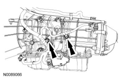

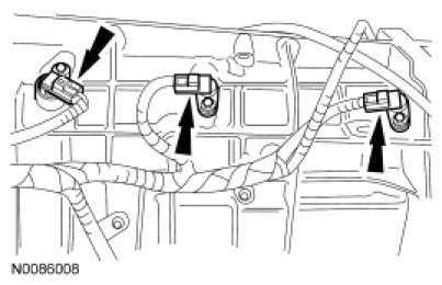

5. Remove the Heated Oxygen Sensor (HO2S) connector from the front of the transmission fluid pan rail.
pic 2

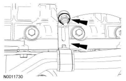

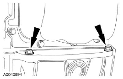

7. Remove the selector lever cable from the transmission manual control lever.
pic 3

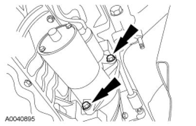

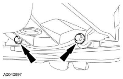

8. Remove the 2 transmission selector lever cable bracket bolts from the transmission and remove the bracket.
pic 4

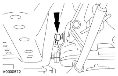

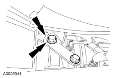

9. Remove the starter. For additional information, refer to Starting System.
10. Remove the flexplate cover.
pic 5

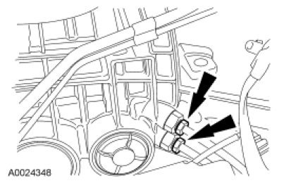

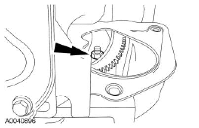

11. Remove the access cover.
pic 6

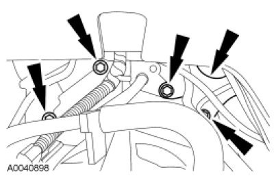

4.0L engine
13. Remove the starter and position aside.
pic 8
14. NOTICE: Rotating the crankshaft pulley bolt counterclockwise could cause a reduction in clamp load on the crankshaft pulley and timing sprocket, which could cause severe engine damage.
Remove and discard the 4 torque converter nuts.
pic 9

19. Disconnect the Transmission Range (TR) sensor connector.

Remove the screw from the transmission vehicle harness connector and disconnect the connector.

23. Remove the 7 engine-to-transmission retaining bolts.
pic 17

26. Install the Torque Converter Retainer.
