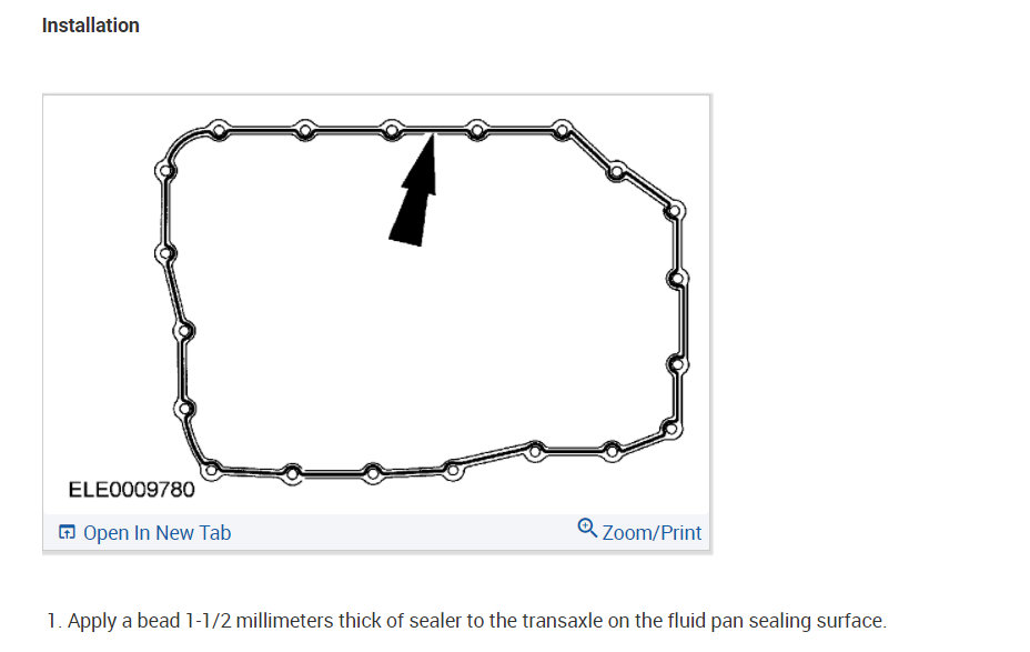

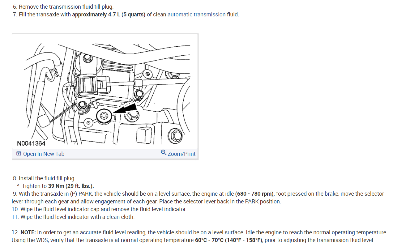

I just got the car. Transmission is really jumpy and you really need to step on it but if you do the RPMs skyrocket.

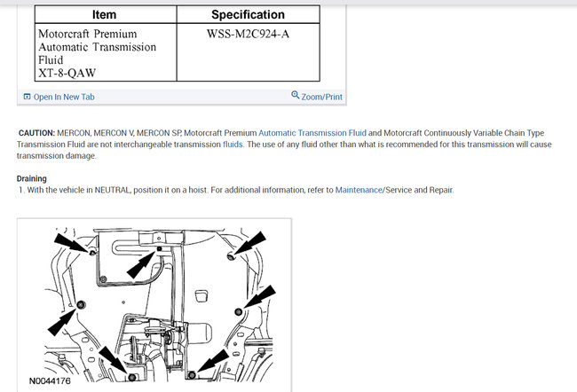

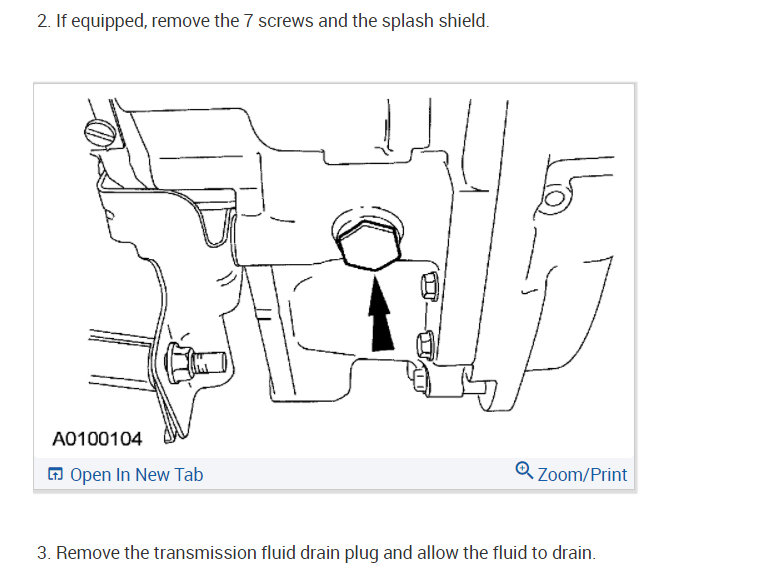

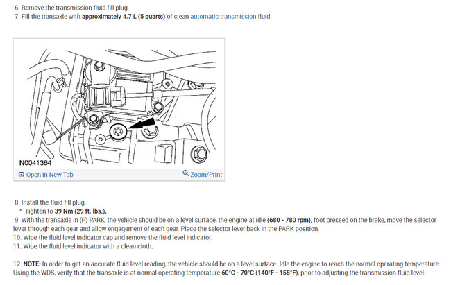

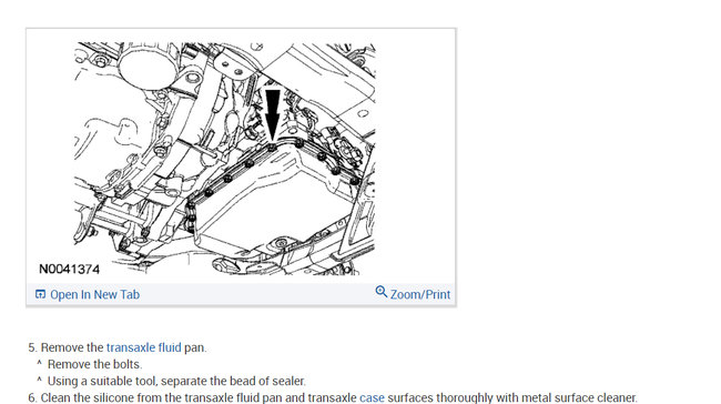

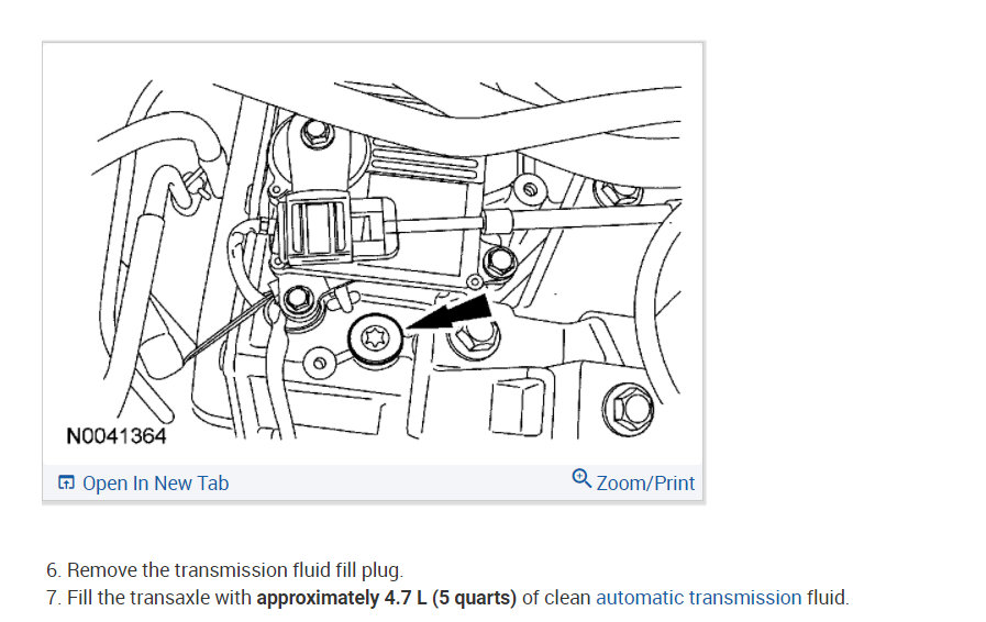

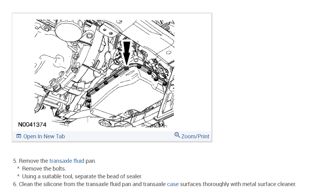

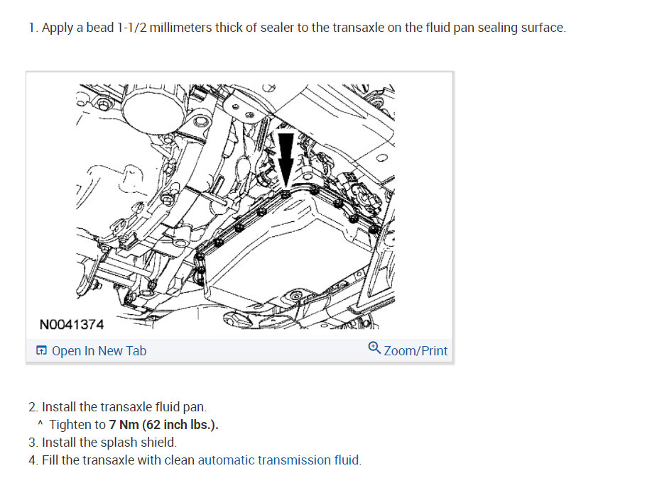

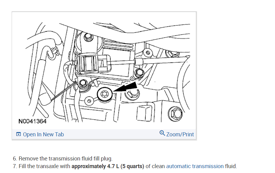

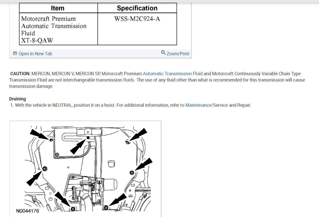

This sounds like it is slipping internally or not shifting.
I would start by changing the fluid and the filter and see if it improves. It could be either low in fluid or the filter itself is clogged.
If it is an electronic issue, it will store a code. Is the check engine light on?
I attached pictures of the procedure below for the fluid and the filter. Let us know if you have any other questions.
