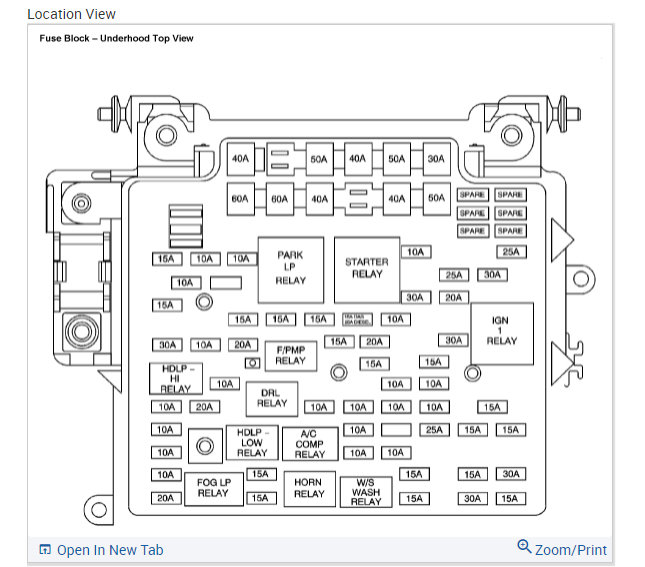

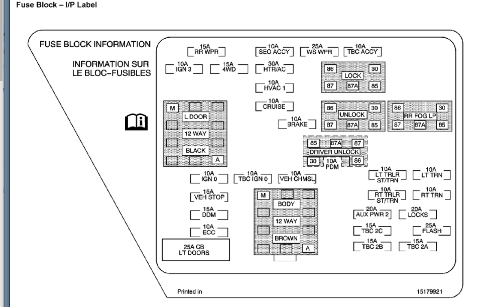

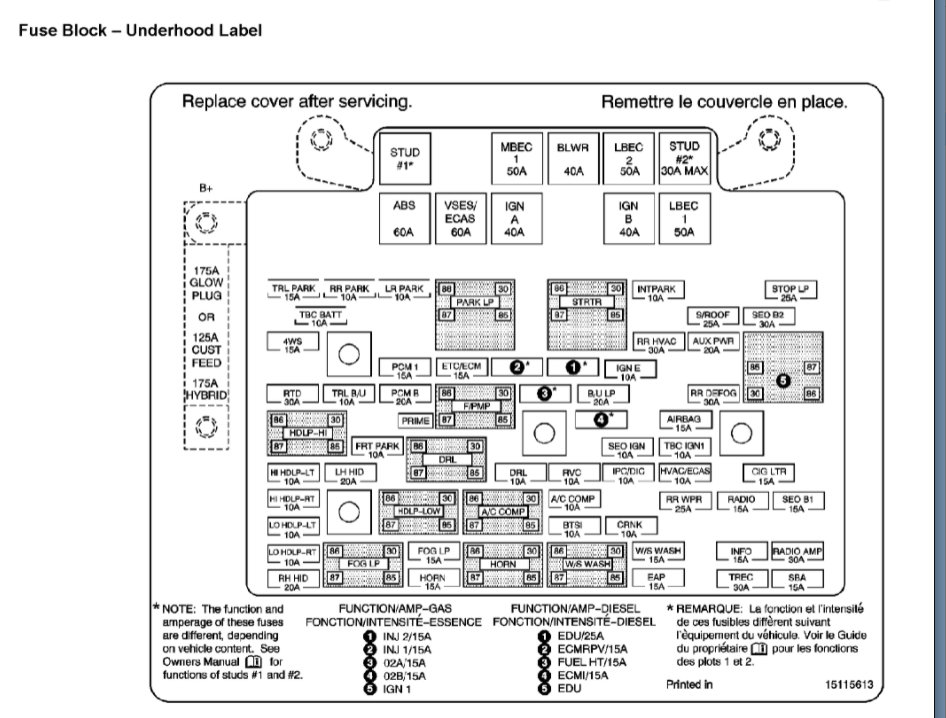

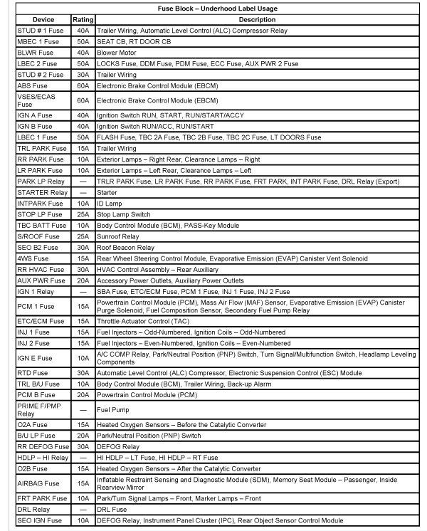

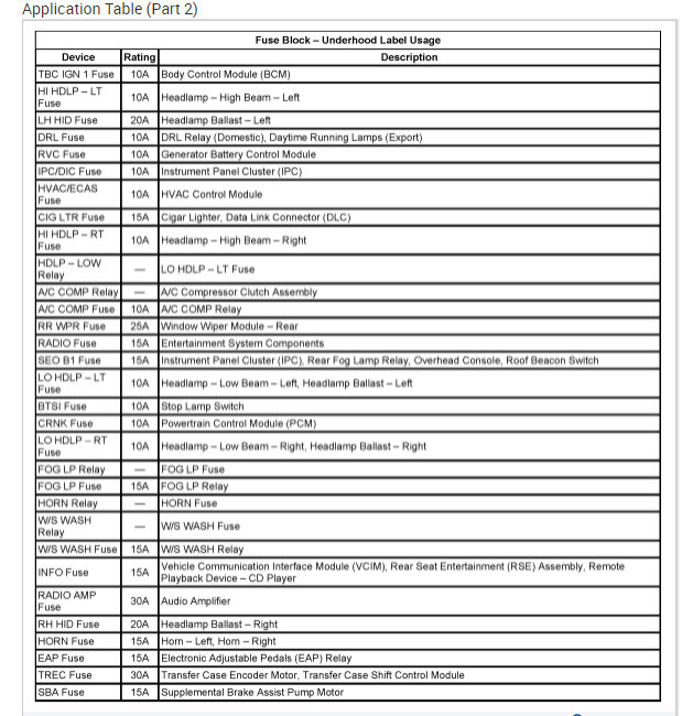

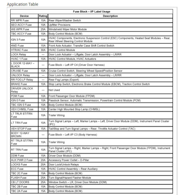

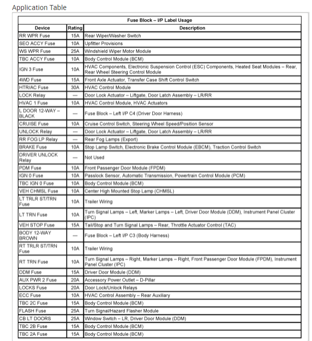

The transmission is not shifting? I have to check the fuses where are they can you help me test them please?
Oct 2, 2016 at 10:30 AM
Experienced Mechanic
18,907 POSTS
Here is a guide that will help with testing and replacing fuses:
Below you will find the info from the service manual on these fuses. Please run through this material and let us know if you have other questions. Thanks
