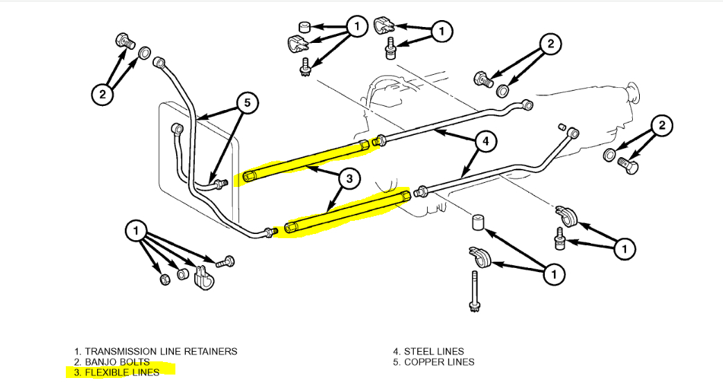

It sounds like you may be leaking transmission fluid. Since it won't shift, that is my first suspect.
Is the fluid leaking reddish in color? If it is, don't drive it until we find and repair the leak. This will cause damage to the transmission if it is too low.
The transmission cooler lines run between the transmission and the radiator. The lines are made of both metal and rubber. I attached a pic below and highlighted the rubber lines. These are the most likely to fail.
Open the hood and look down at the radiator between the engine fan and radiator to locate the cooler lines. Follow those to see if there is a leak at any point.
Let me know what you find.
See pic below.

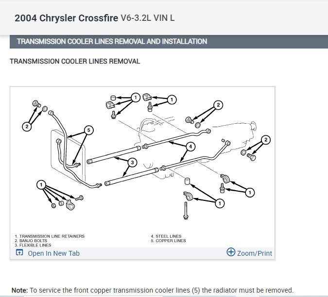

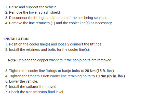

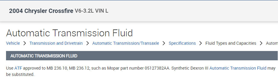

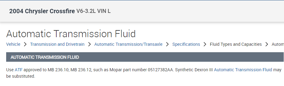

It sounds like transmission fluid. I attached directions below for removing and replacing the lines related. The last pic indicates the type of fluid you need to refill it.
