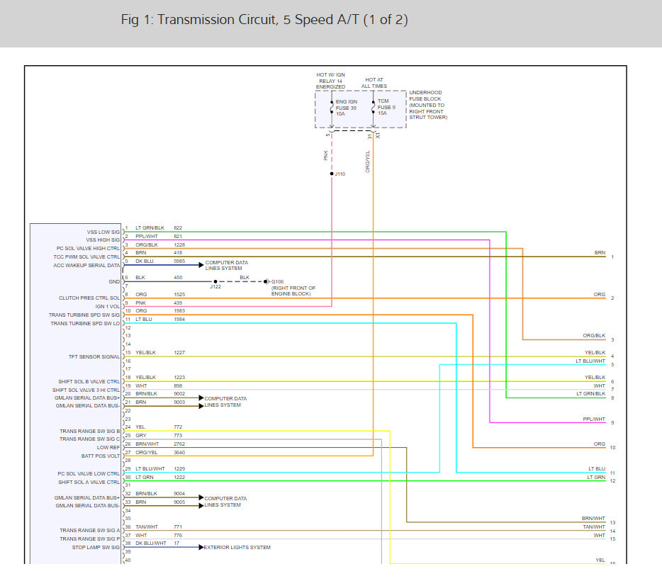

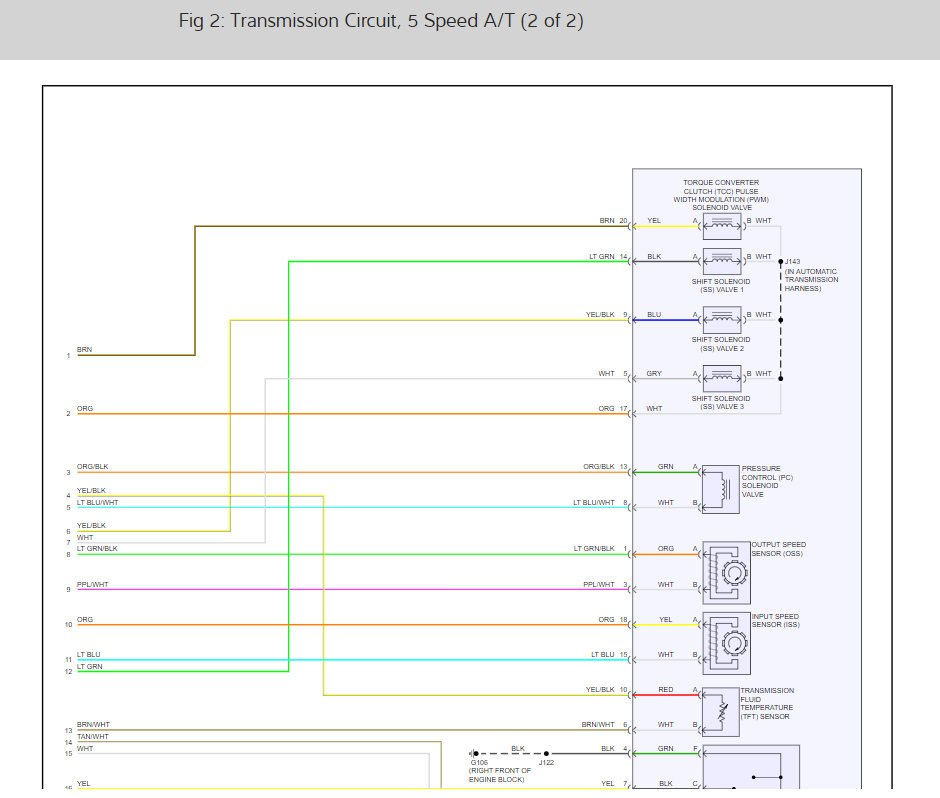

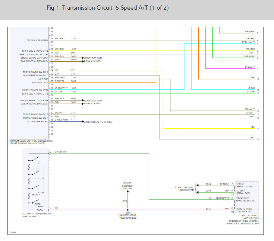

Hi.. I'm having trouble with my transmission. I put in drive but it won't go.. but reverse, third ,and low gear work perfectly. I drive it like manually shifting it from low to third, then back into drive for over drive.. I changed out both shifting solenoid and the checked the output speed sensor.. changed transmission oil nothing.. just throwing parts at it..
Aug 5, 2019 at 5:19 AM
  • 55,740 POSTS

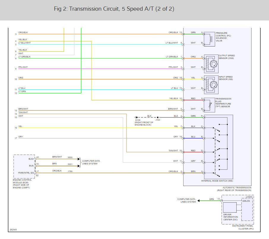

Lets see if the shift valve one (light green wire) is getting a signal and if so the transmission is bad and needs to be replaced. Here is a guide to help you test the wire for 12 volts and the wiring diagrams for the transmission below so you can see how the system works. Can I ask if all the gear selector lights are working? If it does not get a signal the PCM is bad.
Check out the diagrams (below). Please let us know what you find.

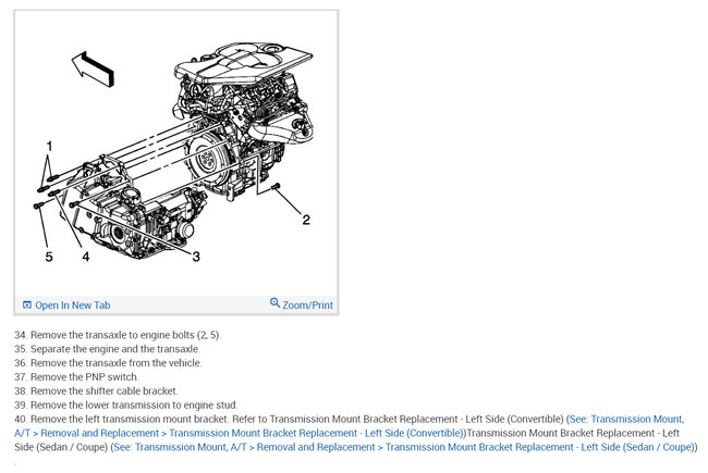

I got it diagnosed.. no transmission codes.. just a EVAP code came up..
Aug 6, 2019 at 7:53 AM
  • 55,740 POSTS

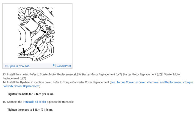

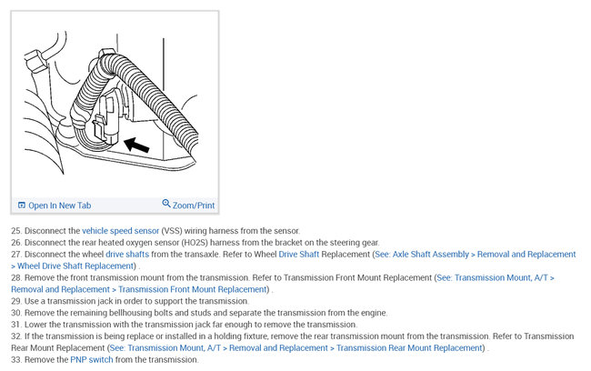

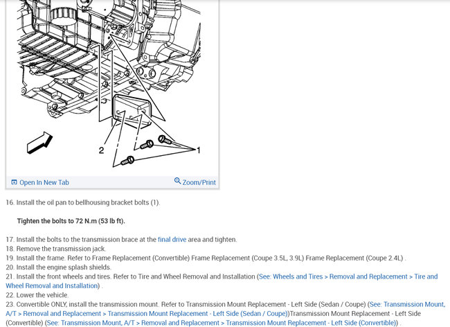

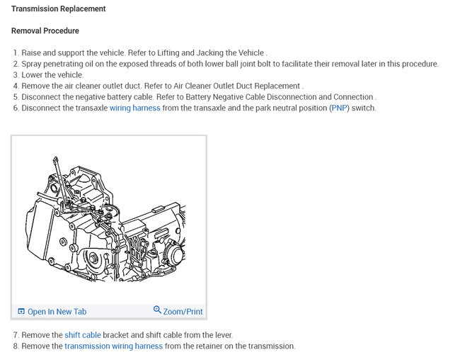

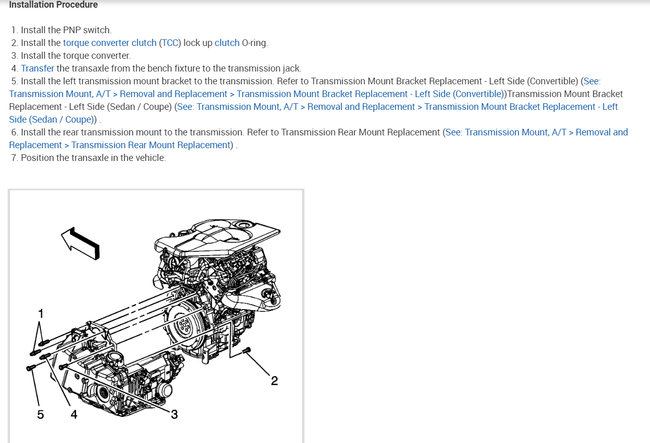

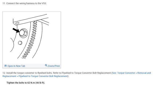

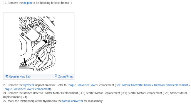

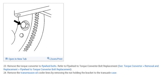

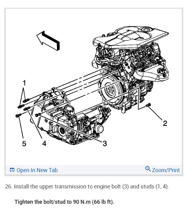

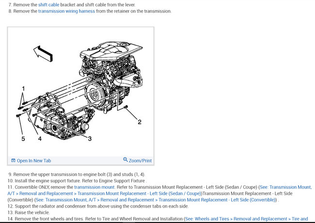

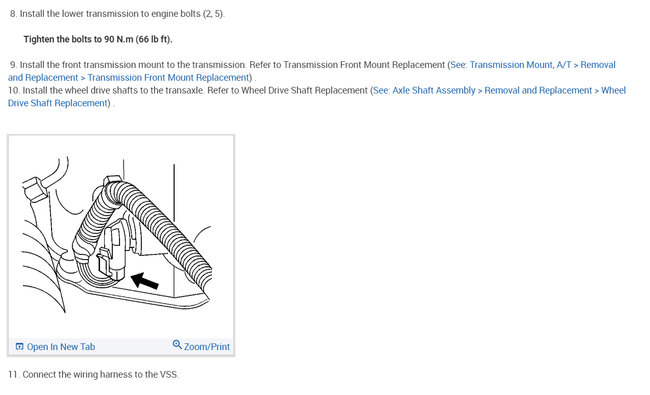

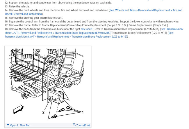

It sounds like the transmission has had an internal failure. I have included the steps for your cars transmission removal in the diagrams below. This video show a rear wheel drive transmission replaced which can show you many things that pertain to the job.
https://youtu.be/3vJAojsrfuU
